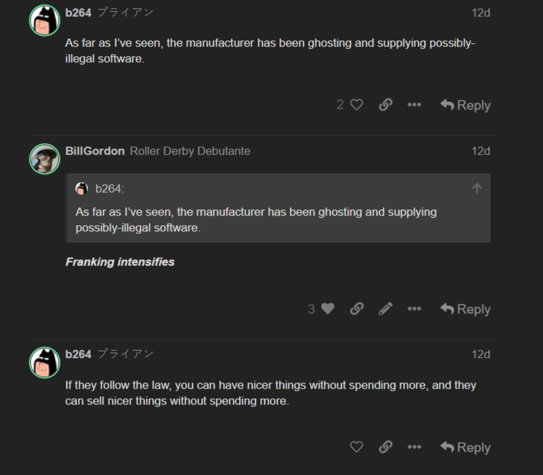

Where is the source code for your modified firmware 5.1?
This is not optional, it’s a requirement.
Selling hardware that is dangerous running on stock firmware while not even providing the source code to document your changes is negligent.
I’ve looked, am I missing something?
I think it’s beyond negligent, it’s probably illegal, being against copyright law.
This also means that reselling these products would also be illegal.

I have PMed him. We have a line of communication open because I was planning to do a uBox review, which is on hold until he’s compliant.
I will learn from this.
He will reply if the money stops flowing.
In the meantime, you have items that cannot legally be resold, aren’t even legal for Spintend to sell, support cannot be added to anything, and issues cannot be rectified if everything doesn’t work 100%.
Also futures updates and feature additions are all but impossible.
