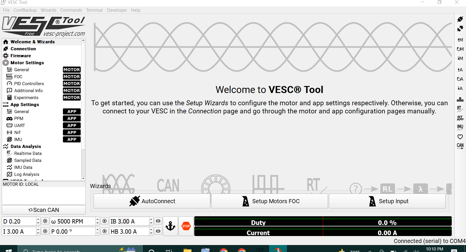

nope just unhooked CAN and maybe power in the middle of setting them up in Vtool. After that CAN bus broken on the V1 unit.
To add more detail I can connect to the V2 unit, and it shows both sides on the CAN bus until I plug in the V1 UBOX CAN then the V2 unit can not see either side.
leading me to think there is a problem with the CAN on the V1 from whatever I did.

Yeah my UBOX V1 seems to be stuck with no CAN bus function.
Try a hard wire connection?

What fw version are you using? 5.1, 5.2?
5.2 for a while now
Proprietary/custom firmware from spintend directly or built into the vesc tool already?
Custom from Spintend for the ubox v1. Same FW I’ve been running for a few hundred miles.
Haven’t had a reason to switch to 5.3…
