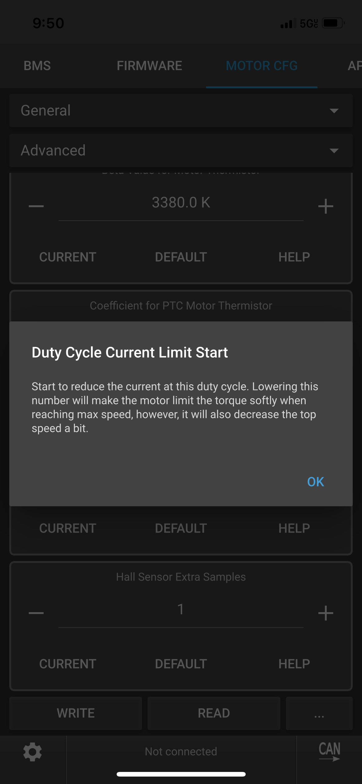

Will do. I’m curious what the setting specifically changes
Click the question mark in vesc tool. It says it.
So it’s the start point of when current is decreased so you don’t hit max duty cycle which can cause a drop out. Back in 5.1 maybe I think is when folks started noticing the issue and we’ve all been manually changing it. 5.3 defaults it if you pick eskate as the setup.

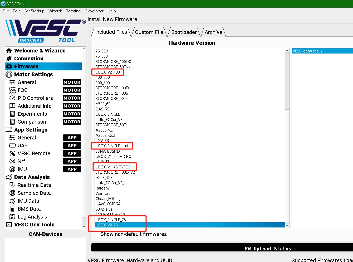

Back to topic, I have been testing several Ubox and their is no reason to worry about the problem with smoked unit if you don’t mess with the firmware. After testing alot of units the problem with burned unit are that users are installing 5.3 firmware from vesc tool. Ofc you can argue that wrong firmware should not burn the unit but that’s just a risk how its working atm.
Keep the 5.2 or use the firmware from spintends website. I have not burned any single unit with custom 5.3 or the 5.2 they was shipped with.
But for 6.0 firmware you don’t need to worry about it anymore , the correct firmware will be in vesc tool with that:
Another thing, if you get the message in vesc tool that you can’t do remote setup because one vesc have wrong firmware. Just reset app settings and it will solve it.
Mine shipped with 5.3 out of the box iirc, has been working fine even with multiple detections and such to make sure.
Huh…ive had 4 units go up in smoke an the last one the CAN rand9mly stopped working on 5.2. And then i flashed FW to spintend custom 5.3FW and it resolved the issue so…dont think the FW issue is as simple as “5.3 bad, 5.2 good”
I think it’s more like “5.3 bad, Spintend’s 5.3 good”
But I’m still running 5.2 on mine until there’s a good reason to switch…
Yes correct
Yeah this makes sense to me - their blog is pretty clear to only use their firmware, but it would be really easy for a person to accidentally upgrade to generic 5.3 when plugging in as i believe the user gets prompted to do so if theyre on 5.2 with vesc tool 3.01 - accepting that results in generic 5.3 firmware, which means poof.
