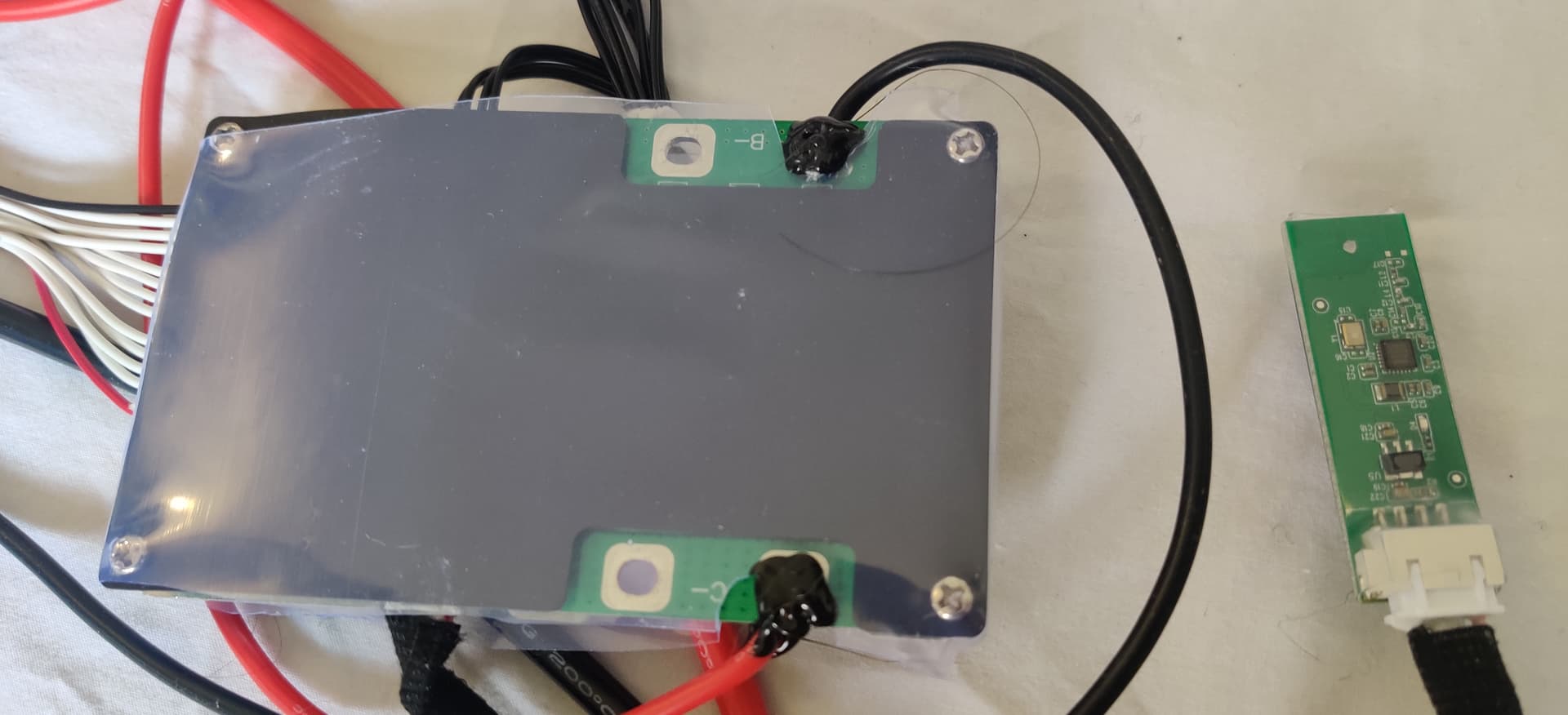

BMS:
Pictures

I know it has to be there because of other photos, but I just can’t find where the balance lead is connected here lmao

So I’ve now drained the pack a couple times and charged it up.
@SBS has the LLT set to stop charging at 4.1V/cell which I agree is the way a new pack should come, using conservative values to ensure pack longevity.
I was informed of the proper low voltage cutoffs to use as well. It’s important to get that information in DIY.
The pack has shown to be balanced over 3 full cycles so far. I’m hitting it with 140A max (70A per VESC) and it’s been performing exactly as expected, not even getting warm.
I’ve been using a 6A WATE charger.
