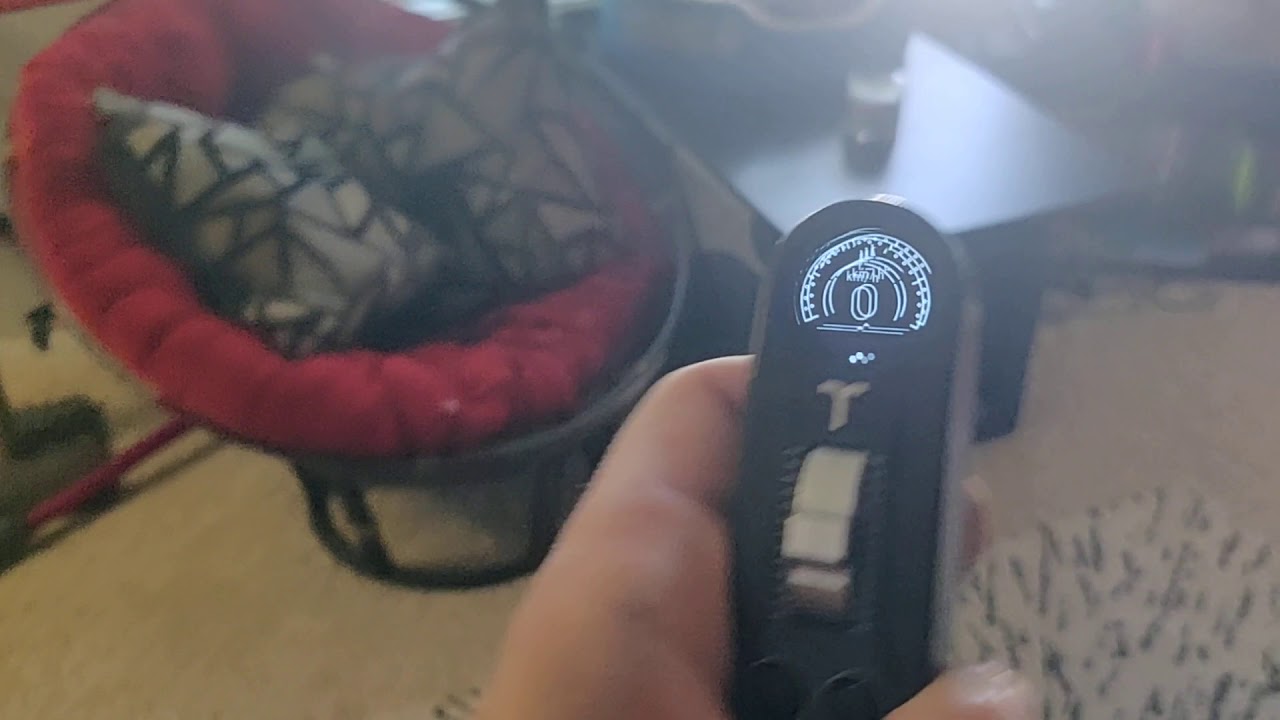

This is valid. Here’s a video of my testing, my setup is a bit custom so your mileage may vary. Regardless it demonstrates the negative impact of the metal case around the antenna.

And I agree this will be a factor, it’s just basic RF theory. Maybe it doesn’t have tangible impact at the expected user range, but not a design choice I could justify myself.
For posterity, what’s custom about your setup? I’ve got a Trampa nrf dongle here to test on.
What material is the back plate of the casing made from?
Receiver module is SKB501 instead of the BMD-340 one used by Trampa. Same chipset (nrf52840) but I’m sure the antenna quality is different, planning to test a few different modules to see how this factors in.
The backplate is made of some form of fiberglass, non conductive so has decent RF-transparency.
so the signal could be stronger or weaker depending on how you hold it, correct?
36gukp
Yes orientation dependent. In my opinion always expecting a user to hold remote a certain orientation with respect to the board is silly, so you need to consider the worst case orientation.
