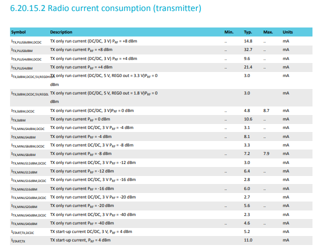

For the NRF52840 module reducing transmit power does not drastically improve the consumption. You get some savings but nothing incredible. The best way to save power is to reduce packet size, then the radio is put to sleep any time it isn’t used and so it’s only pulling current relatively infrequently.
15 mA vs. 10 mA for 8 dBm less is pretty terrible, considering it’s like 1/6th the transmit power.
My guess is they burn the most battery through the OLED.
