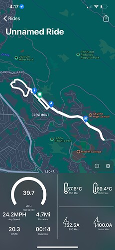

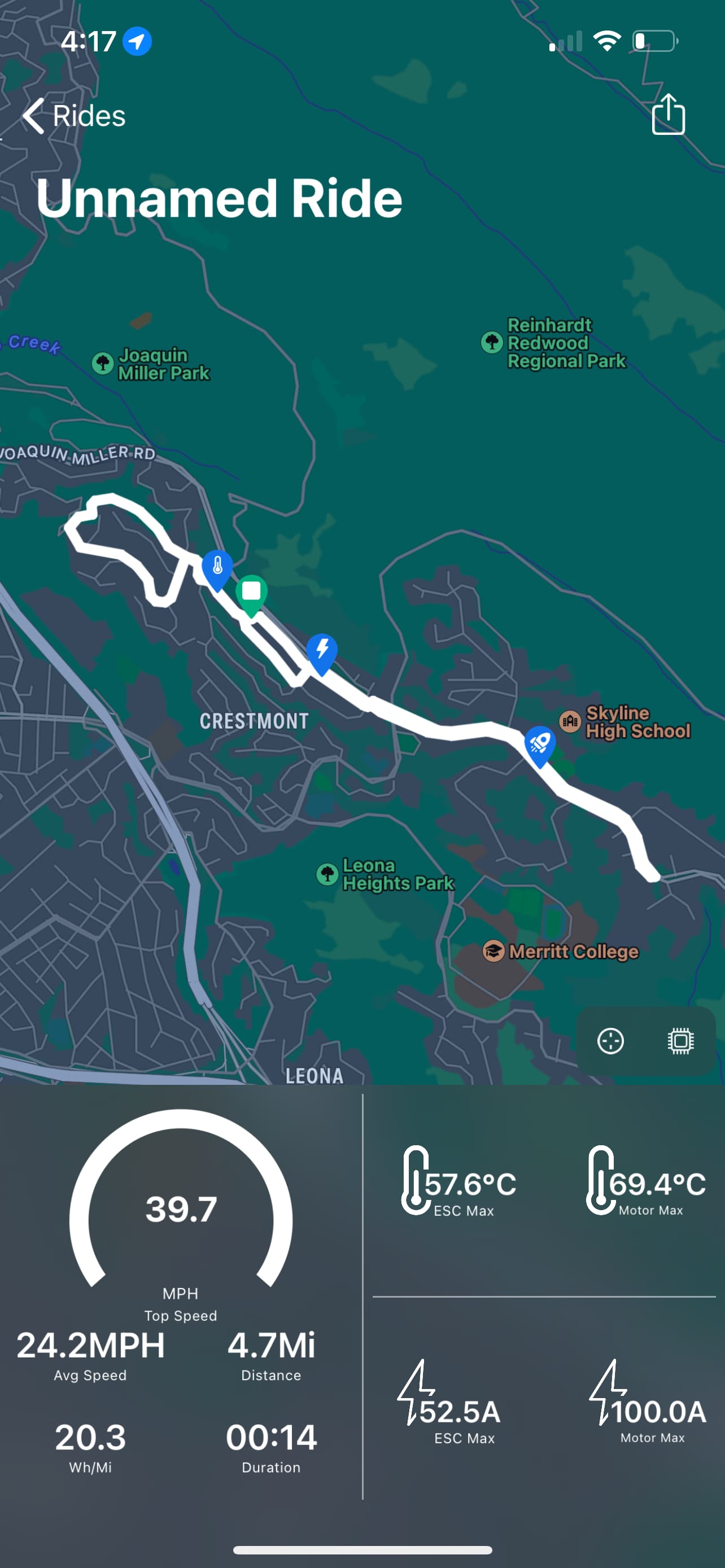

Testing going amazing.
I am going to change the angle so they are a bit higher of the ground
Efficiency is best I’ve ever had lol. But I am usualy on 8” rubber. 20w/mile! About 20 miles total of testing so far. These are an amazing ride. I really like the gearing/KV combo too, it lets you get real playful with the throttle
14s
173kv 2.6 gearing ratio
100amps motor
50 amps battery
Pretty quick set up :rocket::rocket::zap::zap:
Topped out at 40 but was on last 20% charge at that point. It will probably do 45-47mph loaded on full charge. Will make a video tommo.

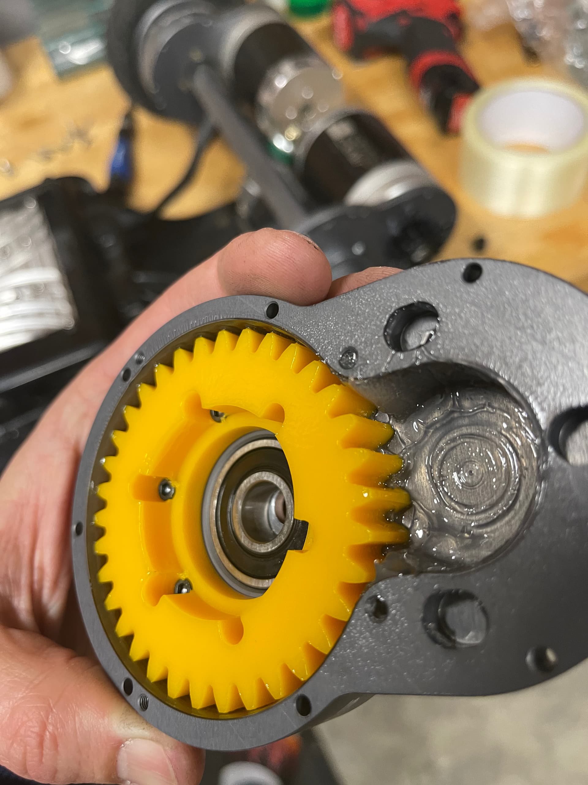

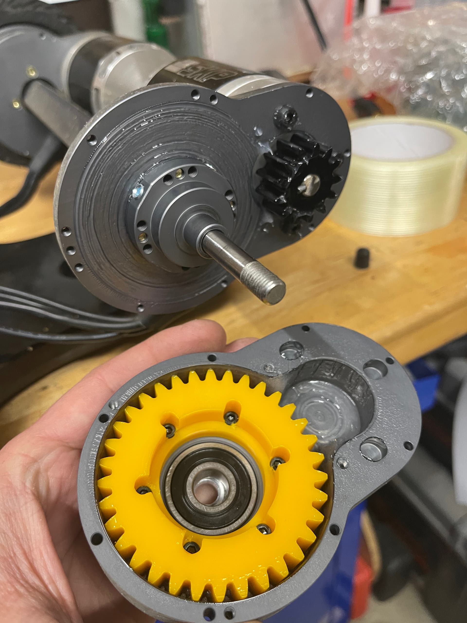

Rode through some pretty dusty places today as you can see from my GDs
The bumper isn’t quite ready yet, so we are just going to abuse these to see what they can take. Hoping to put 10-20 miles daily untill something breaks.
Iniatial inspeaction after 20 miles
Not a spec of dust on the inside

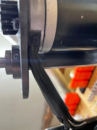

Here is a tip this will work for some motors and some GDs
Add a bit of silicone to the motor wire exists, will help with dust ingress of GDs with similar construction

So are the part used all metal ( inside) or pom?
I ask this because on his website some drives make use of pom.
Why use pom unless you want it to be lighter compared to steel/ aluminum
3Ds drives are something else
I don’t believe it’s Pom but is some plastic
The advantage of plastic is a couple things
  1. quieter
  2. metal shavings don’t get into grease and stay there
  3. you can’t jam up
There are some others but gotta think of them
Also 3Ds drives are insane
I mean they just don’t break
People always complain about value and they are is expensive but I have had many drives of all sorts and all have needed maintenance every couple weeks
That’s except for 3Ds where I have had 2 boards with their drives and genuinely never touched anything
Opened one up around 1000 miles later and they were still well greased and in perfect condition
I have one daily ever with them and that was me destroying them while changing a motor
Even then 3Ds helped me out and custom machines a spare part for me and had it delivered to my house within a week
It really just annoys me when people bash good vendors who sell premium products and then complain about it
3Ds are making the best drives on the market and selling them to people who want the best and the newest
Not Pom, forgot what it is, but it’s much stronger than Pom.
Oil-filled nylon.
And yeah, as much as I think other vendors are better at communication / support / price, most of my newer boards use 3ds drives because they’re easy to assemble and sound awesome. They’ve also gone through many design generations, which gives me confidence in their reliability.
