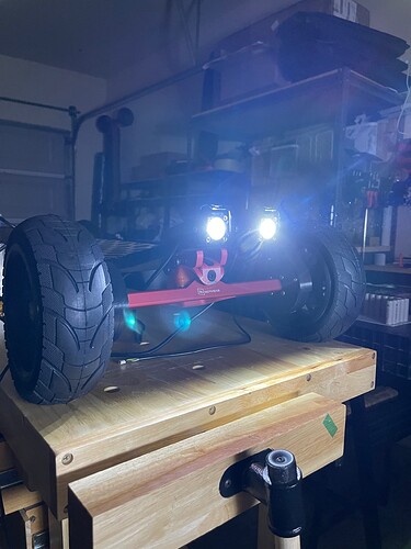

Rear is at 0 or near 0 on red shockblocks, I think I’m going to try and change it to like 10 degrees front is at like 15
what lights are those? they look nice
Some sort of Alibaba, il try to find the link
High beams/low beams
How did you attach them to the board? they look awsome!
If you’re at 0, why not try softer bushings so you still get a bit of lean? It’ll help you turn while still keeping the rear locked out
