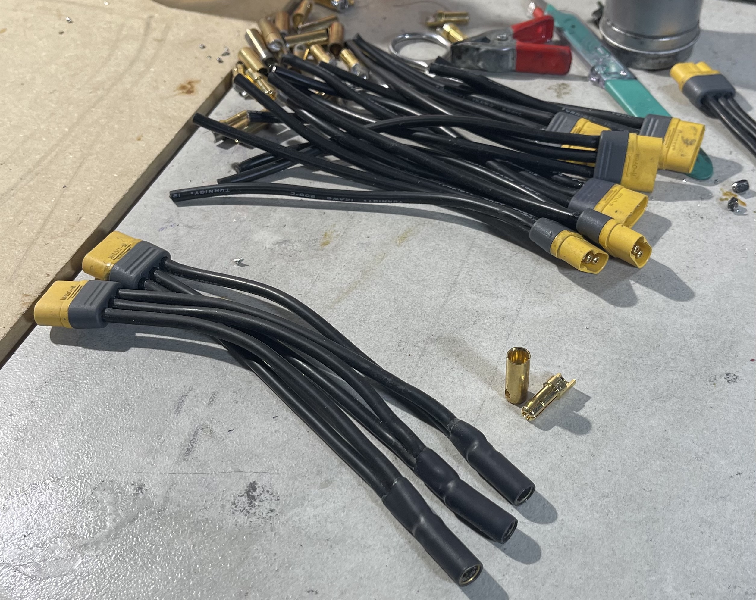

@b264 you got any pics of what your paralleling connection scheme looks like? This is a lot of wires.
I’m ok with using an adaptor for a week long test.
(MR60, MR60 ) -> 5.5 bullets
I’m soldering the 4 adaptors I need tonight.
I don’t have any photos. I just made an adaptor with MR60 connectors. If I go inside the enclosure again, I’ll take a photo and add a metr
I’ll have pics before I go to bed tonight.
I’m going with this.
It’s a struggle getting two 12awg wires in a 5.5 bullet connector.

Got it. Connectors (for my use case) were more time consuming than I expected.

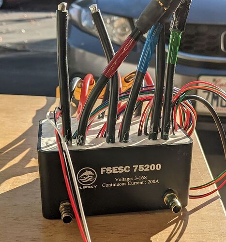

I’m back with more questions on this FSESC. We’ve got it hooked up and running. It’s on what would best be described as an electric surfboard. It runs, but has some significant problems…
If we run in FOC mode, it gets up to a mid-RPM and then immediately locks up and chatters until you release throttle.
If we run in BLDC mode, it appears to act normally, but will only draw a max of about 35 amps. Also, if I hold it at full throttle for about 10 seconds, it starts to do the sort of chatter you see when it’s having trouble starting. I thought I had all the current settings in order, but I’m guessing I don’t.
Do these symptoms sound familiar to anyone?
Thanks.
The FSESC dual models are not a single MCU / dual motor configuration, they are dual-MCU / dual motor, so they can’t be used this way. You’d need a single-MCU dual-motor ESC like the Unity, Stormcore 60D, or Stormcore 100D.
Which ESC are you using?
This is the same unit I originally started the thread with. I think you’re the one that assured me it’s a single MCU if I recall correctly.
Oh yeah, the thread title is still throwing me off. Whoops
