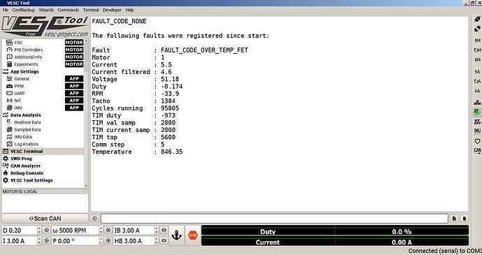

Have you checked for faults? Rebooting the ESC clears those, so check before a reboot.
Maybe try Ackmaniac 3.103 firmware and see if the same thing happens or not.
We did check for faults. Usually we got nothing, but once we got this…
