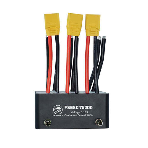

So here it is. I suspect it’s a single-MCU, but I don’t know that for sure. It only has one PPM input, one USB input, one Hall sensor input port, etc. Interestingly, it’s got 3 sets of battery inputs, and 2 sets of motor outputs.
It comes with either an aluminum case or a waterproof case with water-cooling inlets and outlets. We’ve got the waterproof one…
This image on their website shows the battery input and the motor outputs ganged…
That there is a single channel ESC.
yea, that’s a single drive esc, basically all 3 battery connectors goes to battery, and those 3 sets of 2 wires are like the 3 individual phase wire for regular esc.
Thanks. By “single channel”, I assume you mean there’s only one MCU, one DRV, etc. - right? So it’s safe to gang the motor outputs?
Why are there two sets of motor outputs (and three sets of battery inputs)?
Yeah. Idk, it’s probably easier to spread the I/O in the PCB vs giant gauge wires.
because of the awg wire that they use are not able to handle such power, so it had to be split
So do you suppose those wires are connected internally? Or maybe they each go to their own FET, and that’s how they get the high current capability?
They are each connected to a pair of FETs. And probably connected internally, but not for the amounts of current necessary.
That’s a single-MCU single, it’s not a dual at all.
One question OP, why do you want to connect a single motor on dual ESC at all? If your motor is double stator with 6 phases I get it, else?
Just to double the raw phase amps? Get a bigger single esc in that case, it might do the job in a safer way IMHO
It’s not that I “want” to do it. My buddy bought all this gear to make an electric foil-board. He isn’t familiar with brushless motors, VESC’s, etc. So he asked me to help. The manufacturer shows the unit being used this way. It has two sets of motor outputs, so I assumed it was a dual VESC. But they gang the outputs to a single motor.
It’s not a dual VESC, it’s set up like the Trampa 75/300 is.
