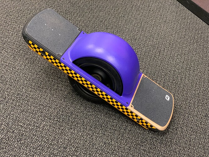

So the well used Pint I got had a slight issue because the last owner probably used a power tool and pulled out AND broke two of the brass inserts in the front footpad. So the corner pops up. I was going to get a new set but damn FM charge $120 for them, It didn’t really affect riding so I was putting it off.
Then recently found a guy that swapped to the wood Surestance wood front pad and aftermarket angled rear pad. So he sold me his unused rear wood pad and basically new original front pad as well as a new purple fender, all for $80! I also got the float plate and side guards (bought their blemished one which looks perfectly fine). Looking good now. Going for the Crazy Taxi look.
