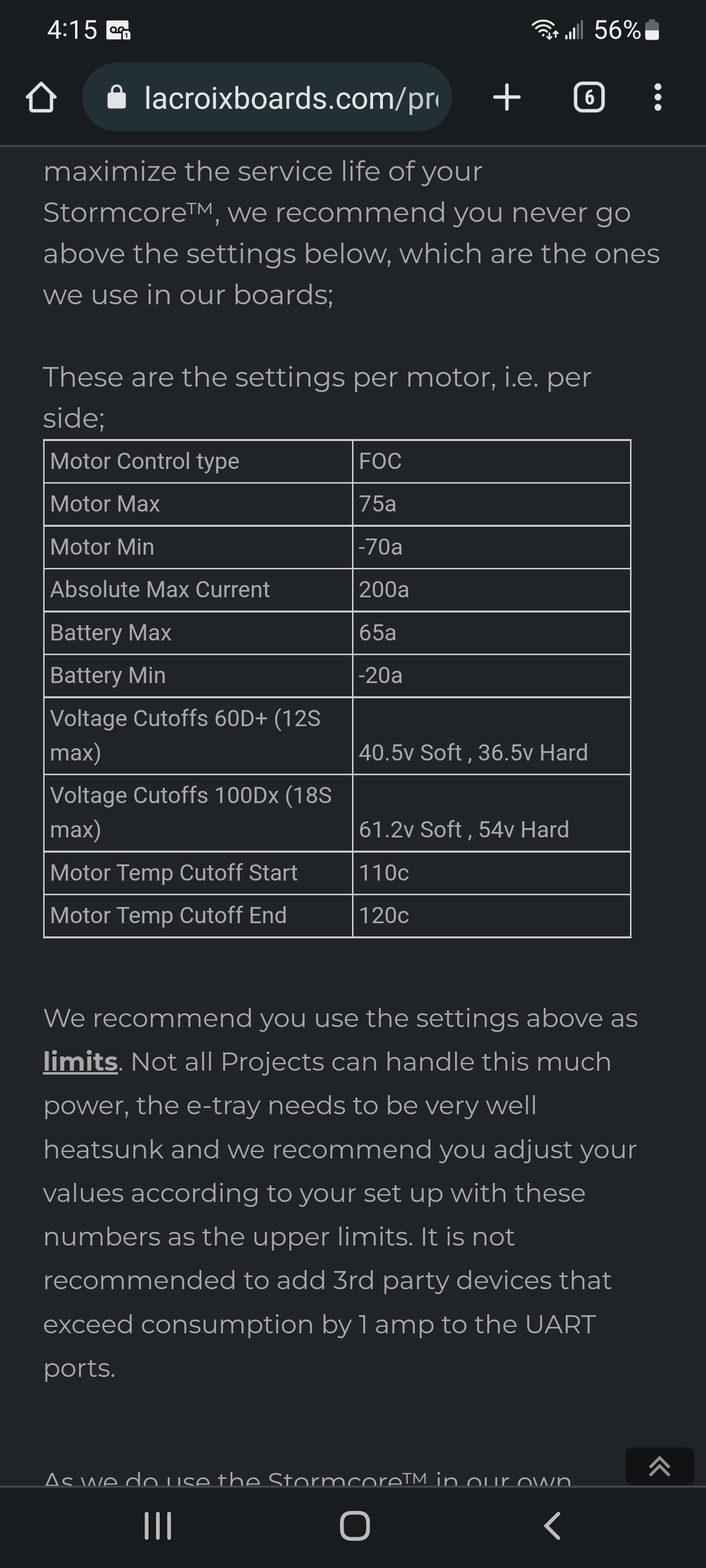

setting up p42a 12s4p on stormcore 60d+
saw that too thought it was way too low, i manually changed to the values in the screenshot above
Detection ran flawless on both motors, and the plugs look great.

ive been just inputting 75/-75 as per lacroixs recommended settings. Never moved from 75a even on my lonestars
-70*
@Crate just a heads up, this is bad advice. Most people here would advise you to not run these settings with a stormcore and 12s4p p42a.
