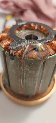

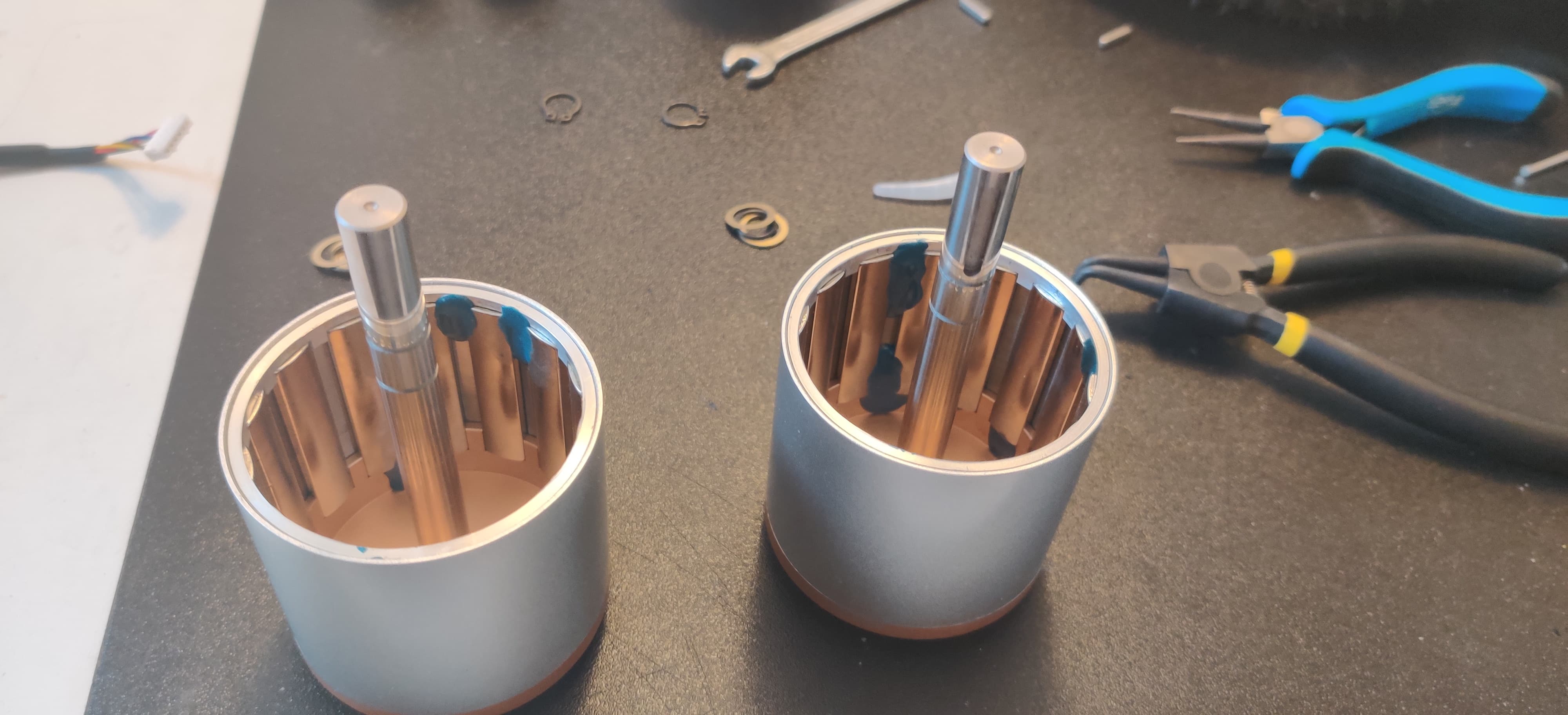

So to sum up the issues I’m seeing with 2/4 of the motors I took apart:
They only put glue in a few spots to strengthen the magnets.
One motor has more spacers then the other, (4 on one and 2 on the other)

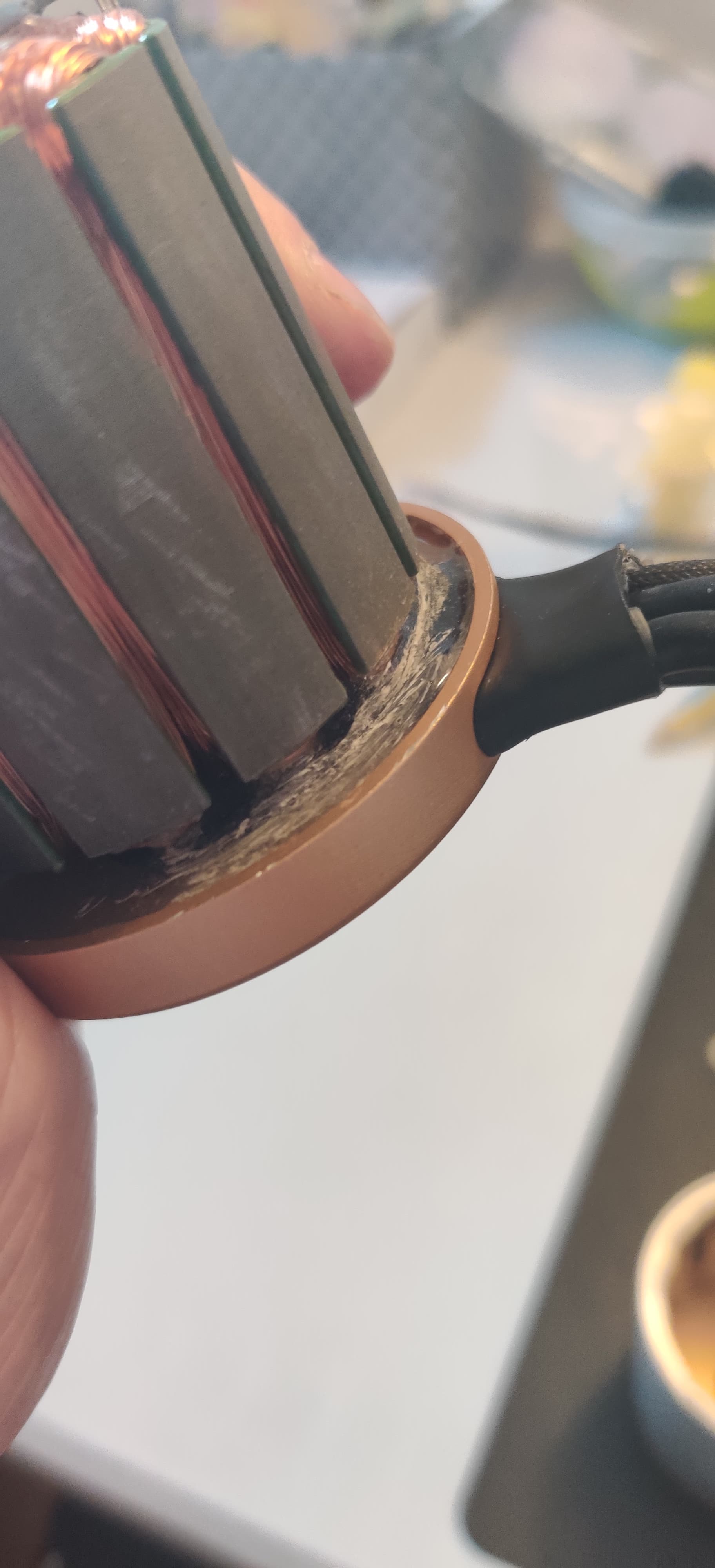

They filled the top with epoxy over the wires, but they used too much so the can was stuck on it and is now scraping on it (Look at the marks)
Few other issues, one of the shafts were a bit crooked but very minimal useable but would ruin the bearings or shaft very quickly.
It’s a cheap motor, but not acceptable that 2/4 motors aren’t up to a standard.

Bro you got fucked over. Those are test batch motors, there is no epoxy on those at all only balancing compound.
Edit: They changed the magnets in the newer one too. Not sure why they’d send those with any preposition that they’re epoxied, are you sure you ordered the right thing? Where did you buy from exactly?

Yea I see what might be going on. Flipsky are peddling off the test batch before selling off the motors with the actual finalised design. The reviews on the product are abysmal too, without anything holding in the magnets it looks like people are having issues pretty quickly. They did the same thing with the VX1, and the VX2, AND their antispark. Sent out a crappy version until they got feedback and fixed the issues. Get a refund

Got another one to take his apart, looks exactly the same on the inside but missing all epoxy over the wires.
So theres a massive difference on these motors shipment from shipment, weird qc they have.
Oh my gosh the motors are built like poo,
Exposed wire for the halls, the black one is… idk even know anymore and theres a huge solder ball in there??? Wat
Wheres the red wire lol
That blue stuff is actually to balance the can, it’s not to hold the magnets in. The difference in spacer amounts is result of a similar tuning. Those are both good things.
But the rest of this is unfortunate to hear.

Theres also some epoxy resin in between a few of the magnets as well as the blue stuff.
But its only on a few and very hard to spot.

Looks like the halls on these were an afterthought as well.
I fought with Flipsky to get a refund on my ESC’s for so long and I haven’t succeeded. I only had problems with their products like one side of a dual 6.6 not working or getting a smaller battery in a VX1 than friend that ordered 2 days after me. Anyways what I’m trying to say is that you won’t get a refund… they will only “fix” it when you send it back. Never heard about a refund from them.
Nah, the issue is a combination of the convex magnets and maximizing stator size, the hall sensors dont work properly unless they go into the stator or the can is offset. The installation looks fine to me, there’s an epoxy coating over the solder terminals.
I do wish they clipped the solder terminals flush before doing that, like on TB motors.
But yeah, they couldve done a much better job, but :man_shrugging:
