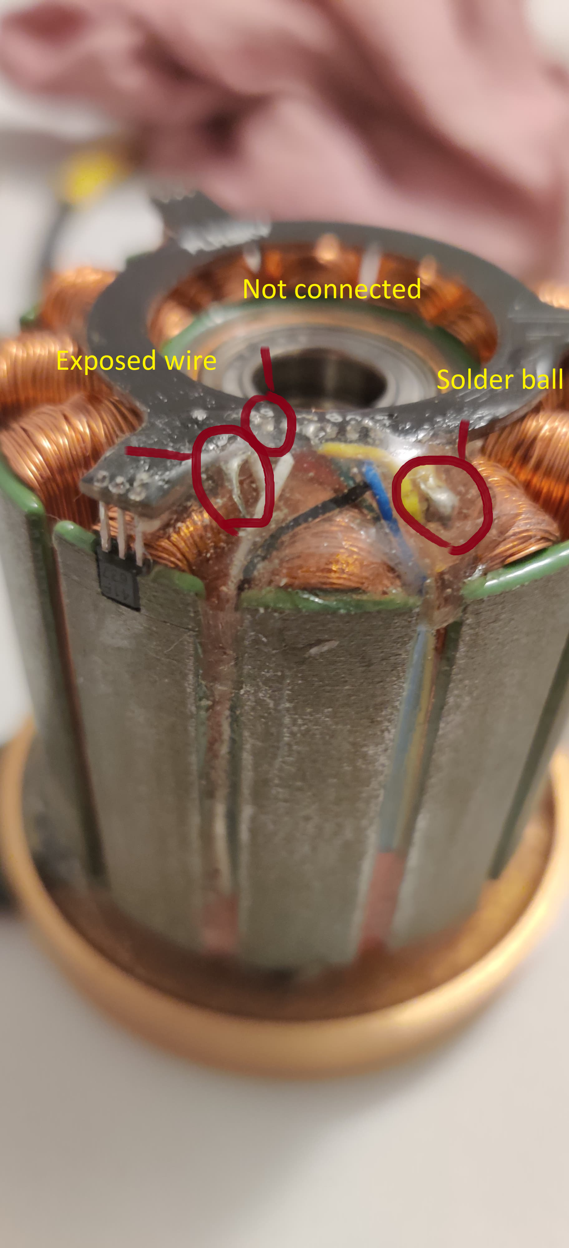

Not sure how this is fine.
None of the hall sensors works.
Its all an easy fix, but most people who buy these parts arent as skilled as us.
So far ive got 5 motors reported with simular QC issues on the newest batch, waiting to hear if theres more posted in a few forums.
They need 5V to work.
Did vesc tool not detect them? It looks like everything is covered in epoxy.
The red wire is just hard to see.
No it dosnt work, also theres no connectivity to the pcb so half of the wires arent even soldered on right as i pointed out on the pic.
Did you make sure to set the sensor voltage to 5V?
If yes, then thats absolute ass that they dont work.
Everything is set to what it needs to be set at, but it dosnt matter when theres no connection from the wire to the pcb on half of the wires.
White, yellow blue has connectivity, the rest has none.

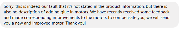

Flipsky wrote to me after seeing my post on fb, asking me to delete it.
The motors are apperently “Beta motors” And they all are, every batch will be different and have their differences. (All motors bought are beta motors)
Was never mentioned anywhere on their website.
You shouldn’t delete it unless they do something about it. Even then, you should only promise to consider deleting it.
No reason to delete the truth, but they did themself i think.

Gotta give them, they do admit to them being wrong and its their mistake.
And a new motor, if they give me two im gonna say it.
Im gonna do it, no one can stop me.
Decent customer service.
Great
