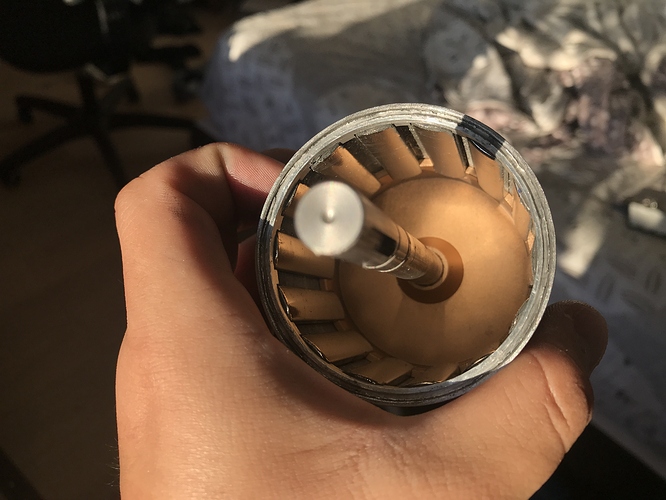

but that “blue magnet” glue is a balancing epoxy for the rotors…

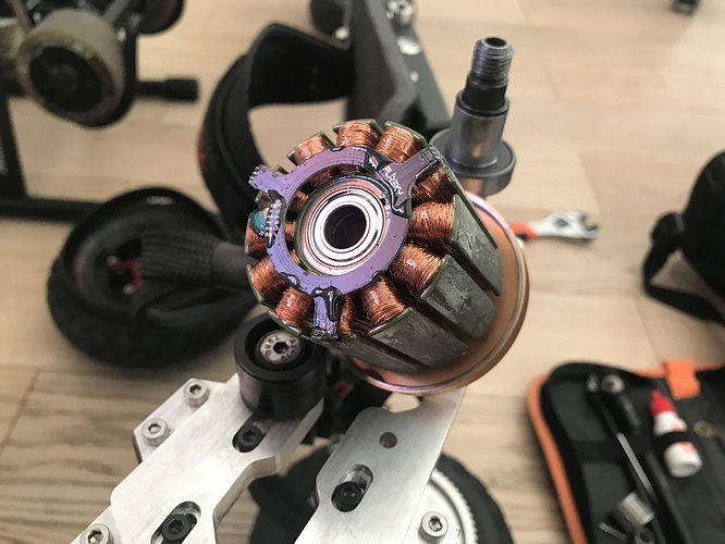

I’ve also had some test motors (they did mention that to me) these are the interiors and it looks fine to me?
My only issue is this ring that eventually came off and started to rub against the base of the motor.
This experience was quite scary because i found this out when I was braking, and my motors started cogging/locking up. Went back home, hammered this back in and added epoxy, let’s see how well this will hold.
