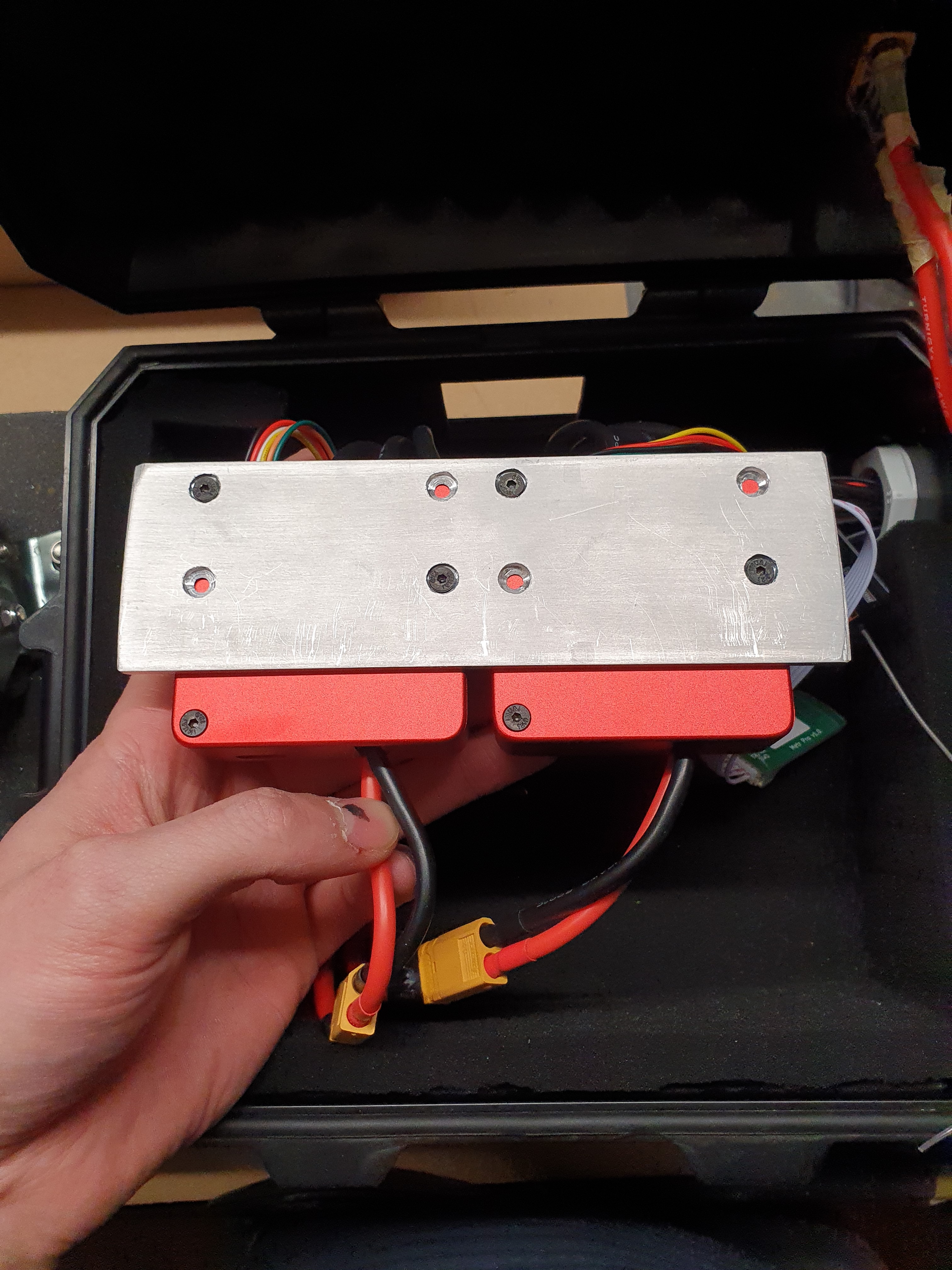

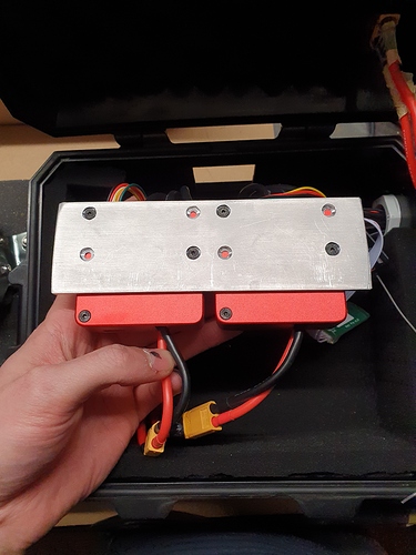

The neobox looks a bit taller.
It is a few mm taller yes
Ah so the heatsink is the curved side and the lid is flat?
Yep

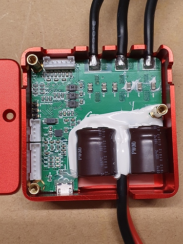

What extra pad?.. Could you circle it?
Edit :
My thought exactly

yeah it was just the silkscreen under the cap that looked like a pad with solder
To your defence, three terminal caps exist :slight_smile:

It spins. :+1:

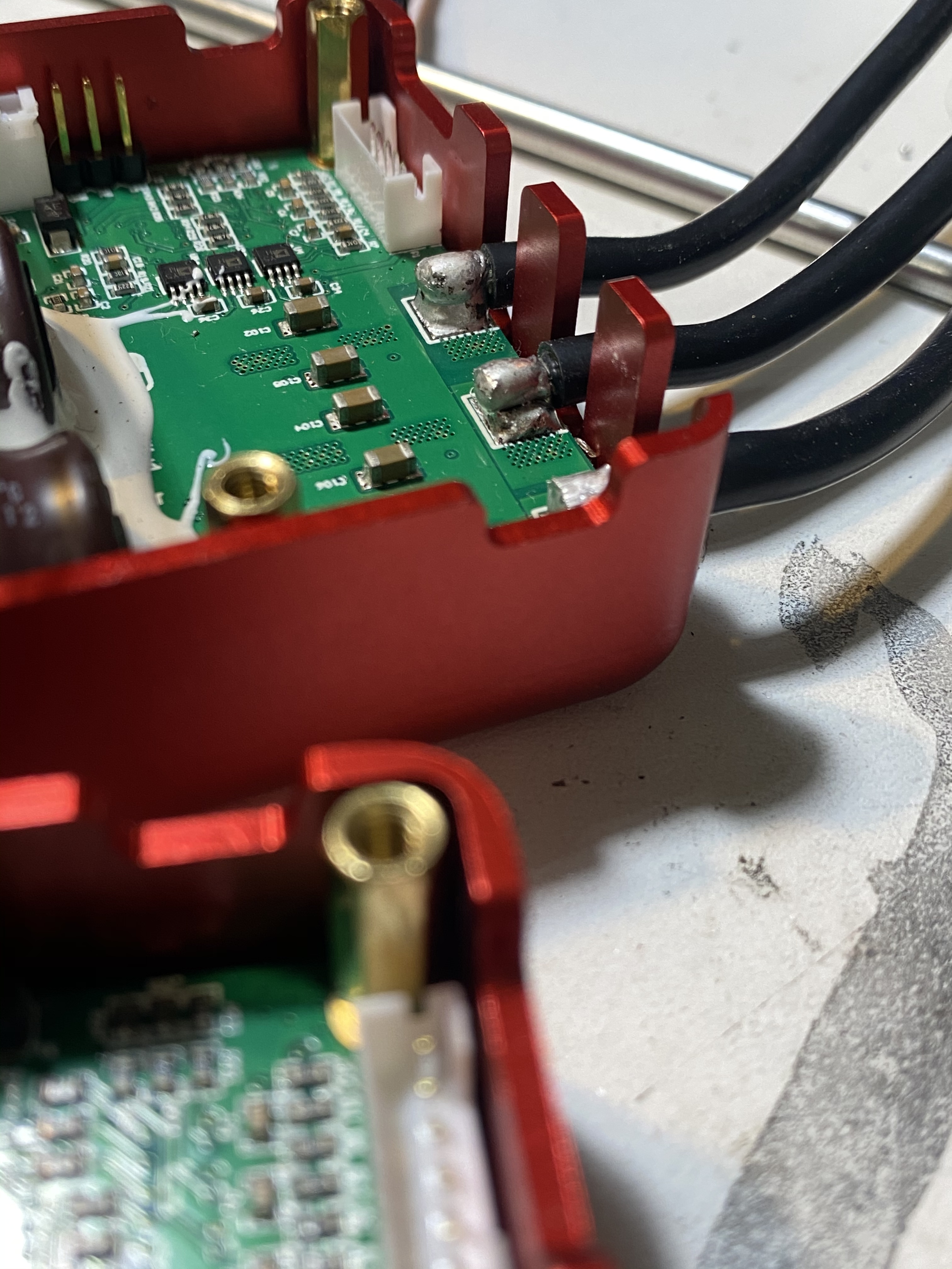

I considered redoing them. Is that lead free solder?
The rest were good. I was going to finish a 12s 40t pack for this, but I am just going to tape lipos to the deck like old times.
Yikes that middle solder joint is looking crusty :eyes:
And I see at least one solder ball… :confused:
You have any green liquid on yours?
Also our white silicone has the same speckled shit on it… I don’t think these were cleaned at all
Ugh
my phase wires have plenty of tin soaked in them so i figure I should swap them out. not sure i can do this while leaving the pcb mounted on its plate

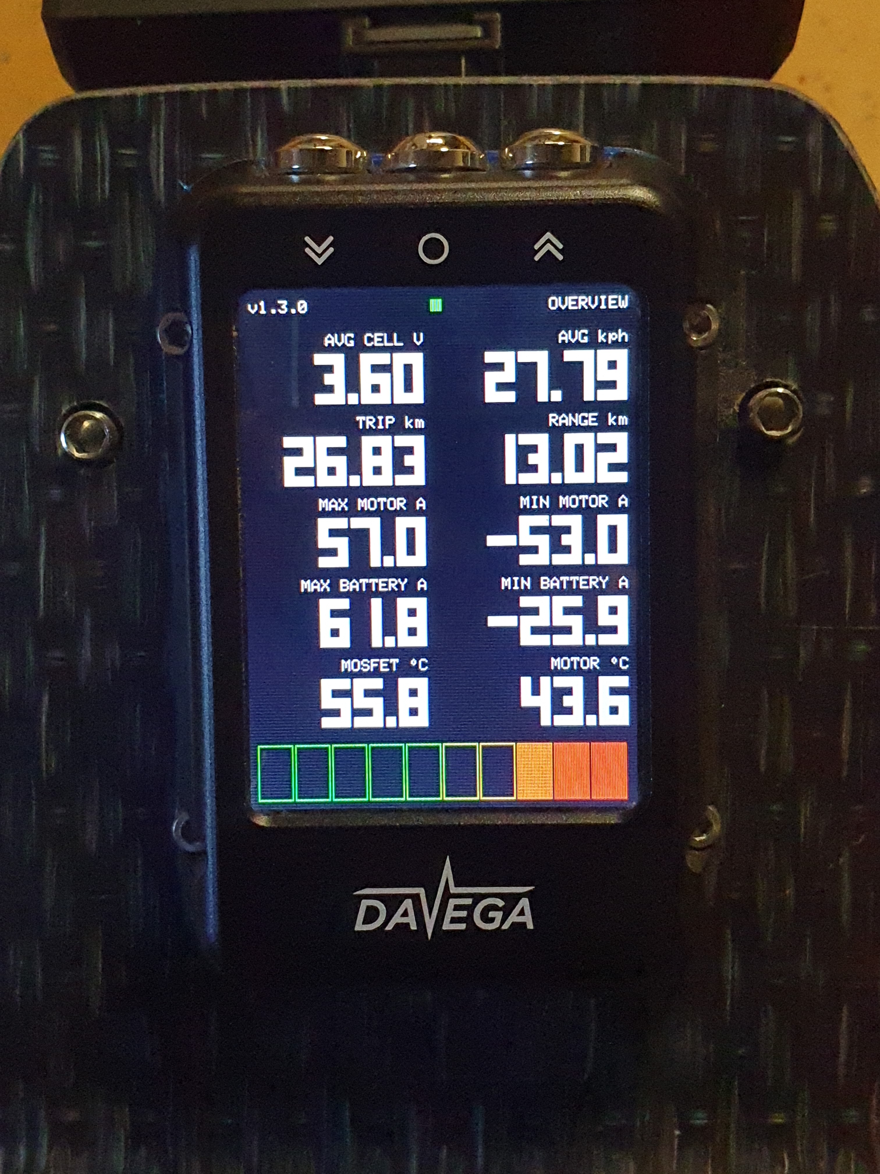

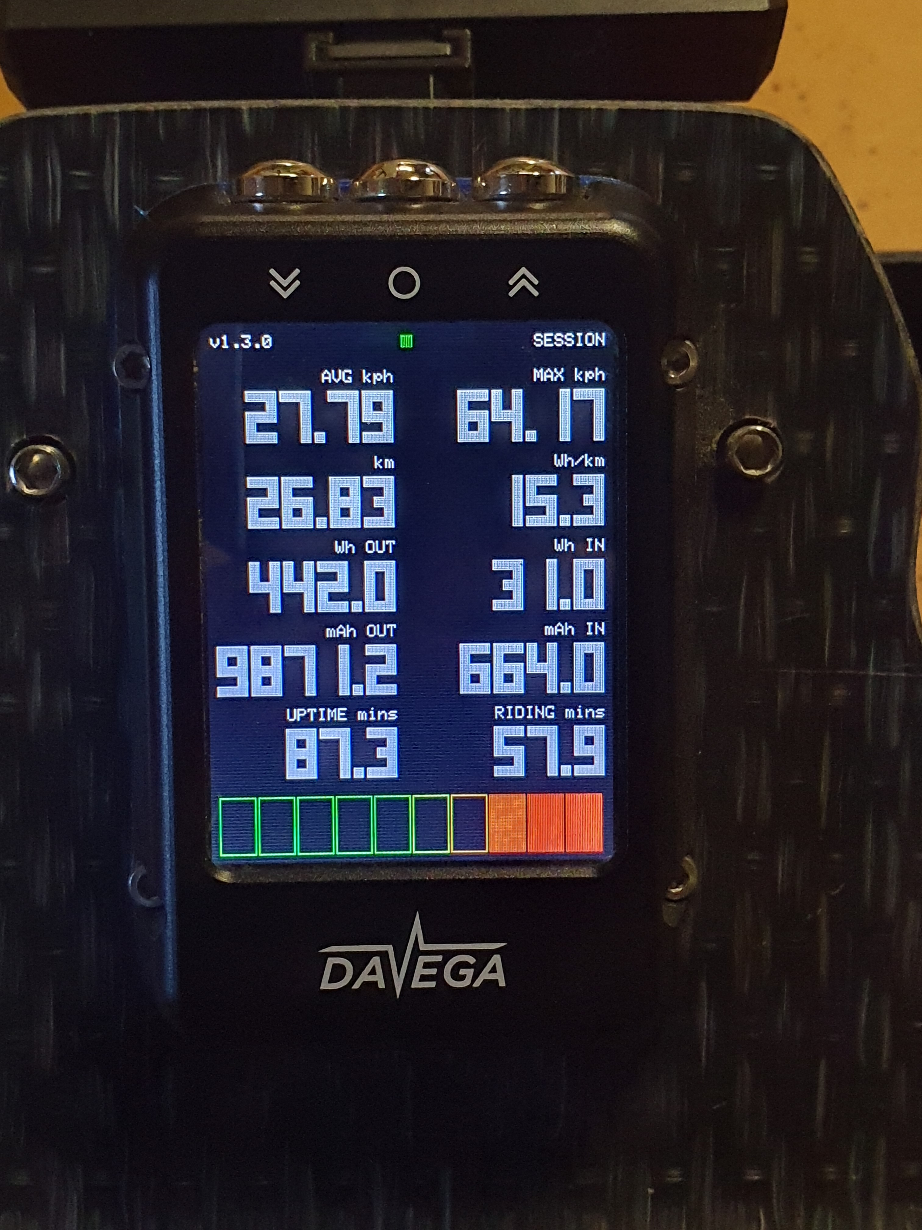

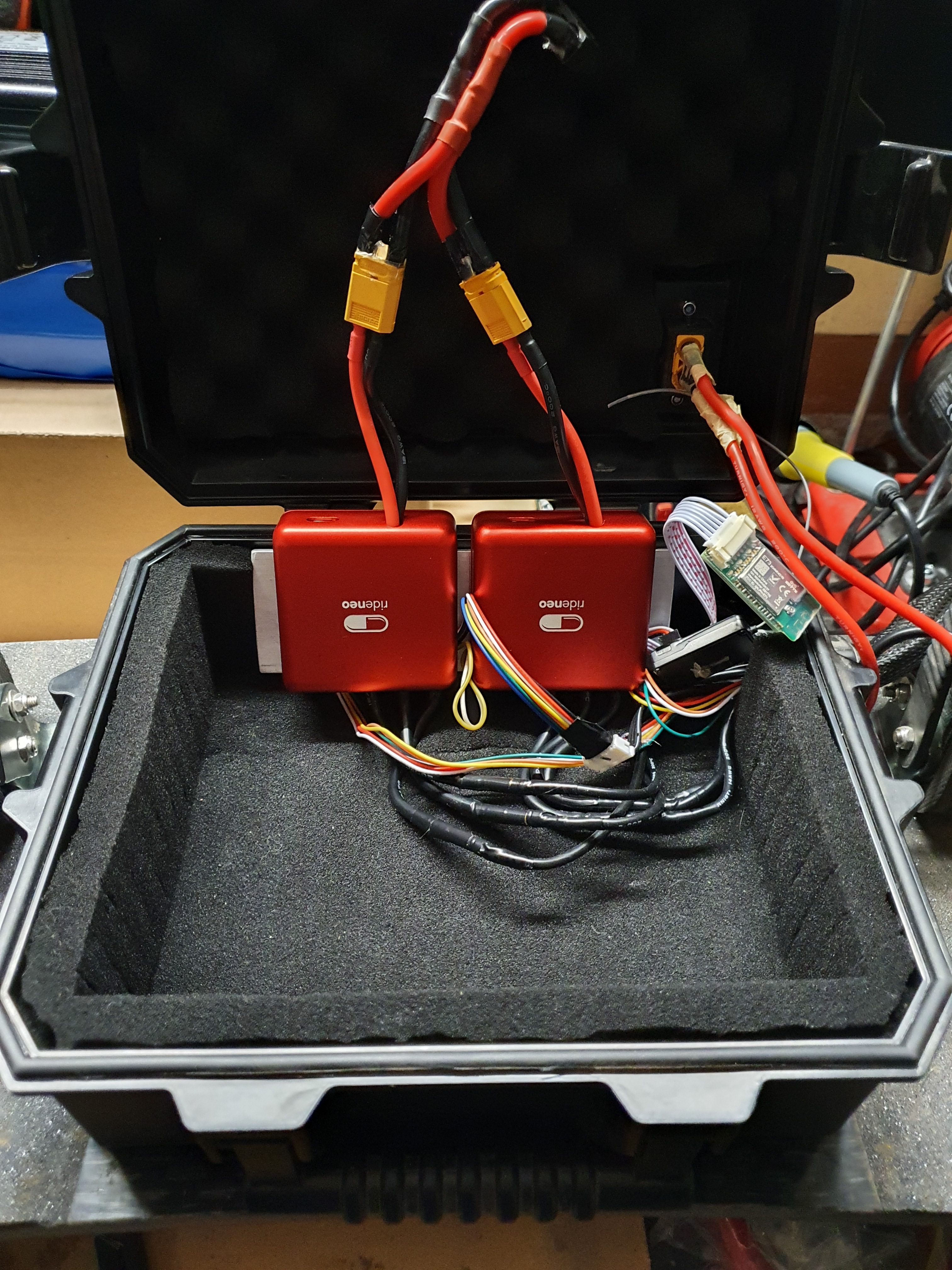

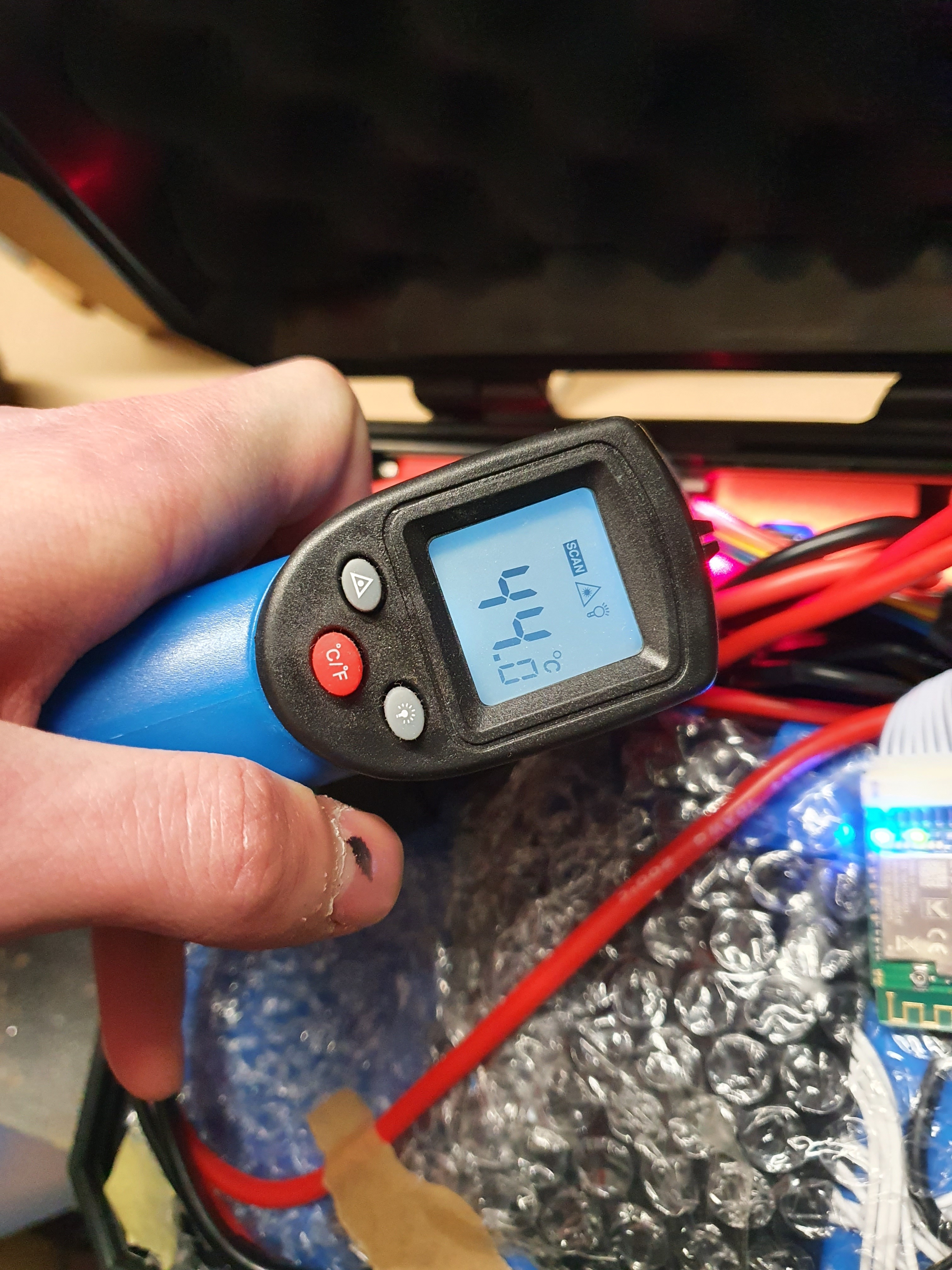

First test today, 27km ride and I pushed it pretty hard already (see Metr Pro log). The vescs definitely endured a lot of vibrations (more than the board endures on a standard ride), I went through the forest, bumpy grass fields and rocky field roads. On road I went full speed on some parts on my way home. Temps peaked at 74 which is also due to the vescs being in the same case as the battery and having only a small gap for cooling in the enclosure. Anyway I did not hit temperature cutoff. Just after I was done with the ride I measured the case/heatsink temps which were around 44 degrees celsius.
The response and controll of the board feels similar if not identical to my old focboxes which I guess is good thing! It was an awesome ride, looking forward to keep testing these babies.
DavegaX log:
That solder job on those phase wires is horrendous!
Mine were good, maybe a quality control issue
We have changed supplier for our pre tinned cables. They had some problems with quality. So it can be fixed for production batch.
Good work Jeff, that’s what the test phase is for. Shouldnt that have been picked up in QC though?
