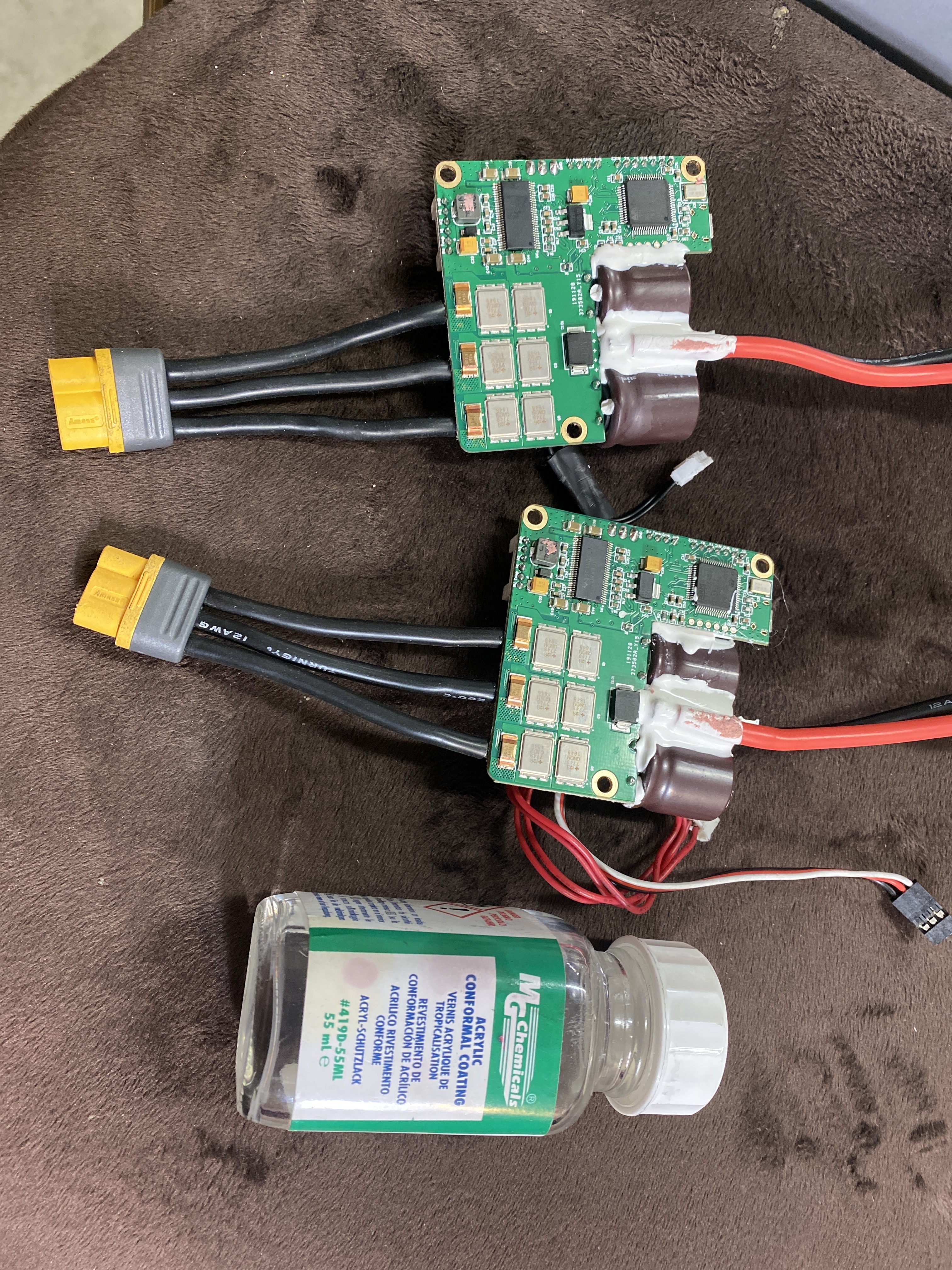

Is this the correct conformal coating for this application? @b264?
Should I avoid fet interface with sink?
Just slather it on right? Avoiding connectors.

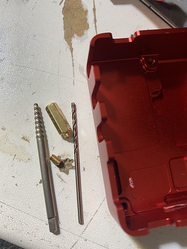

Also, I managed snap off a hex standoff taking the lid off.
Be careful unscrewing the external m2 screws.

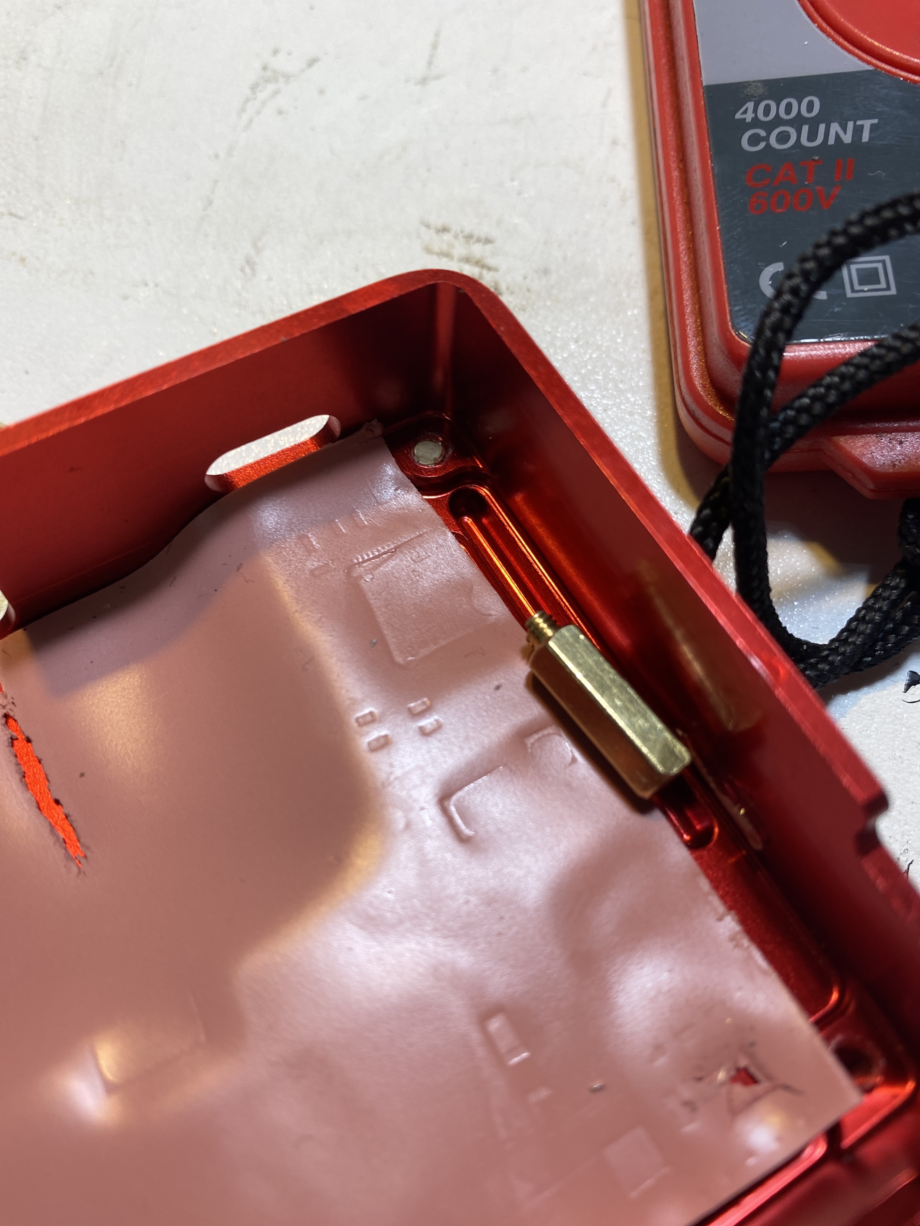

Can someone else who owns a NEObox v6 thicken the thermal pad under the fets and check if there’s a noticeable change in temp?
Thermal pads NEED contact… And by the looks of it the fets are making zero contact :expressionless:
Put the thinnest single coat possible on the FETs first. Let that dry.
Option 1:
Make sure you got between them as well. Go fast, because it dries quick and is thick. Don’t worry about getting extra on there as long as it isn’t directly on top of the FETs. Even in between them it can be thick.
Option 2:
This is more difficult. Not sure how good you are at painting. Get the tops really thin, then after it dries go back and put thick coats in between them without getting any on top, but touching all sides of them. This is better but requires tedious brush skills.
Then, whichever way you did it, after that dries (20 minutes) go back and get the rest of it with a thick coat. Everything except don’t get any inside the USB jack. And I am assuming you’re not using any of the JST connector, ever. If you are, you need to plug those in first or they will never work if you brush the pins.
Make sure anywhere water can touch, you’ve “touched” first with acrylic.

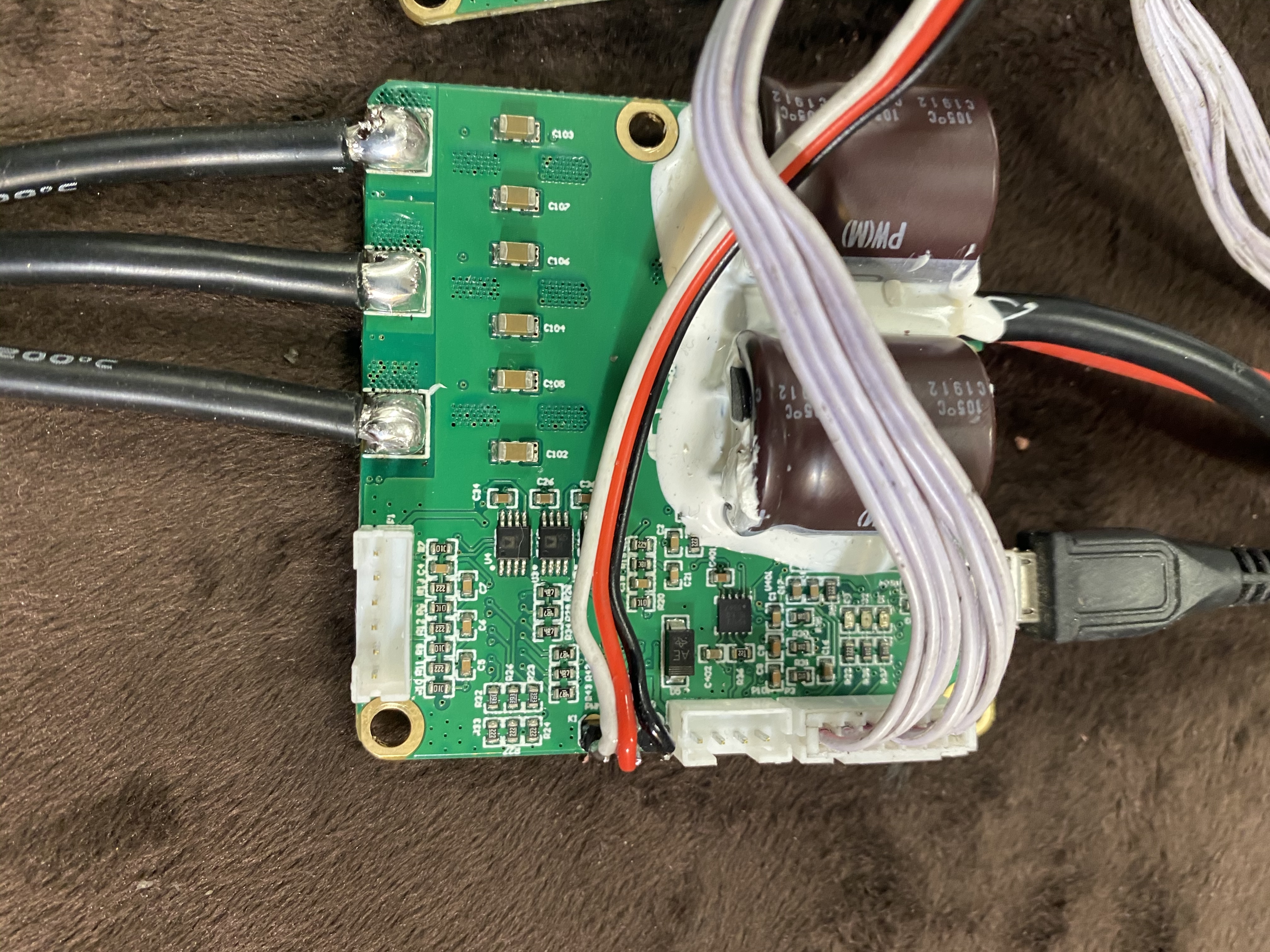

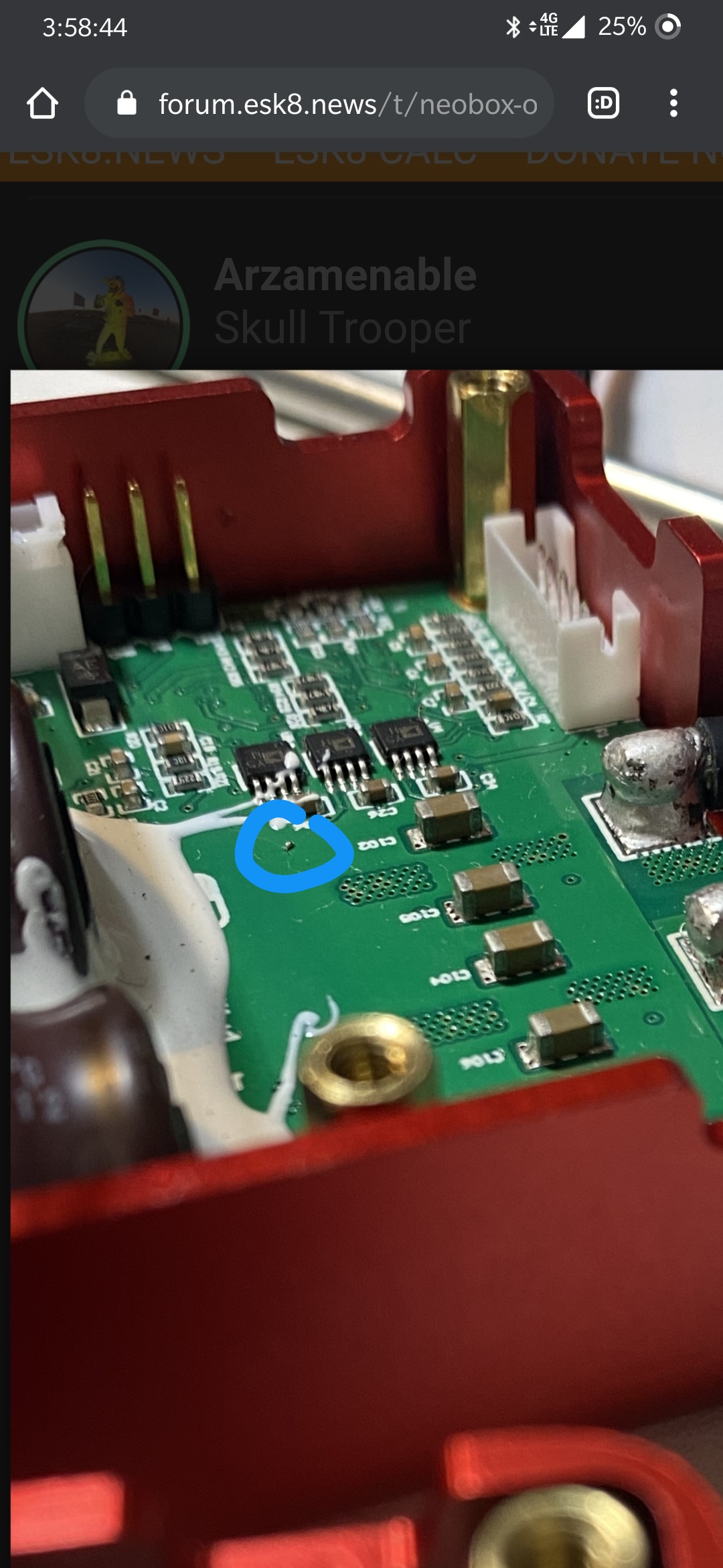

make sure to remove this solder ball and check for others
I don’t like the solder on the caps in front of the phase leads either 🤷

I really miss the MG Chemicals # 419C because it was super thin and awesome for FETs. Then 419D on the rest. Unfortunately, 419C is unobtainium and discontinued and the little bit I have left is not leaving here.
is the stuff on ebay legit?
bottle
can
The can is definitely the right stuff, but it’s 1000ml which is 20 times too much :rofl:
If you buy that can, I want to buy some from you…
The other thing, I don’t know what that is.
419C is THIN af and dries SUPER fast, like sometimes within single digit seconds.
It’s GREAT for FETs but not great for the rest of the PCB. Best thing ever for FETs.

Filled down a brass replacement, drilled out broken standoff.

Are the fets making good contact with the thermal pad on your boxes?

What is wrong with it. It’s not cold solder.
it just looks off to me in the pic, can’t really tell if anything is wrong
They are making contact. The thermal pad cannot be too thick or it will not be effective.
