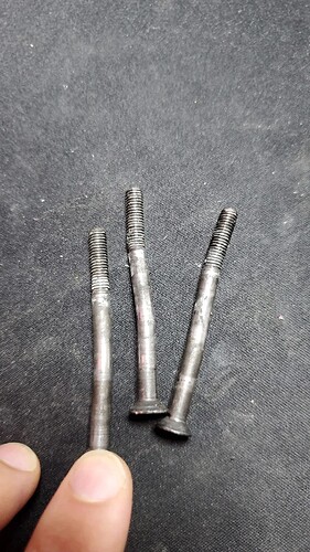

Small update on crashing these trucks at full speed with the impact on one side of the trucks…
So, a guy that is using the Savage1 trucks had a malfunction with his esc, and the board went full speed into a curb, or something. He purchased a new front truck assembly, then sent me the crashed set. Here are my findings after looking over everything…….
The hanger itself did not bend. I found .07mm, which would be fine
I did find that the pivot pin was bent about 10 degrees.
And the king was bent about 5 degrees.
It was such a hard hit that the hanger had to compress the bushings this much…
The last picture is where the king pin actually hit

Damn! That must have have been a very hard crash!
Apparently it was. Here are the pics of the deck screws.
Lol they would have been hard to get out.
Hope the dude is ok!
