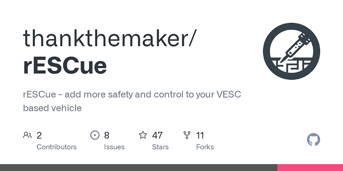

  • Here is my analysis Based on this device we could
  • repurpose led bar as addressable blinkers by adding 3 pin connector for L and R buttons input (and changing trigger in the code from forward/backward from can to buttons input) or keep front and brake wled and add trigger and output for left right blink on a longer strip
  • repurpose buzzer to alarm (add armed mode into blynk app, with ebrake full up on movement ) (or one of normal light output can be used for alarm siren, freeing buzzer io)
  • uart is used to speak to display (display button used to turn on headlight over uart light) (can to vesc)
  • up on mode change message (1/2/3) push vesc parameter change over can ? May be possible (no need to store specific setting in eprom, just push specific message to set rpm limit 1 rpm limit 2 rpm limit 3)
  • than creat if command based on different triggers like (twice brake over 50%, + mode one, + mode hold sec) to send 9999 rpm limit = result is default police mode with quick and hard to guess unlock
Best part is that all of that looks doable as speed calculation already known as per link above!
Mode and light from display to cotnorller is not encrypted.
Adc and brake go to vesc directly
More over display has VBAT - after rfid unlock it send wake up to controlle, so we can use same line to wake up rESCue as it takes up to 75v
Or we can wake it up with display and use rfid activation line as alarm on / off.
  • if rfid was not unlocked / no controller wake up signal but motion detected than alarm and controller is woken and ebrake max message sent for 5sec after no more movement (ebrake will over power adc by default), if rfid was unlock than operation as normal*
This would not require screen changes than

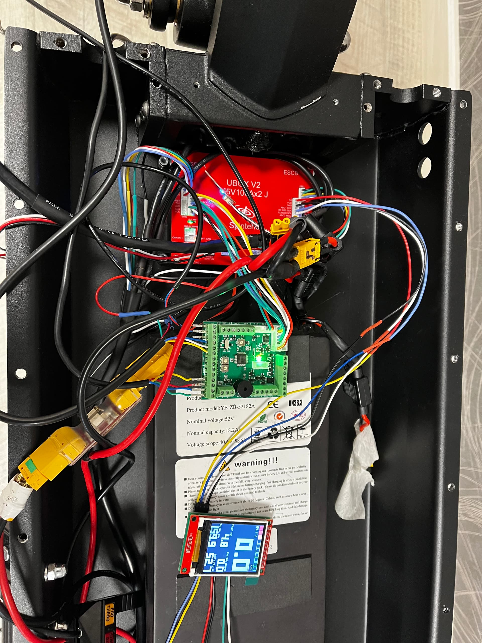

Dear Charclo,
I made my display according to your instructions. Thank you very much, everything seems to be working well!
But I noticed one strange thing: buttons 1 and 2 actually do the same thing - they switch the basic and advanced screen, which displays data from only one controller to which the display (ESCB) is connected.
This is fine?
Or the second button should switch the screen with the data of the second controller (ESCA)?
My ESC - Ubox 75/100 Dual J (spintend)
FW - 5.3
Thank you.
Yes, the two buttons have the same functionality for now.
There is no support yet for getting data from a second controller. I haven’t needed this until now, but it would be a good feature.
