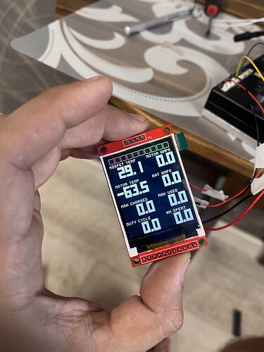

Roxie display (based on DAVEga OS)
it’s only cropped in horizontal setup, in vertical it’s ok
hey, how did you manage to get horizontal screen with big speed numbers ?

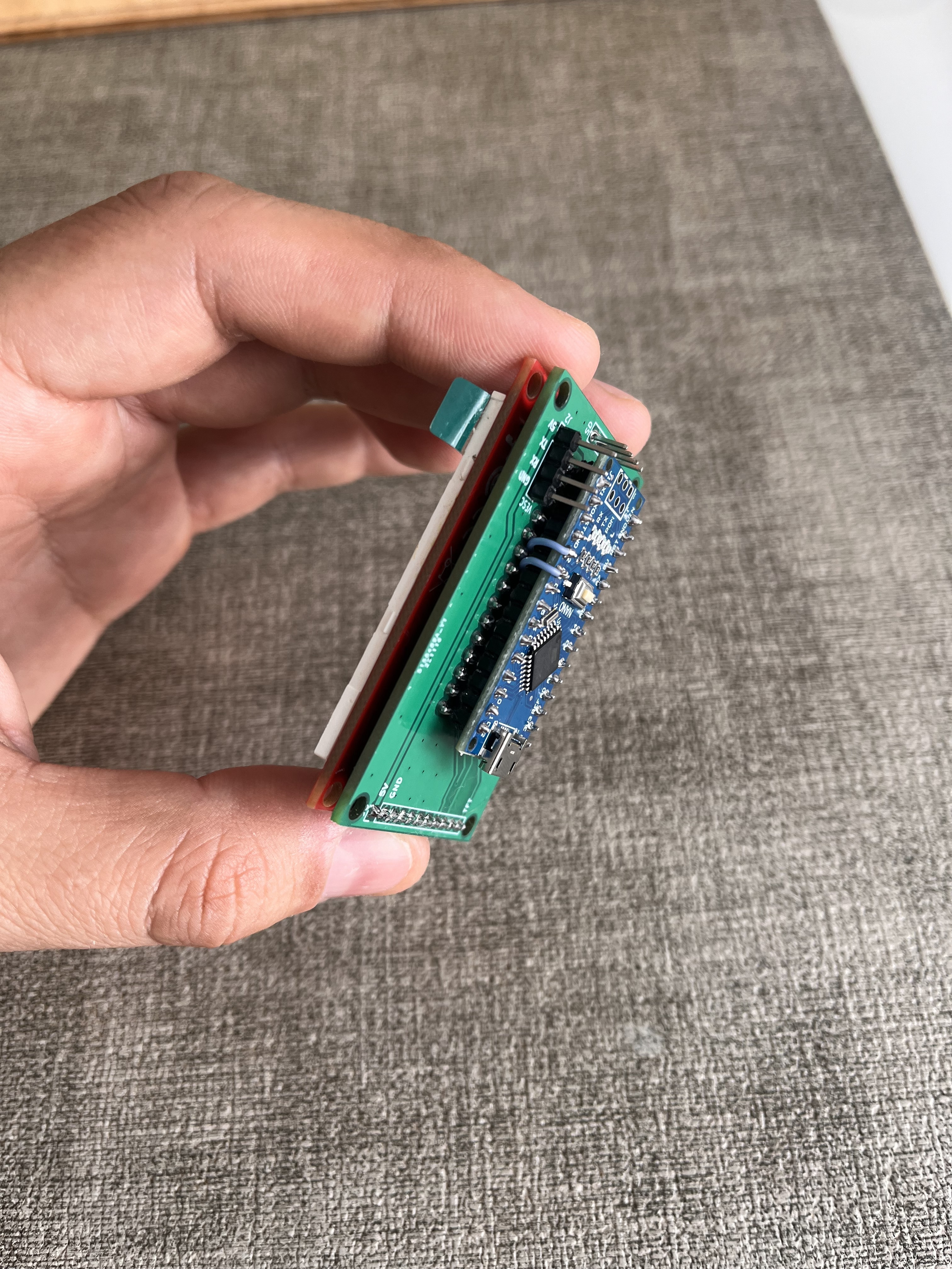

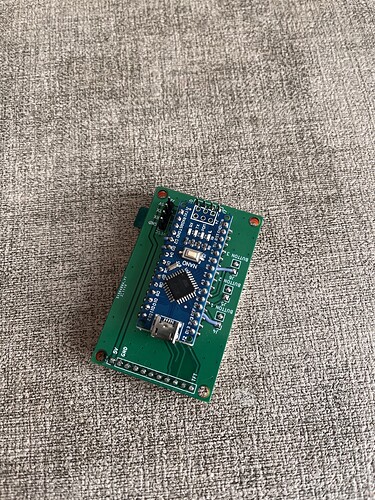

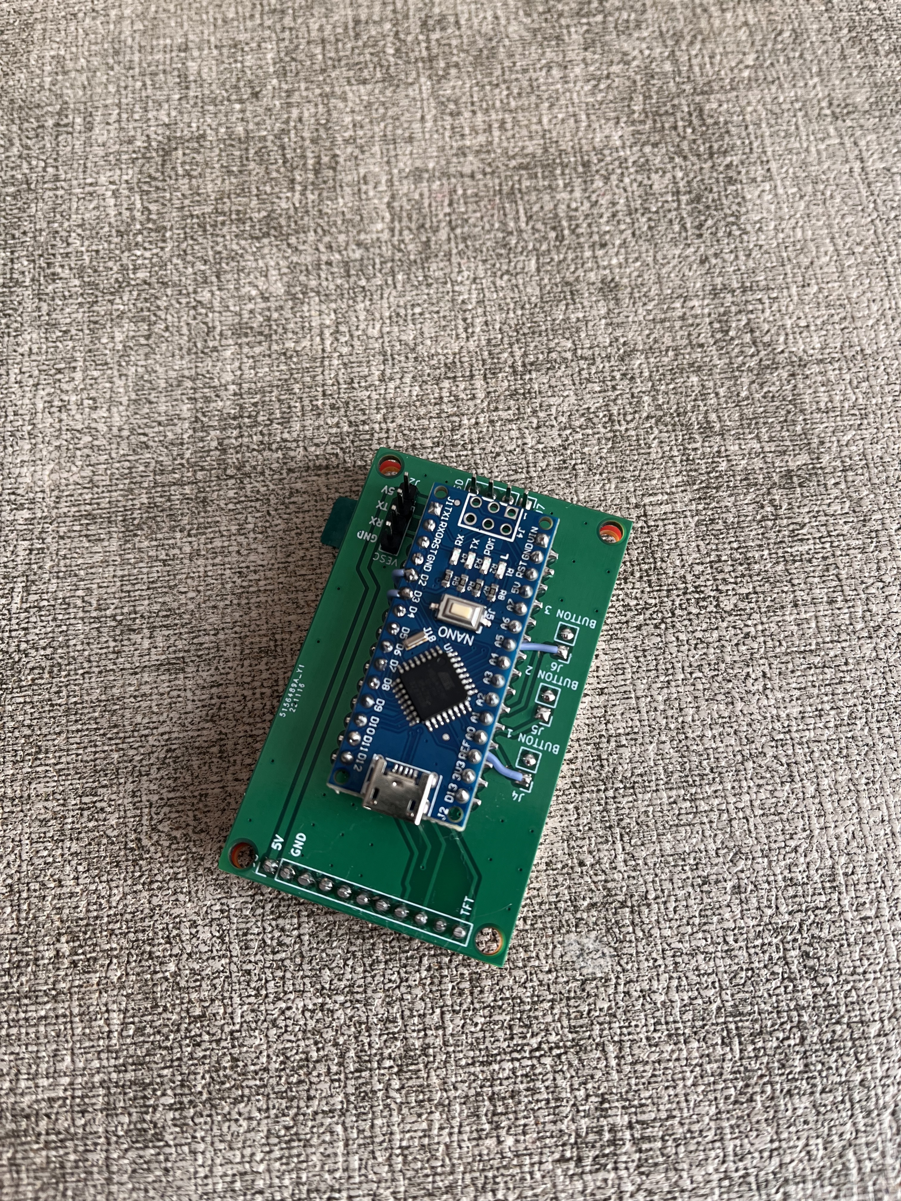

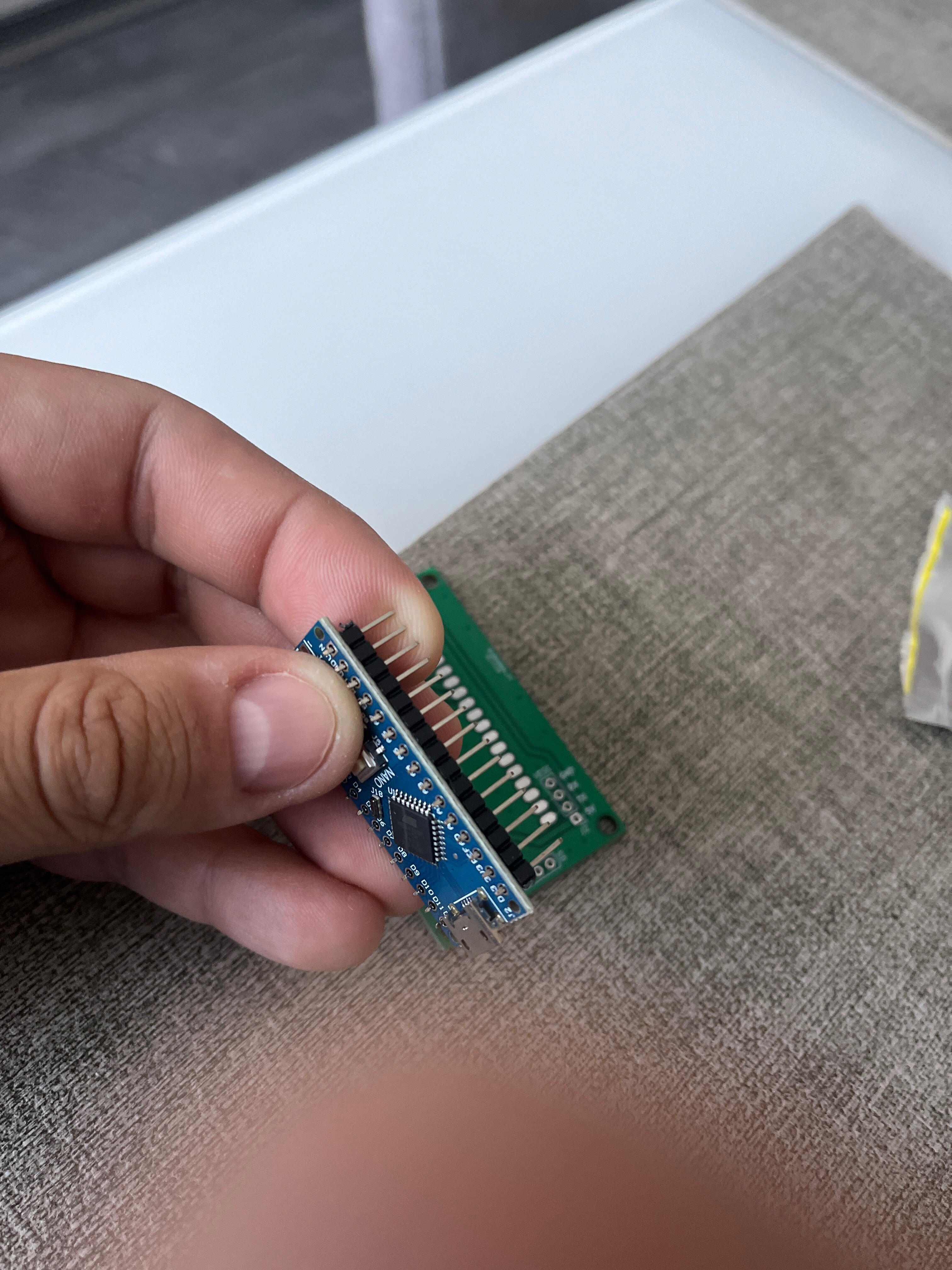

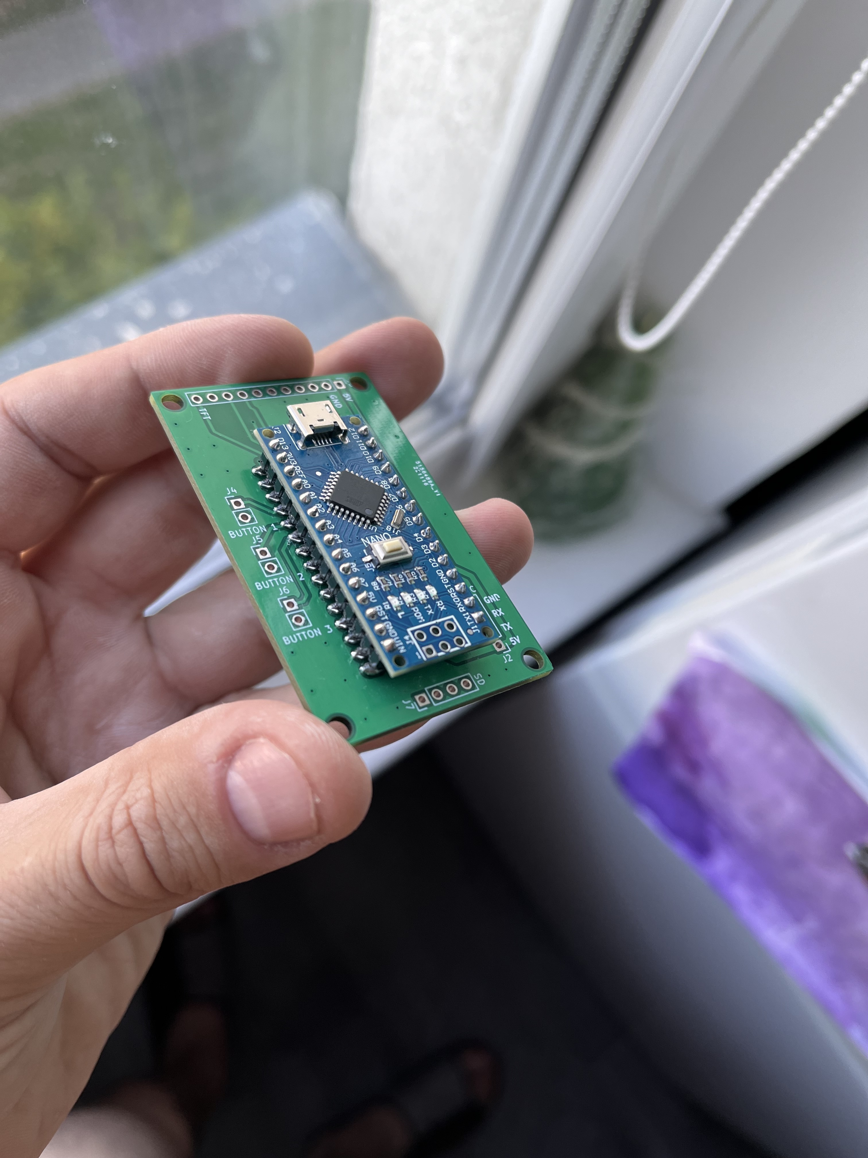

I have assembled another display. This time I used Nano ATmega 328 - this significantly reduces the cost of the project. The dimensions and location of the pins are identical, except for the back side of the board, where additional elements are located. For this reason, it must be soldered to the contact comb. Also, this board has only two digital pins with interruption (D2 / D3) and for the buttons to work, you need to connect these pins with wires to the contacts on the green printed circuit board. Also in the firmware you need to swap Serial and Serial1 or comment out ARDUINO_NANO_EVERY.
