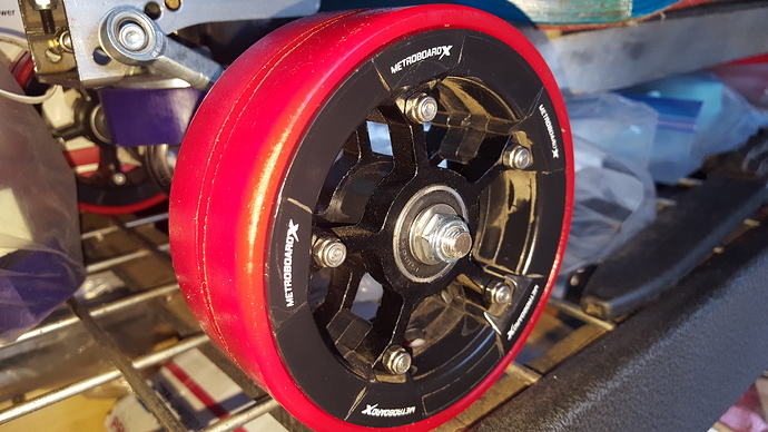

I could likely get away with just detailed pictures of the hubs and gummy.

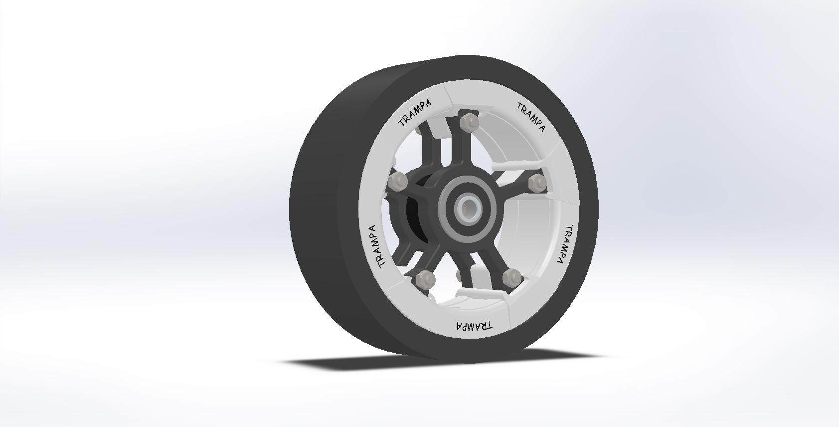

OK, I now have a good rendering of the Gummies and of course it has sent me off onto a different path
What are all your thoughts on this concept:
An indexable, modular urethane knobby tire that you can change the knob positions relative to each other to suit the riding surface from sand, gravel, dirt, wet, to chunder and smooth pavement, etc. Current design is 5 " in diameter and 3.75" wide.
to fit what hubs?
I think it would be really hard to keep under control. Too many things to rub between each other to be able to keep tolerances on check after even 500km
We will need to make the hubs
We have our ways…

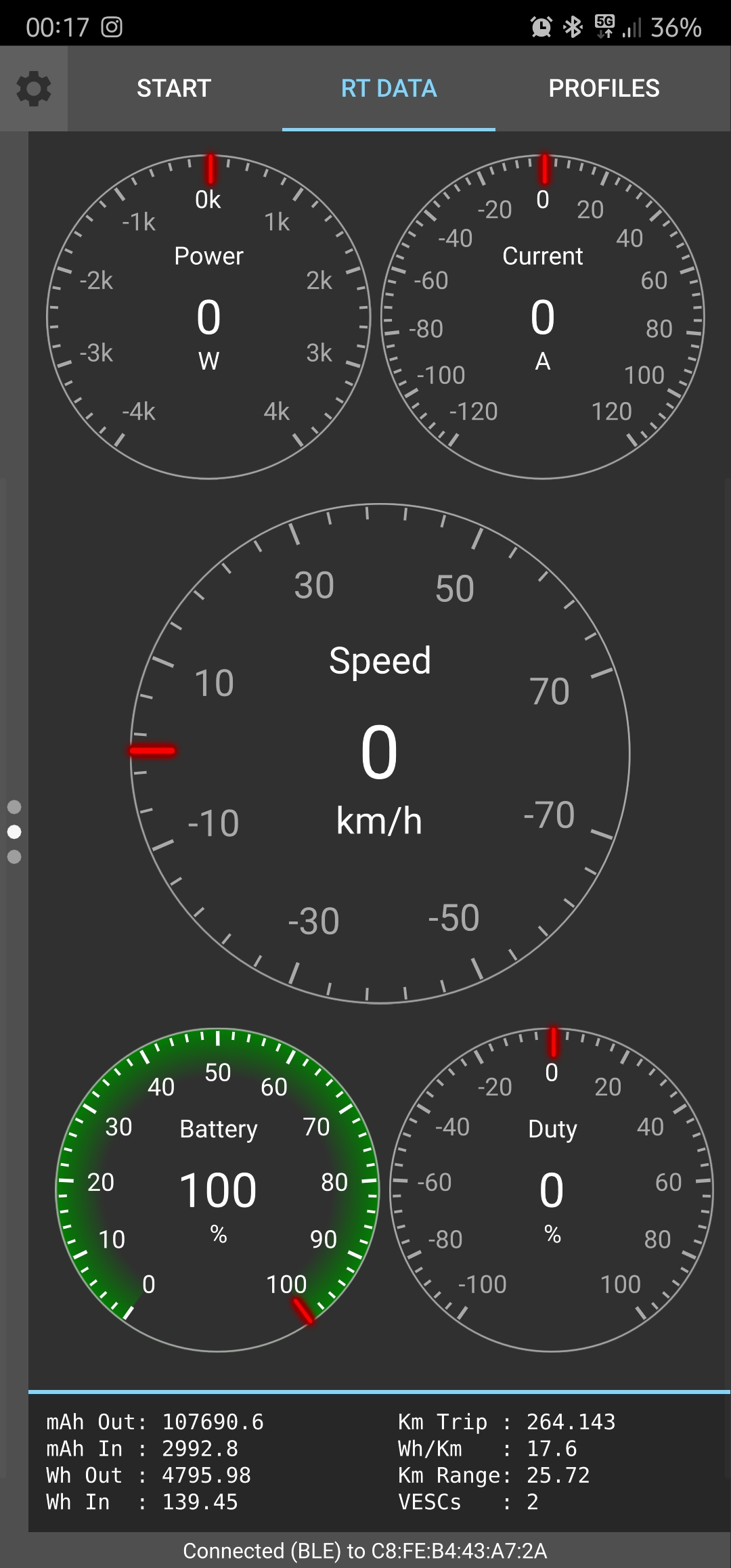

How many pneumatics last 500 km?
6x2’s do.
This is starting from 27 august
Had another 200km before, plus around 100 messing about with a underpowered battery.

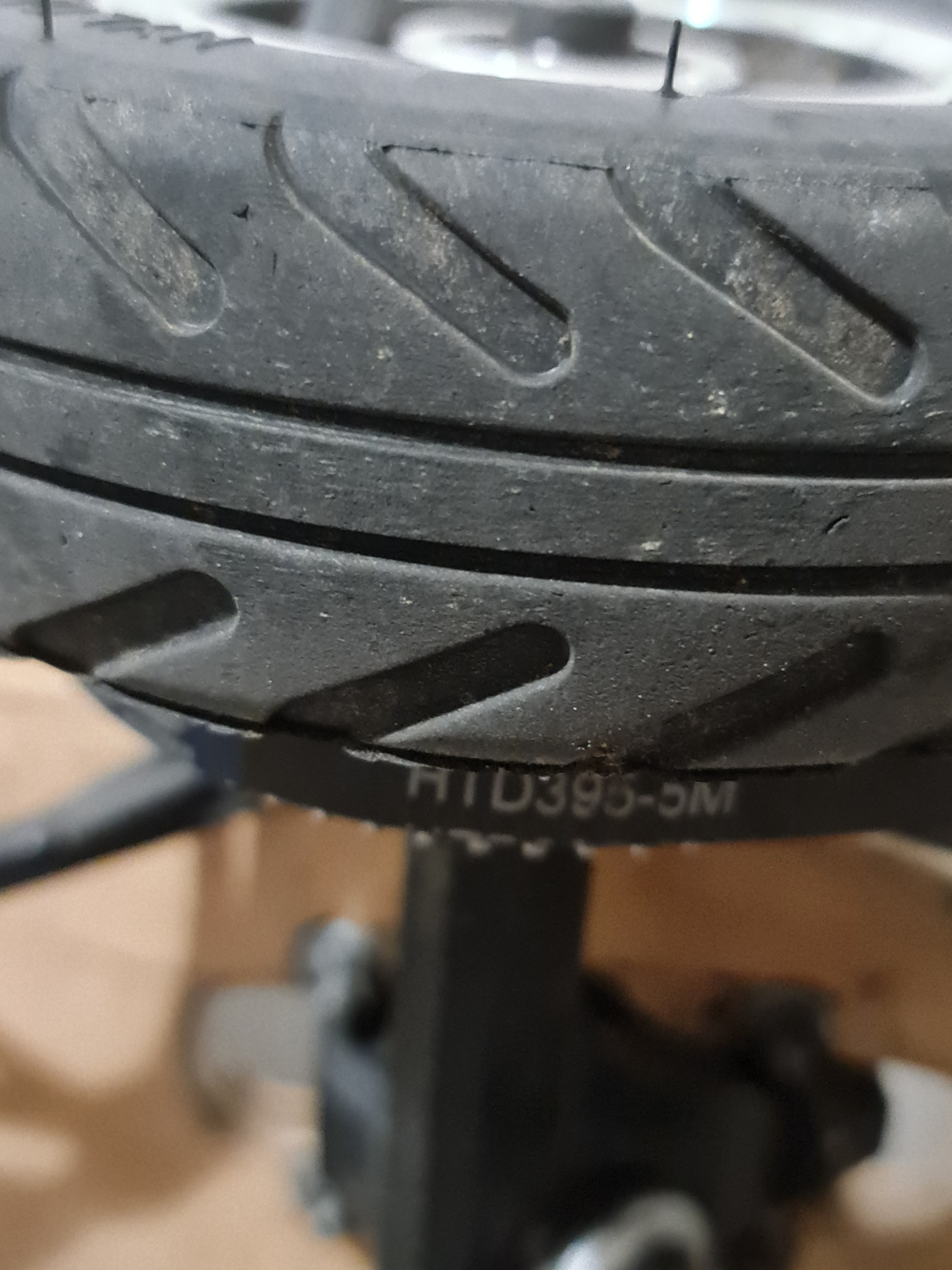

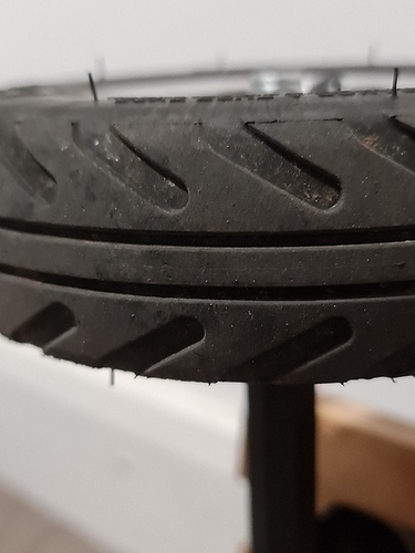

Rear:
Front:
Downside to these tyres is they’re wobbly as fuck. Had to use 35g of balancing weights on one of them, other took only 5g
Also, they’re dirt cheap to replace. $3 a tube, $5 a tyre from where i buy, others found even cheaper.
They’re the china of tyres, but they work i guess

The biggest issue with gummies is they can separate from the hub slightly at higher speeds. Are you thinking of incorporating some sort of lock or anti-stretching system into your hubs or urethane?

Yes, they will be locked with the hub. Plus separated like the other experiment did
