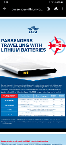

If you are traveling within the US then the TSA rules technically allow you to bring one 300WH or two 160 WH batteries per traveler. So if you are not traveling alone. you could get most places with more than one XR battery. That’s assuming that individual airlines don’t have more restrictive rules than TSA. But even if they do, its security that checkes the bags not the airlines. From what I’ve seen security does not look up the rules of the airline that is on your ticket, they just apply TSA rules.
Having the travel batteries as an option is nice if you are traveling on a charter flight or traveling outside the US. If you are sneaky you can always swap the guts of an XR into an SR or just swap stickers.
An esk8 does technically aid in mobility soo…
https://www.ecfr.gov/cgi-bin/retrieveECFR?gp=1&SID=bba5ad06518b529c94e1d67a3270196b&ty=HTML&h=L&r=SECTION&n=49y2.1.1.3.12.1.25.5
According to the FAA regulation, the 300wh limit rule applies to “A wheelchair or other mobility aid equipped with a lithium ion battery ”. So, I guess it does apply to electric skateboards.
It looks like the 300wh rules doesn’t apply to international travel.
Man there is a tonne of contradictory info on batteries from TSA, FAA and Airlines. Also poorly written and vague.

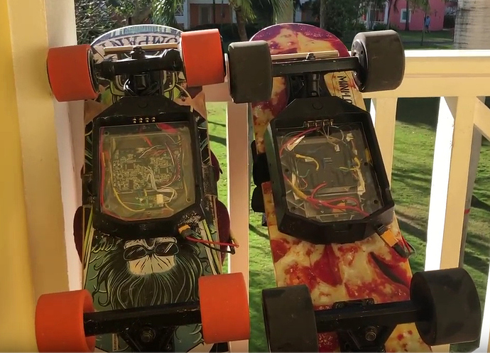

One year I really wanted to take electric skateboards to club med. So I hollowed out two old landwheel batteires and filled them with 9 volt duracells. They powered one V2 and one V4 Landwheel well enough to spin the wheels at security. Since there are no limits on the number of alkaline batteries, there was nothing to stop me from taking the drives with me --my eletric skateboards were not lithium powered – they were was alkeline powered.
Then I brought four 18 volt drill batteries with me and a work light. Powertool batteries are specifically allowed (under 160 wh).
That allowed me to bring two landwheel V2 drives and 200 WH of power per drive when I connected two 18 volt drives in series.
I was going to extremes to get through security, but the canadian charter flights have very restritive language concerning electric skateboard. No lithium powered small vehicles whatsoever.
