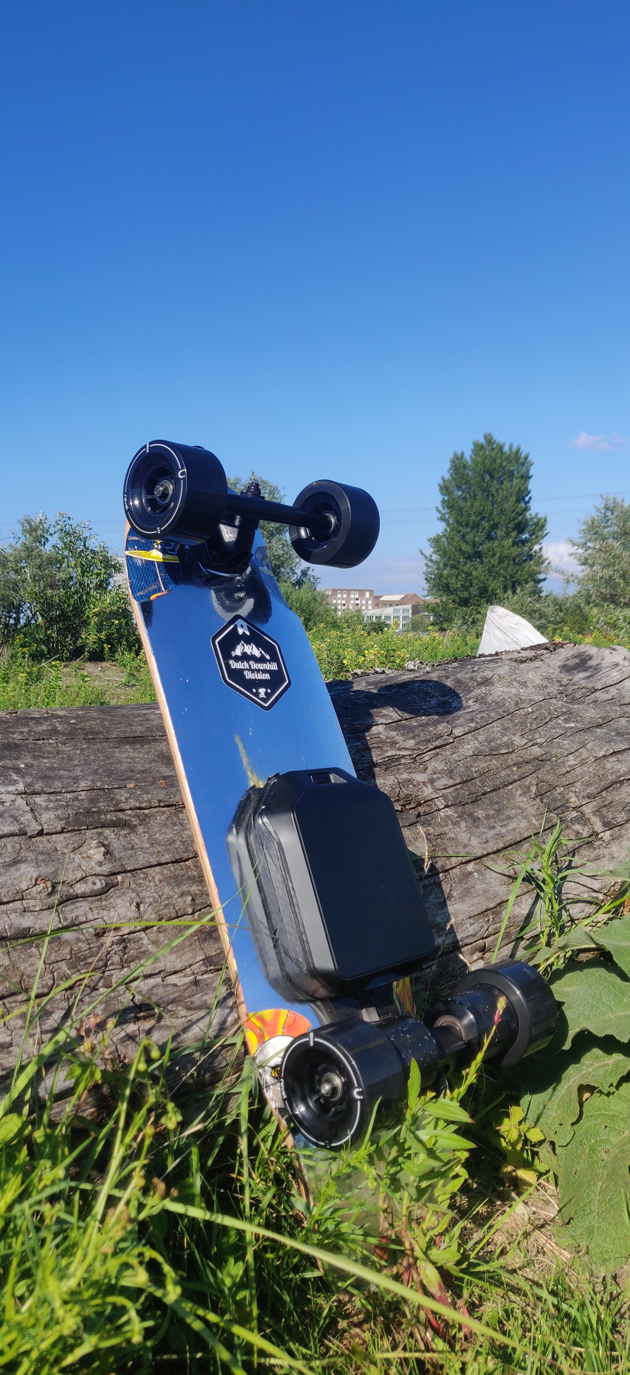

Revel at the "brand" new competitor in the direct drive Esk8 race!
Is that a loaded deck with red boa wheels? If so we have almost identical set ups minus the shred lights
No it was a custom deck with a personal graphic from skateshred.com with Senor Pepe 90mm wheels from haggyboard.com. I was unfortunate to get the red boas I still want them but I will wait for them to be back in stock.
