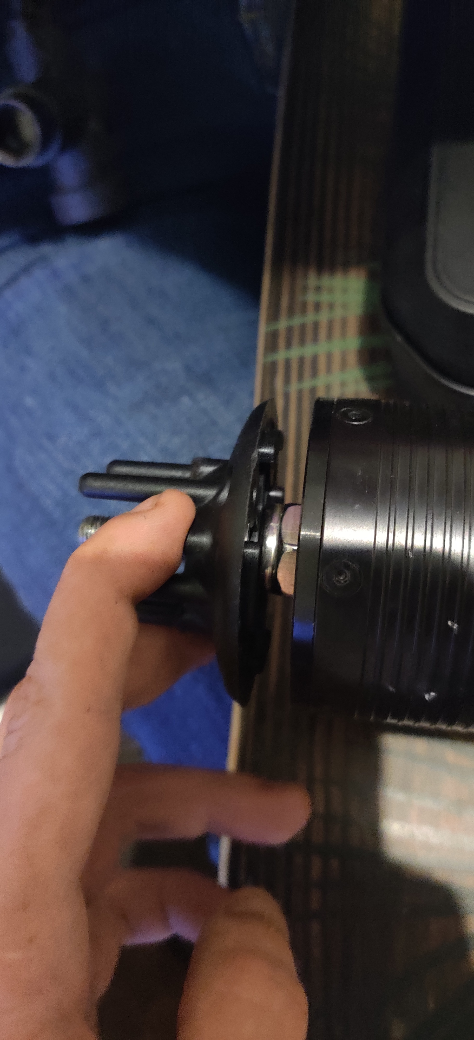

Hi there, do you know how to chage rhe revel kit adapter to the orangatang? The nut on the axel stops the adapter from being able to sit in properly
I have a question about the revel kit : is it waterproof ? Like let’s say an Exway X1-pro with hubs ? I need a board for rain, and I’d like to be able to try Harfang wheels on it, wich the hubs can’t …
Orangatangs mean the Kegel Core adapter. Remove the 4 small screws to be able to remove the existing Abec Core adapter. Replace the 4 small screws - and you’re done - its in the manual i think

Holes are different sizes, so it doesnt go over the nut, abec adapter fits on great tho
Looks like revel factory supplied you with the wrong adapter dude… get in touch with them
@Sharneaustin
Picture is worth a thousand words. The latest production run has new larger motors. The kegel adapters you are holding look like they might fit the first and second production run. That’s unfortunate. Email Flo and he should help you out.
No chance you mixed them up with another project eh? The adapter you are holding came straight out of the Revel kit box? Sorry for asking.
Yea, this is my first direct drive board, only had hub boards in the past, so havnt got any other adapters in the house lol
If you cant wait for the replacements to arrive, wonder what happens if you drill the hole bigger to fit - no guarantees on the structural integrity though… get the replacements set to deliver first before attempting this
Yea, i was thinking that might be my only option. At least abec fits well and wheels provided are very decent
