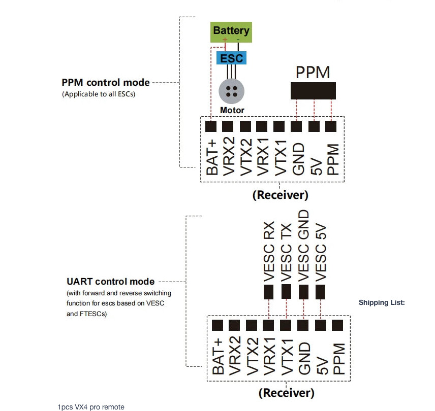

@Adamvos , we have three Stormcore 2.0s running in our group now. So far they have all been performing well, no overheating, no cutouts or other major BS. There’s one little problem common to all three boards that I can’t figure out.
All three builds are using a VX4 Pro remote in UART mode. Two are 18s boards, one is 12s. For some reason the remote will vibrate once in awhile and say that the board battery is too low. This happens when accelerating and when braking regardless of actual battery level. It doesn’t happen when the remote is idle but still paired to the board. I can not make a condition that forces it to happen, it seems to be a random occurrence but happens multiple times on every ride.
These remotes and receivers only do this when hooked up to the Stormcore. It’s not a huge deal, the remote remains connected the whole time, but it is kind of alarming when you’re focused on riding and the remote starts vibrating.
Any ideas how to get rid of this problem?
Have you done an AB test with another remote to eliminate the input as the problem?
I have, but only with other VX4 Pro remotes. I’ve also switched the remotes in question to other builds and did not have this issue. No other types of remote laying around right now but can try it with the GB remote once that’s available.
Seems like a remote issue to me. If that low voltage alarm was ‘true’ then you would have had a cutout of some other issue you could feel as the rider.
Yeah I would have met the dirt by now for sure. It’s definitely not cutting out. What is confusing me is that the remotes only do this when paired with the Stormcore 2.0.
This is basic and not meant as a dig, but you’re setting the cell count in the remote settings right.
No offense taken. I’m hoping it is something basic that I missed, but yeah the series counts are set at the right values.
Since it seems to happen only during acceleration/regen, I wonder if the Stormcore 2.0 is picking up noise that is too fast to trigger a fault for the esc, but the raw streamed data to the remote has data points that are above/below HVP/LVP.
That could make sense, it only happens for a split second, you wouldn’t be able to read the warning on the remote if you didn’t already know what it says.
do you have any kinda telemetry logging you could zoom in and see if the uart data collected sees the drops/spikes outsize of vx4 alarm ranges.
tho you’d be watching a separate uart stream.. and I think the data is collected via polling. and the telemetry device vs vx4 may have different polling intervals. still, if the telemetry logger sees something.. it would prove @A-damW’s theory.
Also I assume hooked up in Uart means you didn’t hook up battery+ on the receiver. otherwise it might be reading battery another way. (no docs on what it does if you hookup both uart and bat+)
