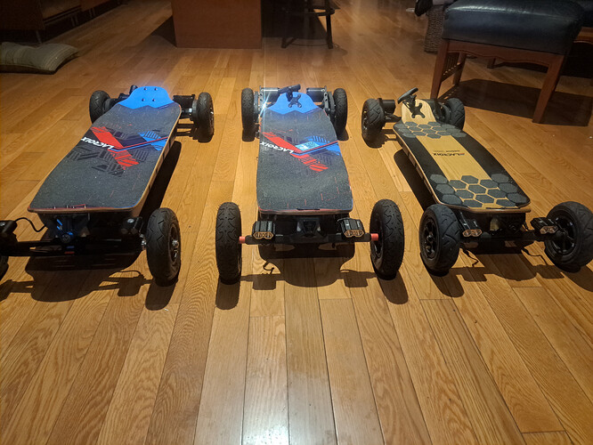

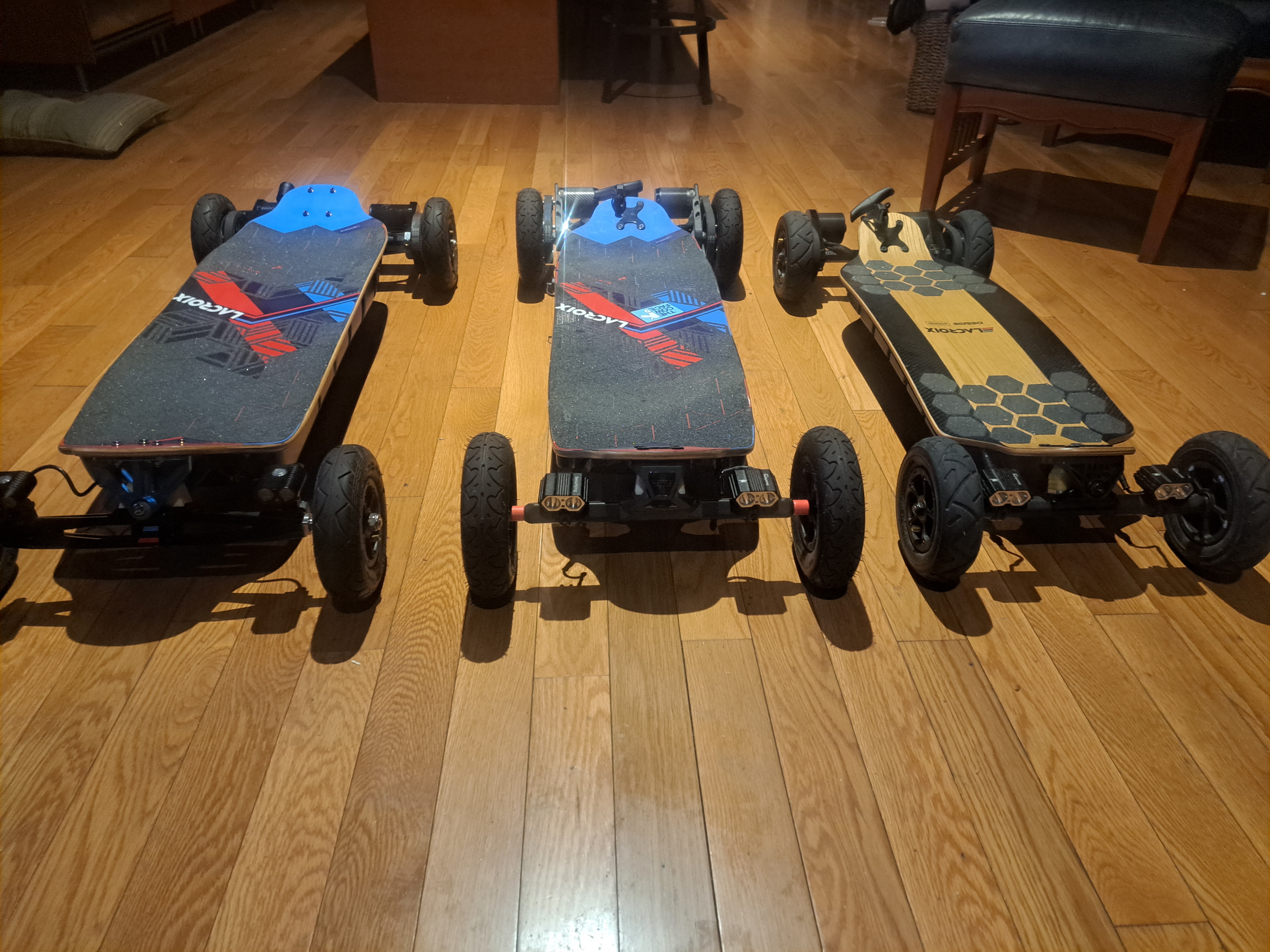

I have 3 Lacroix Boards.
I consider the Prototipo to be a classic. It’s not the fastest, longest range board, but it has an amazing feel and ride quality - and it is simply beautiful to look at. I love the natural wood and carbon fiber mix.
The Nazare 12S6P is the board I ride the most. I can literally fall asleep while riding it. It is so predictable, stable, and smooth. Definitely one of my favorite decks ever.
I also have a Lonestar. I use this board for really long distance rides and adventure (exploring the city and suburbs). However, it is too heavy for being a daily commuter. It is also higher off the ground than the Nazare due to the bigger battery stack. I like the Nazare better than the Lonestar for this reason.
Lacroix built things to last and they certainly didn’t cut any corners in the production of these boards. I hope you can keep that trend alive at reasonable price points.

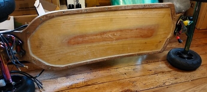

I didn’t know the prototipo was rare. I gave mine a ravaging with a belt sander and threw a bunch of epoxy, glass and oak at it to double stack it with 18650’s. Got 12S10P in there and still has nice flex. Never rode it prior, picked it up used with a dead battery.
It counts as extra space needed in your rubbish bin!
Well, yeah it rides like garbage actually.
I bought that used with a dead BMS for less than a focbox was worth. Watched a bunch of videos about how awesome it was and decided to fix it.
It’s not awesome, at least I got to find out how and why they didn’t make bank.
