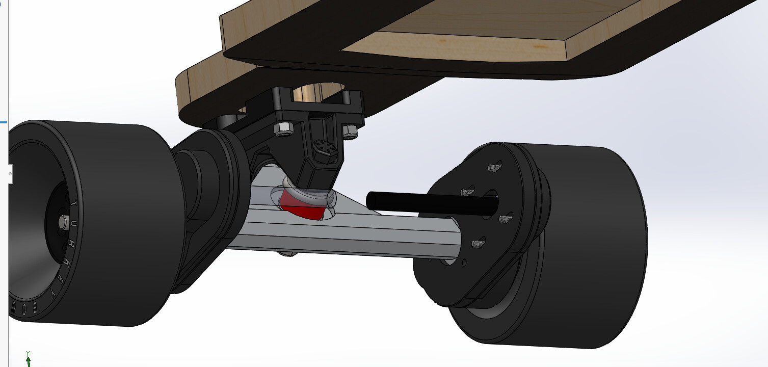

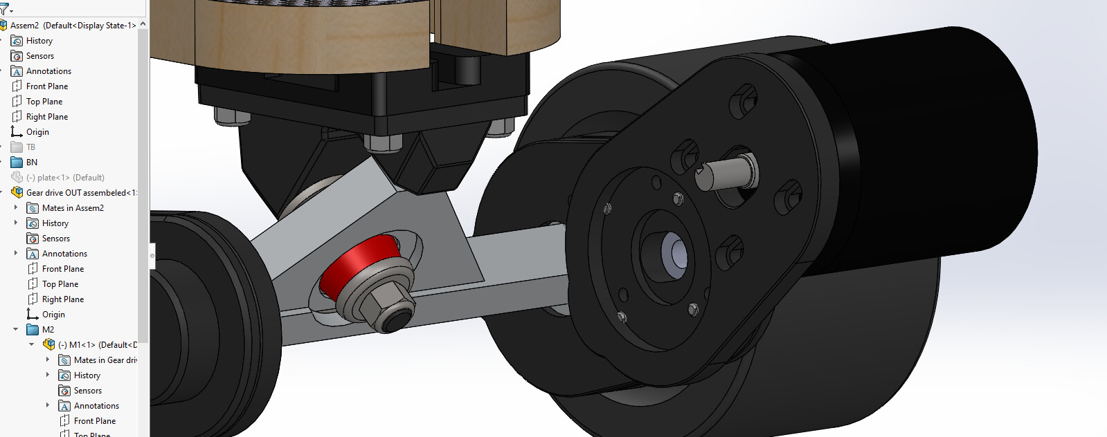

haha but belts and pulleys are pretty reliable. get a higher gear reduction with a jackshaft. better efficiency and more torque with small motor. i wouldnt bother drawing it if someone had made it but havent seen it yet
I can shoot you the models of the BN M1 gears made into a two stage.
i dont know what the bn m1 gears are but send it over.
I think it would be best if you designed something like a fake motor that actually was a further reduction.
just a gearbox with a 44mm bolt pattern and 8mm keyed output shaft.
wheres the hanger go?
If you outward mount there is a lot more room but it might be possible to inward mount the double drivebox
Inward mount for the win
Mounting outward seems like a cop out LoL.z
dangnnit I just finishes my masterpiece
