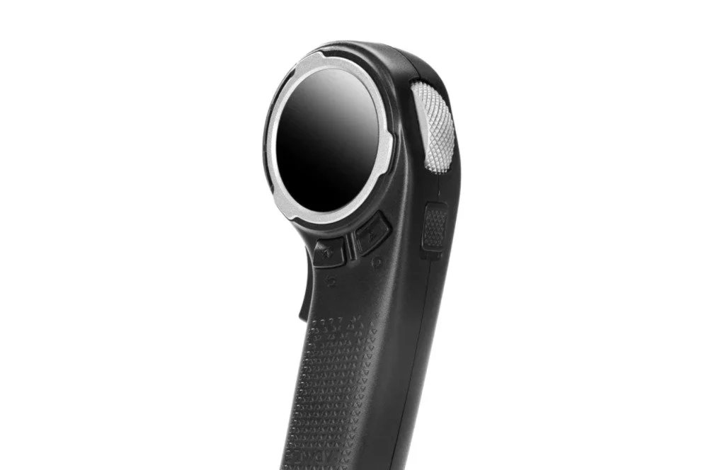

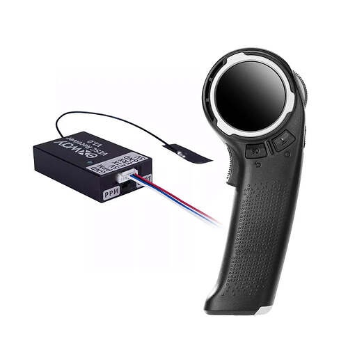

Yes it is the exway remote check here 2025 remote recommendation

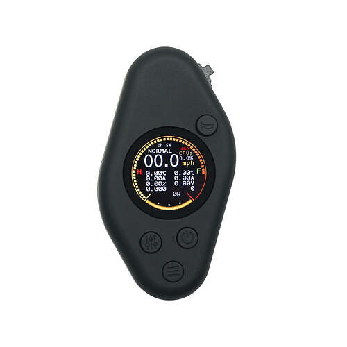

Plus there is this brand new esk8 remote but i haven’t tested it GB remote lite - VESC compatible – GB engineering
