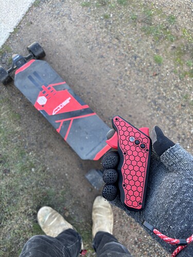

What camera setup is that :eyes:
lmao my pixel 9
Thought you were wearing rayban or some form of glasses with camera
Seems like a GT2B it is :sweat_smile:

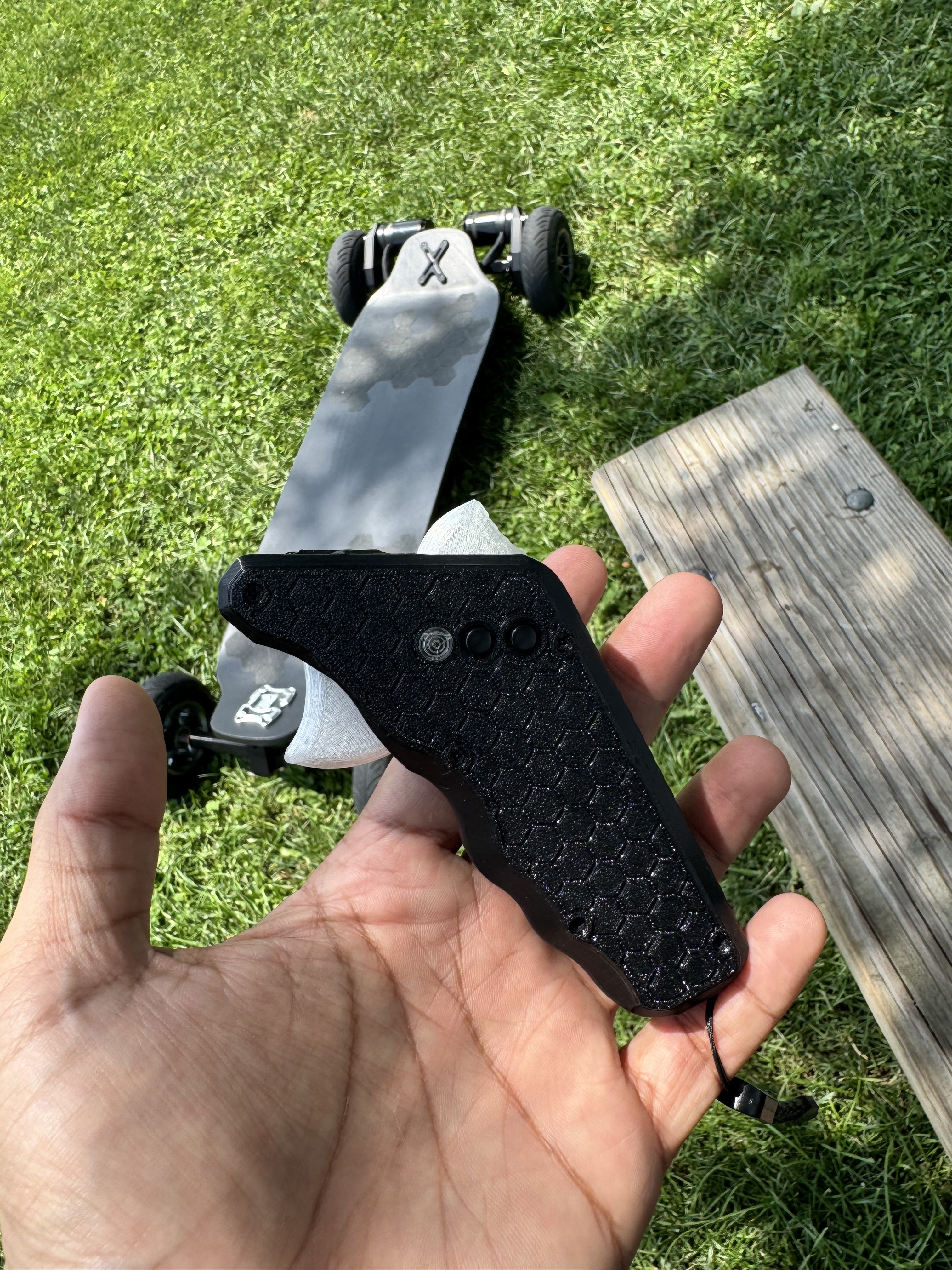

Ordered one from AliExpress and will print a mad munkey case
Z.Mote for the win
this is a nice mod for that remote.
