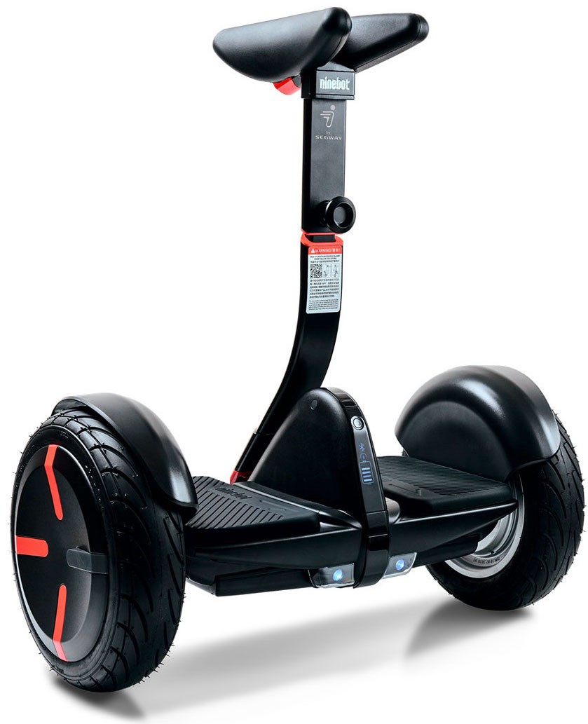

Wait, did they make one for onewheel ish builds : https://www.aliexpress.com/item/33050869219.html?spm=a2g0o.detail.1000013.1.121d58c73vtUIG&gps-id=pcDetailBottomMoreThisSeller&scm=1007.13339.128609.0&scm_id=1007.13339.128609.0&scm-url=1007.13339.128609.0&pvid=a0b197db-3d3b-4d45-9e33-05f65ea010ac&_t=gps-id:pcDetailBottomMoreThisSeller,scm-url:1007.13339.128609.0,pvid:a0b197db-3d3b-4d45-9e33-05f65ea010ac,tpp_buckets:668%230%23131923%2314_668%23808%234093%23837_668%23888%233325%2313_668%232846%238108%23145_668%232717%237560%23228
i’m not sure what they mean by self balance scooters
They mean these things
With an 11" wheel?
Maybe
:man_shrugging:
