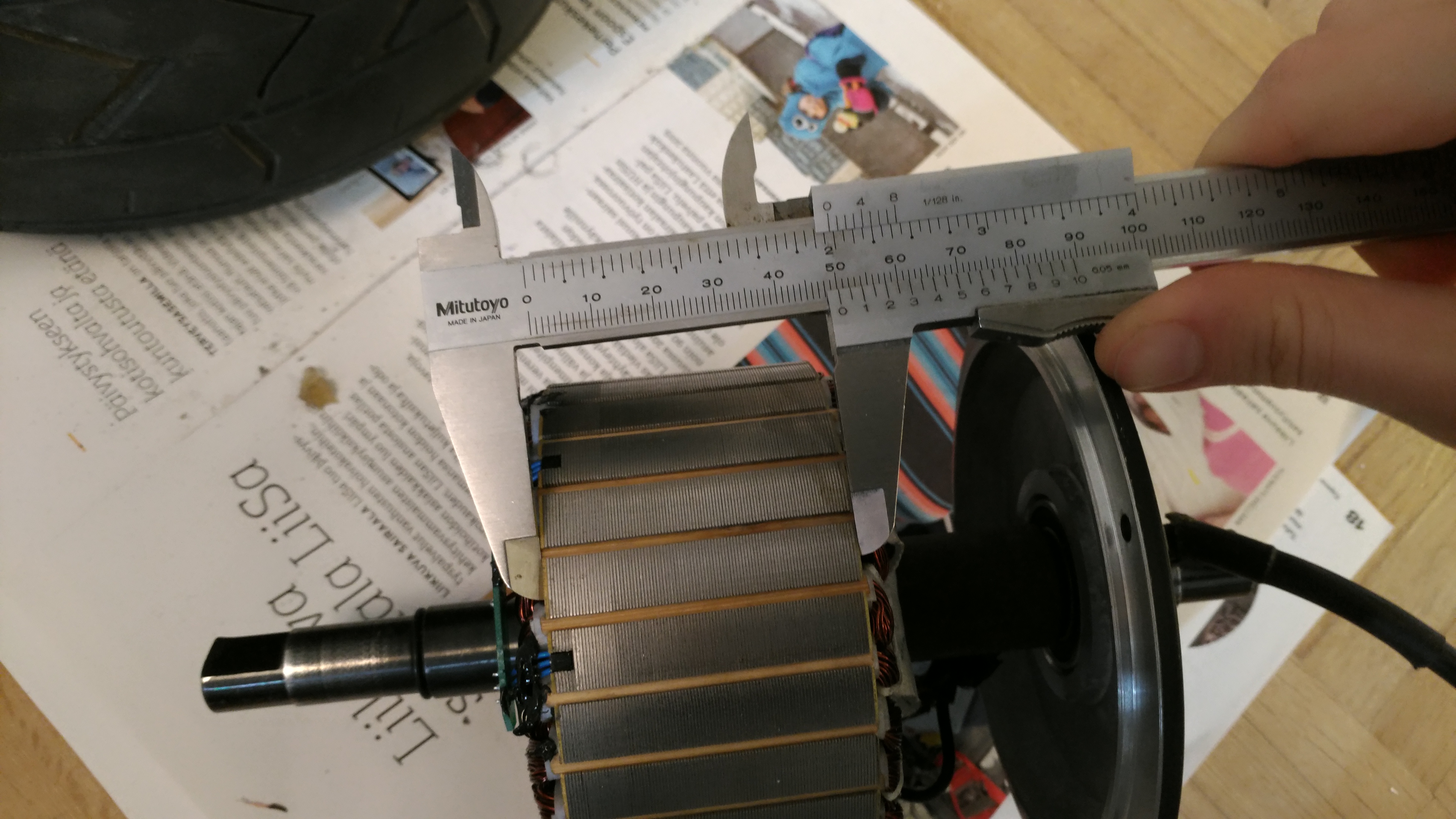

Any chance of you opening up the 800W? I’d be really interested to see how much longer the stator is!
Just to add in case you end up doing it, this right here is where the windings meet, this needs to be opened up and the three bundles connected to the incoming phase wires
I used some 10 gauge wire to wrap around the solder inside those protective tubes where the incoming phase wires are soldered to the other ends of the bundles.

I’ve ordered a phub-188 48V 800W and will definitely open it up to measure and photo. I also have a phub-144 48V 600W coming as well. Ordered the 144 as it uses a 6" tire like the actual Onewheel and there are a lot of tire options for the 6" whereas I can’t seem to find any 5.5" tires other than from Pei. Would be nice to find some more 5.5" tire options.
EDIT: Decided to see what if there is a listed rim diameter for the phub-188 and Pei lists it as 150mm which in imperial comes out to 5.9". Not sure where they measure from whether it is the diameter at the bead mount or the diameter of the lip of the rim. If the actual diameter is closer to 6", might be able to fit a 6" tire. Just happen to have a Burris 11x6-6 treaded tire coming. So whenever the phub-188 comes in, will try to mount the 6" tire to it.
