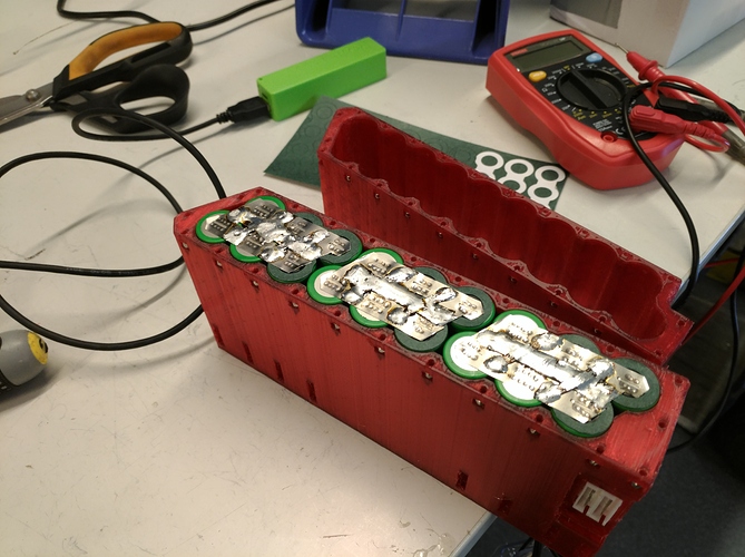

Also made a much more powerful 12s3p battery pack with VTC6 cells to get some more speed and allow for more motor current at high speed.
The thing is absolutely packed with cells, and has no space for the usual Daly BMS. Since the flexiBMS is not yet available I had to substitute with this 6€ thing, but turns out it doesn’t actually balance the battery, only cuts if the voltages get too high or low…
bms
For now I’ll use the balance connectors on the new pack to occasionally check that it’s not drifting, and this “bms” (bypassed) is there to cut charging if that’s the case. Clumsy, but should do until I sort out the BMS situation.

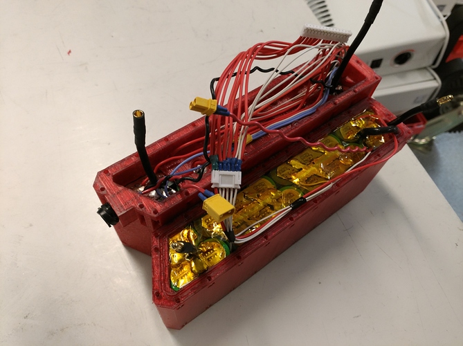

The pack is built in the same way as the previous one, but with space for connectors and BMS used to pack in more cells. I pre-soldered some copper braids to the nickel strip to beef them up before welding them in.
With the two sets of balancing wires (bms + external) and some connectors for disassembly the pack was an absolute pain to put together
Had to temporarily glue wires in the place to prevent “wire pressure” from pushing them outside their channel. BMS fits just barely in there…
But it went together! Next is to do some load tests with the scooter so I know the connections are good before I trust it in Redstar.
