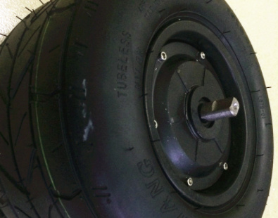

That wasn’t a PeiPei motor, that’s the Fungineers motor
Different in name only.
and shaft length and termination I hear
Really? It doesn’t make sense for slow speed motors like this be anything else than wye terminated :thinking: It would be interesting to know where these motors really come from. I managed to convince Peipei to make a custom shaft for mine so I can’t comment on that.
lol sorry I actually meant axle termination like it has custom end for locking into the rail mounts. By termination could have also just meant the connectors think they might not have the useless ones peipei has.
Yeah, could be that. Although the stock Peipei does look similar to the Fungineers one, just has the nuts screwed onto the threads, there’s the flat cutouts visible:
Fungineers version:
Mine is a bit odd, it’s 14mm diameter with the cutouts to 10mm with the axle itself thicker than that.
Stock flat Peipei has (atleast in the photos I find) a thinner axle but with the same non-threaded flat ends. Those must have different bearings that the ones on mine and Fungineers.
