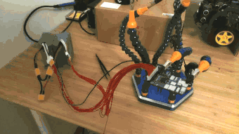

Long time with little progress, I have been distracted by the flying diy-things and riding what I have now :grin: Nearing 400 km on the Redstar.
BMS board powers up and runs off battery, this is the second unit. First one killed it’s CPU for some reason, perhaps the high voltage lines are close enough to it that palming the board while it runs could kill it. I’ll use some conformal coating just in case.
20200818_234114
Now to do the actual BMS software.
