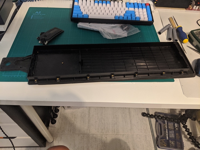

I still have a raptor enclosure for sale sittin in spain. Shipping although is around 30€ alone inside the EU (due to size)
