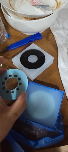

Don’t worry I’ve made sure the mold is a tad bit smaller for the wheels, since I’ve measured mine with a caliper the hub size is 69.50mm I’ve made sure that the mold OD is 69.45. I’m hoping that the wheel would be a tight fit. All else aside im looking at my damaged BMS it was just covered in burnt powder. Not sure but I’m going to order a replacement antispark switch to test a theory. A fellow member is willing to sell me the etray. I know I’m going to buy it from him. But I need to test some things out.
I’m currently reverse engineer this whole etray and put together a non enertion Etray. Found a local that deals with CNC.
Oh and an update xD I got my inner wheel lip in and will be able to cast it soon.
there’s going to be a couple prep work to do smoothing and sanding the printed part to get a good cast and such.
As you can see from these few images the lip fits perfectly and the inner axle pin will fit just fine
What ki d of BMS is this? This is the original Enertion 2 BMS and its hella small.
I’ve done smd soldering and made a few 2 layer pcb back when RadioShack was the go to shop. I might be able to design to come up with a replica.
I have all the parts you mention in your last posts - PM me. also curious if your anti-spark theory is the same as mine :stuck_out_tongue:
So my tables a mess and im working on the inner lip just casted and waiting for it to cure. Ill post a few pictures also. Just cracked out the PU Resin 85A to test it out see if my dyes work so its sitting in the vacuum chamber. I’m using one of those mini oreo grab to go cups, and using the cap as a temp mold to see if the rubber is as advertised. Just waiting on my mold to be finished.
So the one that I held the inner lip is casted in resin. Also the one in the steel can is the PU rubber.
My enertion as you may know its out of commission atm got the Maker X Dual Retro coming in soon I hope. Thanks to one of the member here sold me on the Maker X so right now, I’m gonna stress test the PU disc that I just casted have to be 10-12 hour of full cure time. So I’m gonna do this the easy way Frisbee style with the nephews xD. Im going to see if it holds out really well.
