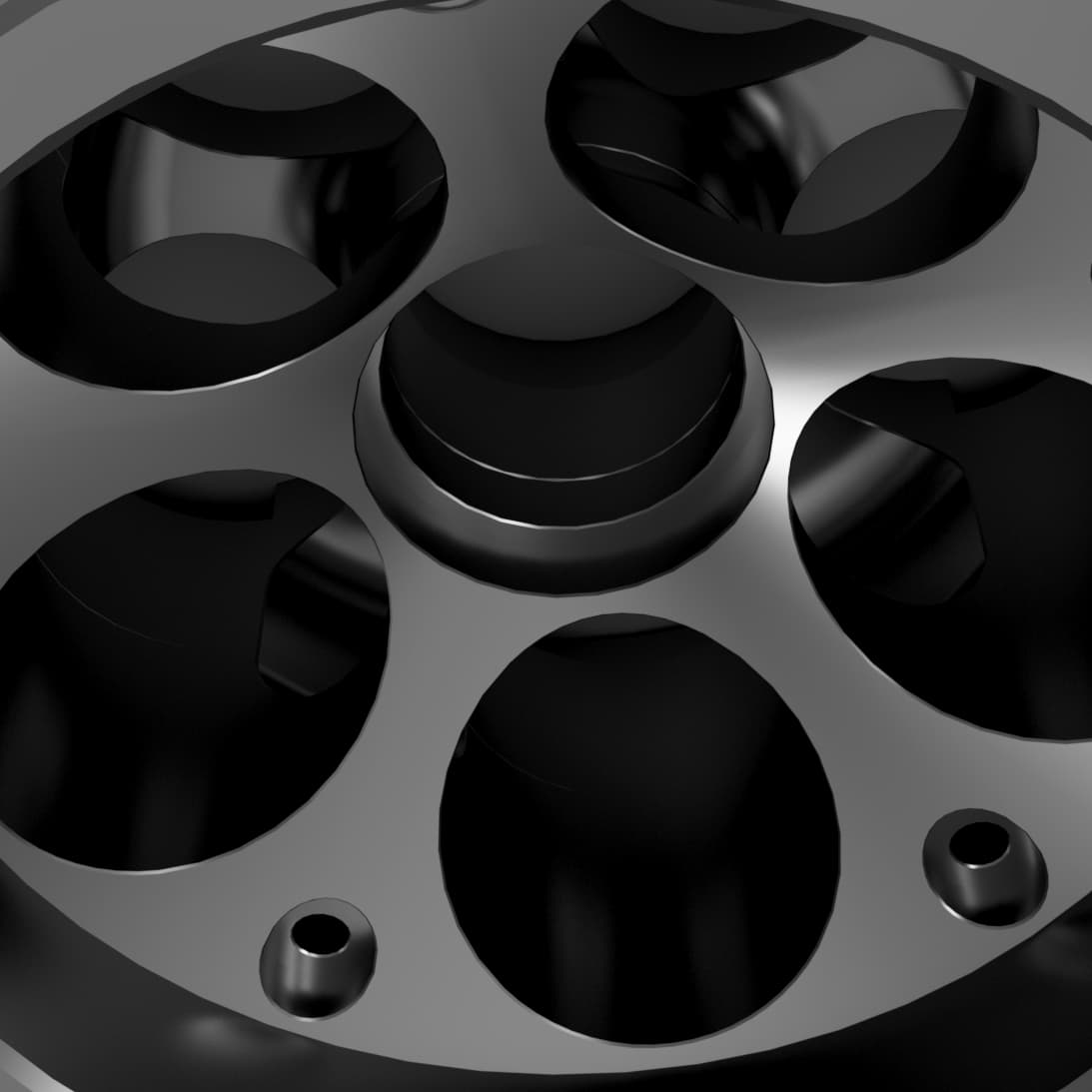

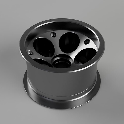

Lastly for now, I am personally working on wheels that have the look I think is desperately needed. I really love Rotiform wheels and they make some of the best wheels in the world, so taking inspiration from their DIA wheel;
enter the RX hub:

Those hubs look so good too :fire:
Cool! I’m liking those rims lol.

Whoohoo awesome dude, can’t wati for those RX hubs :smiling_imp:

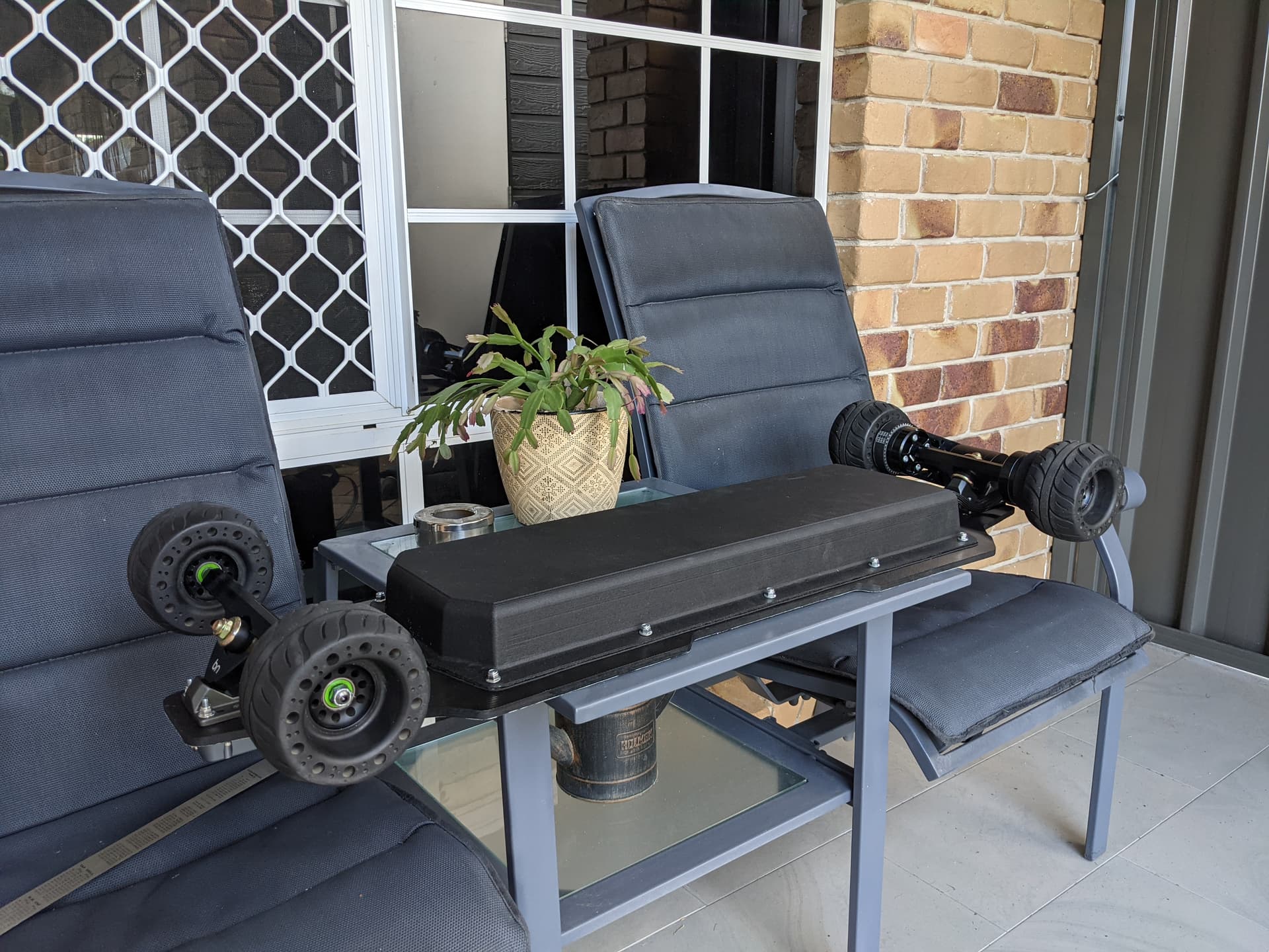

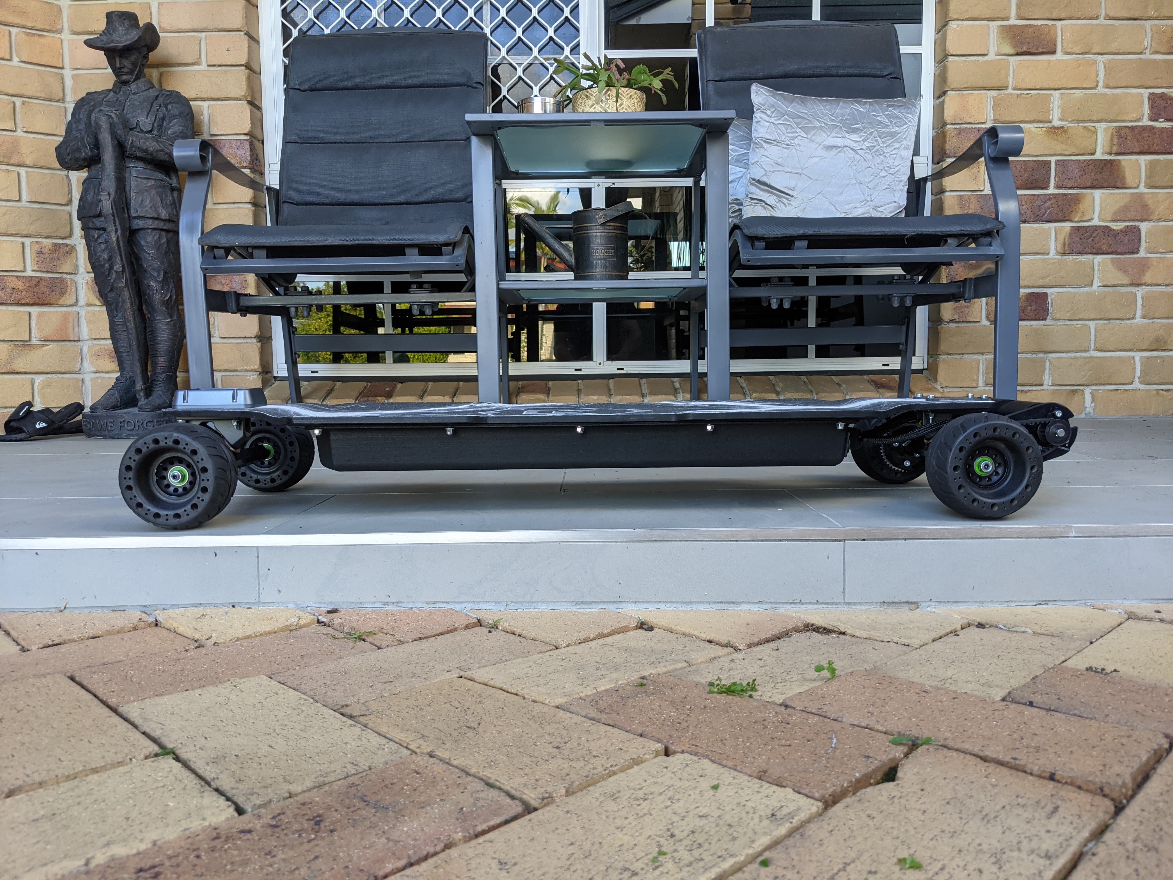

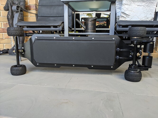

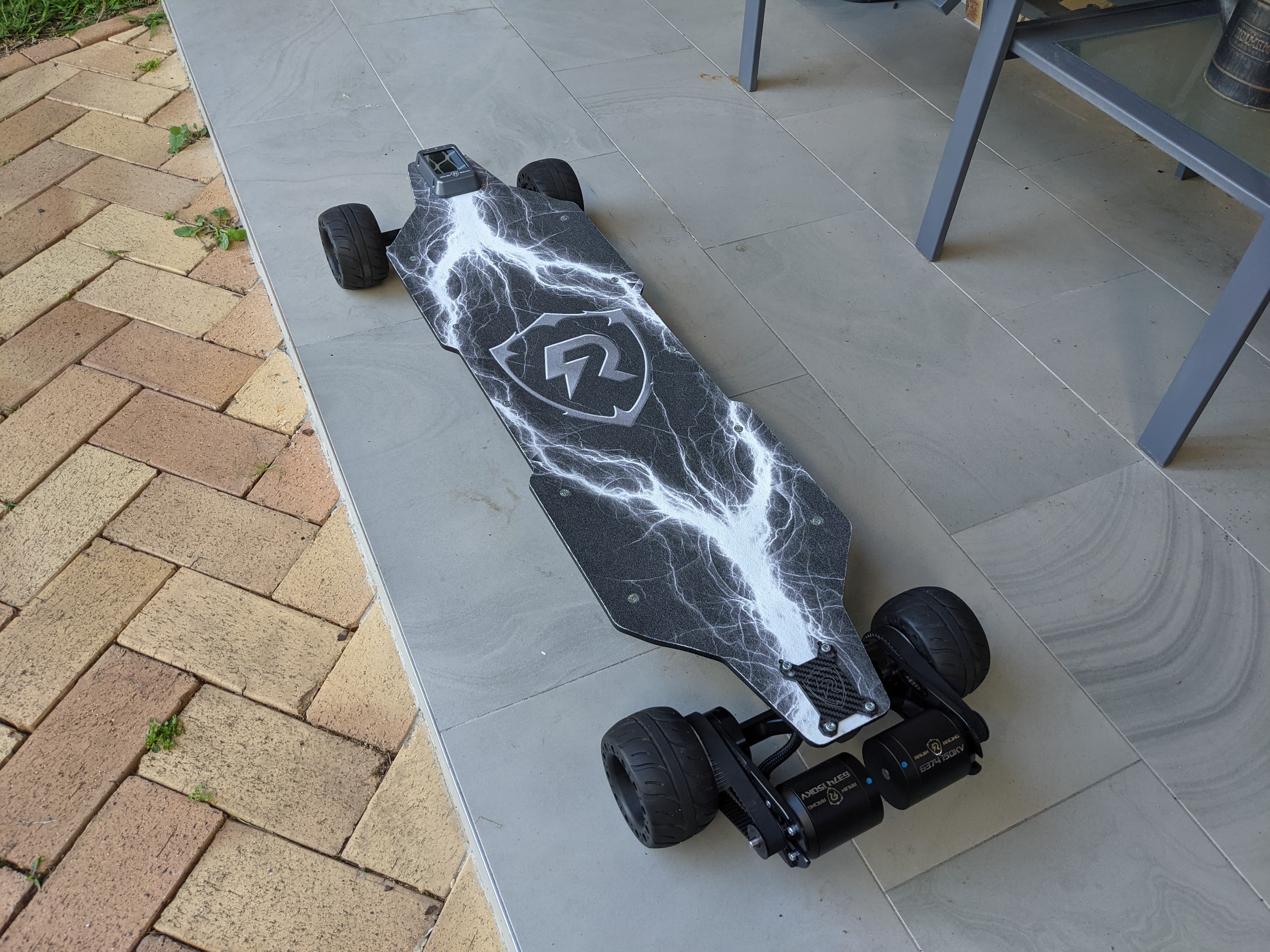

First build in the lineup, the Senshi (meaning soldier). Set to do about 60km/h top speed, and 9kw for short spikes. About 10,000 no-load rpm. Split angle 50/44, until boardnamics releases his fixed baseplates that will make the gap larger and even more stable. Using caliber plug bushings from venom which are low rebound as stock, with upgrades to riptides WFB formula for ultimate stability against bump steer and a lot of lean for good cornering. 16s3p 21700, using 16s6a charging so full charge is around 2 hours. More aimed at commuting, with a bit of fun weekend racing/car park sessions. Thank you to @eLDoska for all his help on the decks.
Edit: change that to 9kw motor potential and probably somewhere around 5-6kw realistically. Regardless should still be very powerful for the size and price. thank you @Battery_Mooch
Ok buddy :+1:
A bit boxy looking, but really clean! Nice offering :smiley:
67.2v at 135 amps, absolute max. What’s your point?
I do want to rate this properly, and I’m not using the motors to do that. So I’d appreciate just saying what you mean instead of sarcasm. :slightly_smiling_face:
Yeah it is a bit, it’s meant to be single stack but the mould isn’t ready. The enclosure can fit 16s6p, so even though it’s boxy its really functional for the size that it is
How are you pulling 135 amps from 3P :thinking:
Looking good! really like your griptape designs and nice touch with the custom Davega. I assume its a fully custom deck right? What is it made of?
Probably using Molicel P42A cells which can discharge 45A.
Quoting @Battery_Mooch here:
I am rating this Molicel at 30A continuous with a temperature-limited rating of 40A as long as you stop before the cell reaches 75°C.
I know he said bursts but that still sounds way too high.
Well if he puts a 16s6p in there then 9kW is pretty accurate :slight_smile:
Thank you! It’s made of fibreglass and basalt fibre
moochs testing is continuous though. I haven’t seen much actual data on peak bursts but the manufacturer rated it to 45a so that’s what I’m going with. I have seen close to the expected power in real world riding, but it’s theoretical because of voltage drop. I don’t really know how much the voltage drops instantaneously so I can’t accurately say exactly what the peak output is. Doing my best.
Ideally I’d like to have a dyno and do some real tests but I don’t have one, atleast not yet.
