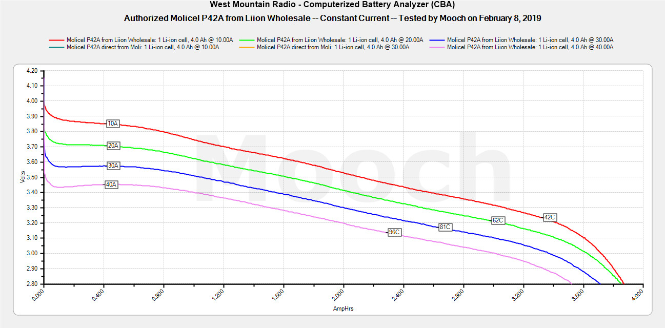

Okay thank you, I understand most of this. I guess my main question would be how much the voltage might sag under max load of 45a/cell for 3 seconds or so. Without knowing full pack resistance, this seems the best way to estimate the peak power output at full charge.
All the data sheets I’ve seen (in minutes) instantly drop to nominal voltage. Had to take something out of that
At 45A a new and freshly charged Molicel P42A will probably drop to about 3.35V-3.40V or so for the first 3 second pulse. Of course that will rapidly drop as the cell discharges (from just cruising) and as the cell ages over time.

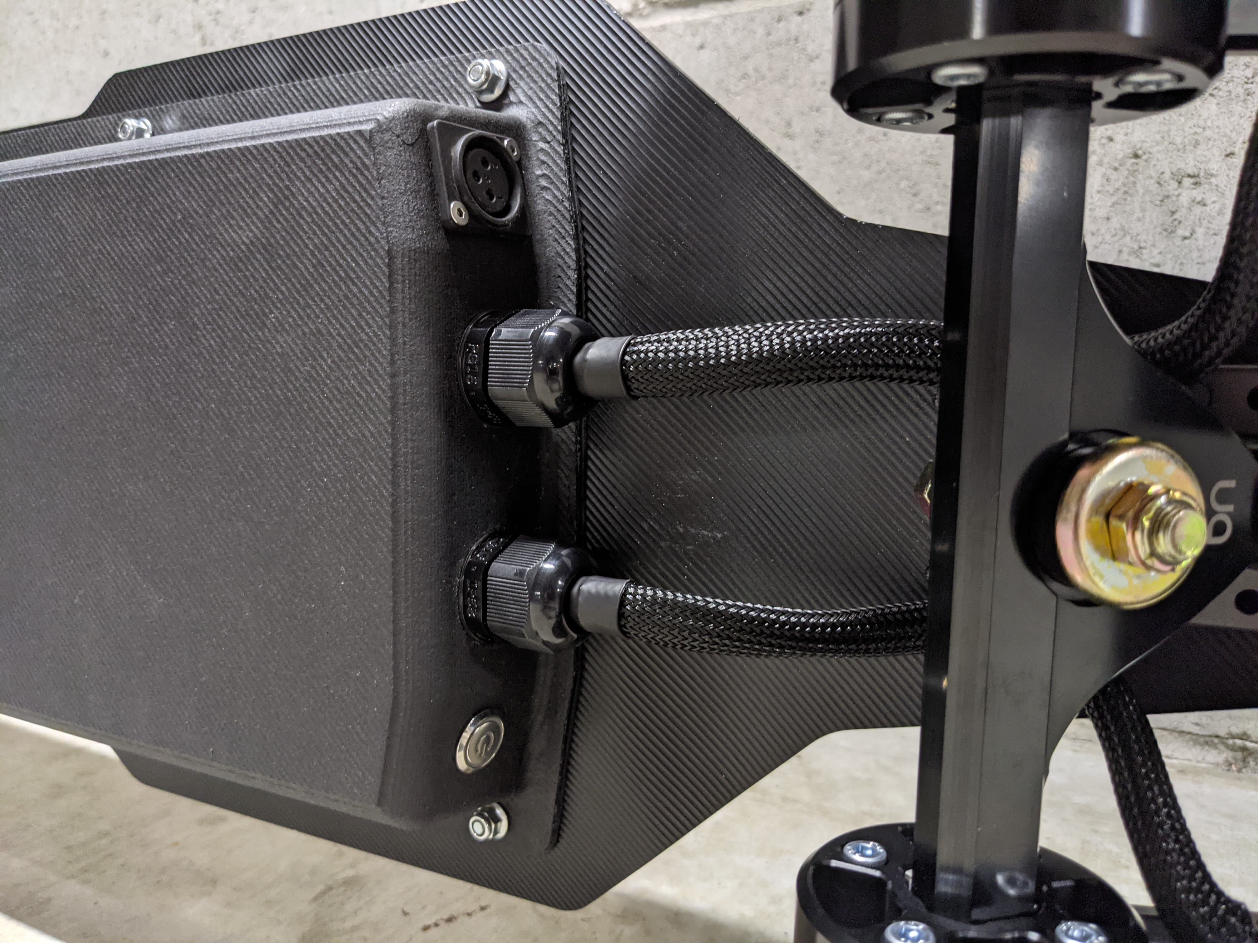

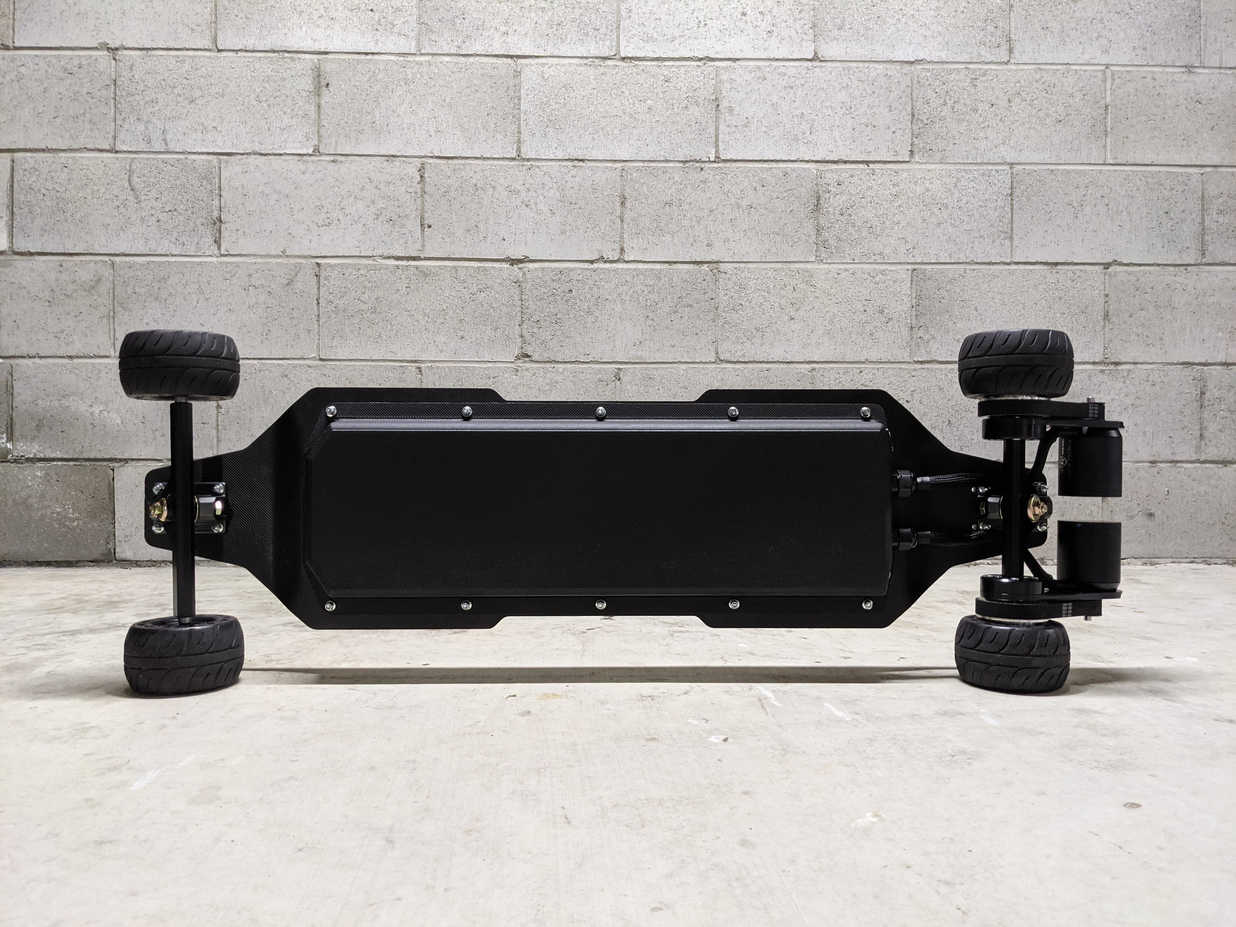

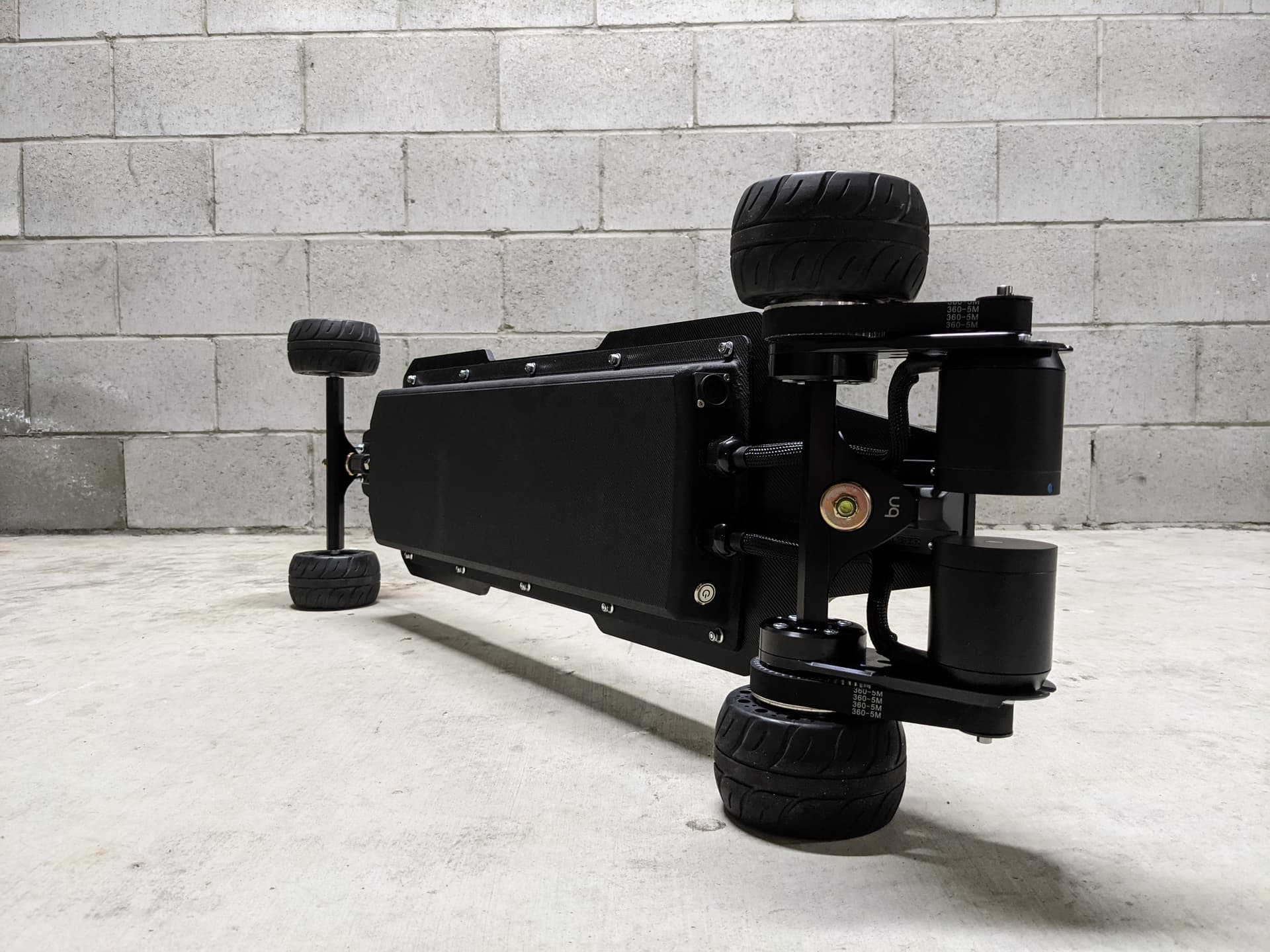

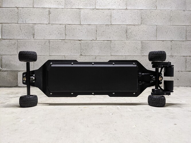

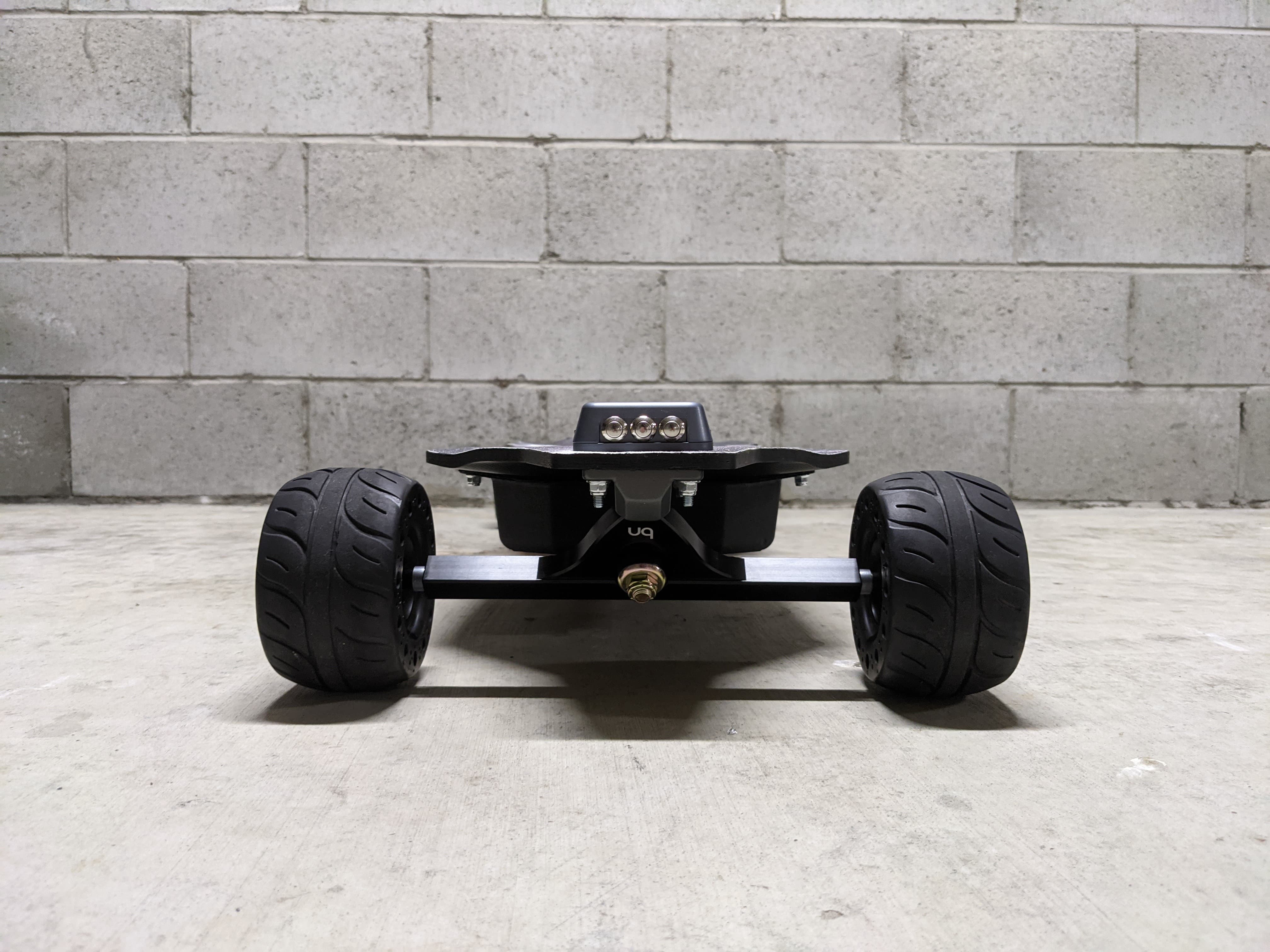

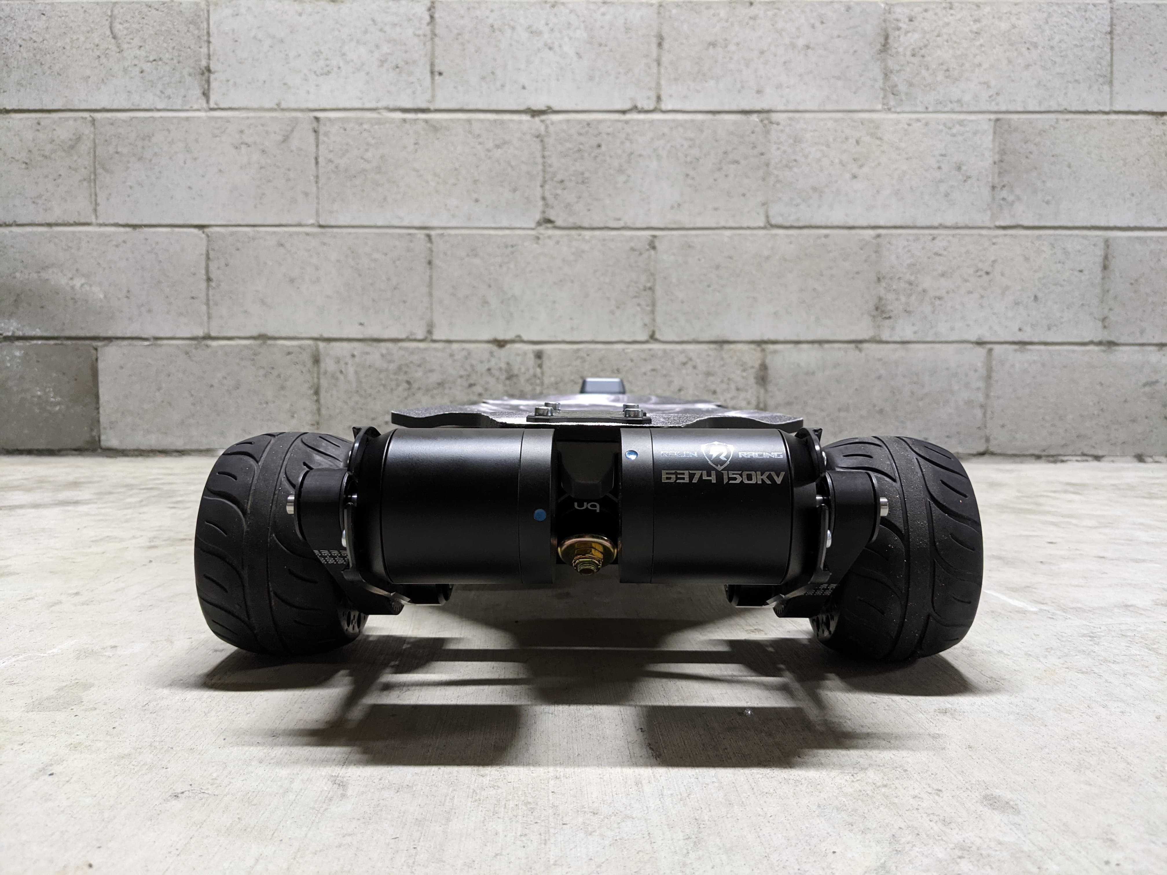

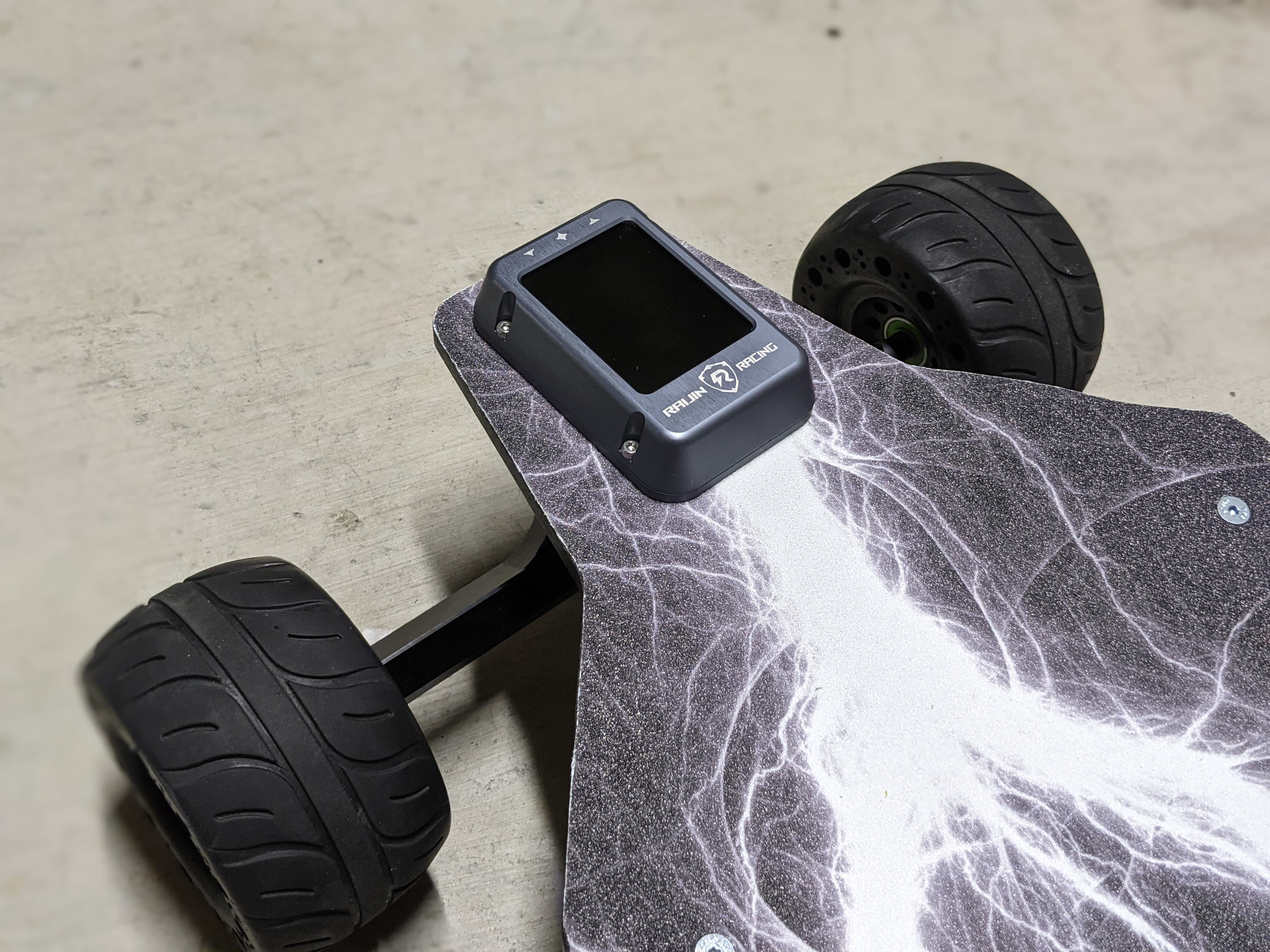

Proper photoshoot, tried to optimise how things line up best I can for function and aesthetics

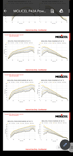

I’ve come across this, and it looks like momentarily the Molicell p42a could support up to 250w for one second, maybe around 200w for 3 seconds. If I said the pack would do 9000w, thats about 180w per cell. Lots of very different information around

Of course there is different info…for different uses of a cell.
I posted those Molicel graphs so it doesn’t contradict anything else that was said. :slightly_smiling_face:
Just about any really good high performance cell can put out a single 250W pulse for one second. It speeds up aging of the cell and you must let it cool down before doing that again but it can certainly be done. The cell is probably going to be at around 3V or lower when pulsed though.

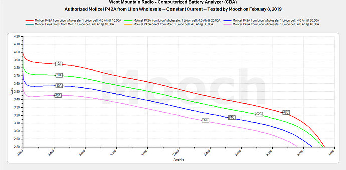

Just another bit of data…here’s a 40A discharge. The voltage drops instantly to about 3.5V (about 140W). That is a bare cell without any weld point, nickel, soldering point, wiring, or connector voltage drops. How all that adds up means we can’t even remotely call these 140W cells for esk8 use. Moli notes that you get shorter cycle life when used this hard too. Any cell can be abused to get more power. But we need to make sure it’s still useful power and not a standalone theoretical number.
I’m with you, I’m not looking to justify anything, just piecing info together about what’s possible. I’m only going to run the cells at 30a because of the voltage drop at 45a, and I’m not going to claim anything about the battery output.

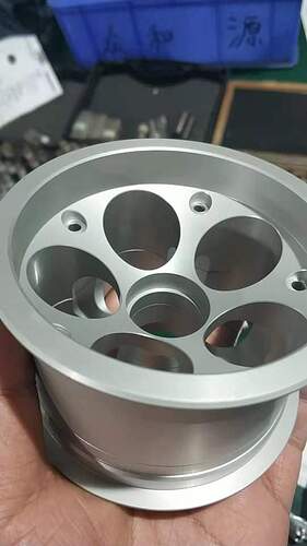

Prototype hubs on their way to me shortly, just clear anodised for these ones. What does everyone think about chrome plating? Possibly smoked chrome.
There will later be a small logo on one spoke either engraved or etched.
