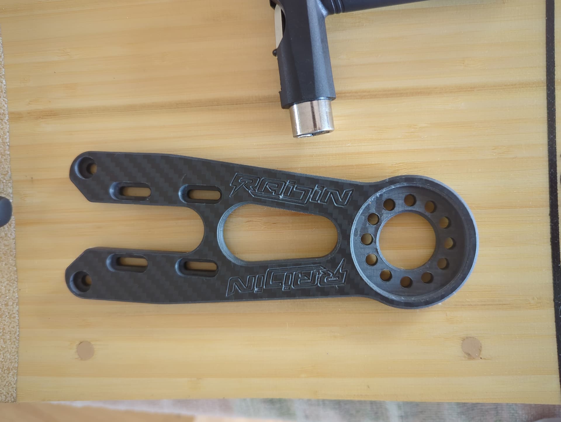

I had a feeling the long mounts and little motors were going to look weird out front but I didn’t take into account the split angle baseplates pointing them up higher in the air :neutral_face:

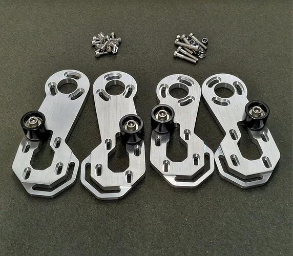

Not sure whether to redrill the motor mount holes in the trucks or just use a shorter set of flipsky mounts I have laying around and redrill those.
Fronts are as low as they’ll go and I had to bring the rears up as high as they will go to match.
Doesn’t look too bad. Any chance of pointing them inwards if you used the shorter flipsky ones?
Doesn’t need to match but getting them higher from the ground will reduce the amount of sand blasting that occurs on the motor cans haha.

The carbon mounts had a better orientation up front, still not 100 percent feeling the length though. But these are going to tie it up very nicely I’m thinking. 76mm front 92mm rear and customised slots to suit the front baseplate angle :ok_hand: thankyou Tom
