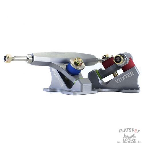

Look like Valkyrie trucks, if they feel like them too they should be amazing.
these are
split? kp
very different
@poastoast Pretty sure these are also split, none of the photos show a good side view but you can see the road side bushing not lining up
oh shit you right
i don’t see that in the step file, but it is simplified, so i guess that’d explain why the triangle bit is so big! got ha beans
yup you right, i see the 2 kingpins on the og pics too
Yeah similar offset bushing setup but interestingly for a different reason.
Valks started with that setup to have a “coplanar” bushing system meaning that instead of the usual 3-5mm gap between bushings on a normal truck, separating the bushings allows for a 0mm gap which based on my prototypes which have even had a negative offset where the bushing is sunken below the pivot centre, doesn’t offer much benefit.
The reason ours is offset is because we moved the board side bushing out to be relatively in line with the axles to offer more support, and then moved the road side bushing in for ground clearance with the lower rear truck angle.
In testing I discovered that having the board side bushing further out feels really good. You get a nice strong centre and really nice mid turn support.
The worst prototype I tested was #5 (left) which had both bushings moved in towards the pivot. This had a very weak centre and mid turn felt very twitchy and unsteady despite an effective slop stopper support pin.
Prototype #4 (right) which had too strong of a centre and was too expensive.
