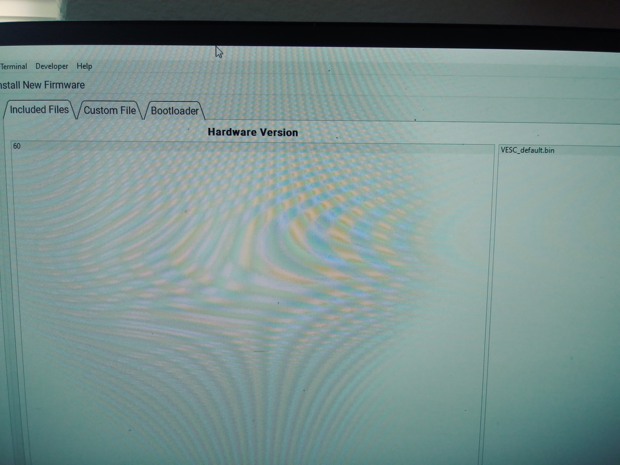

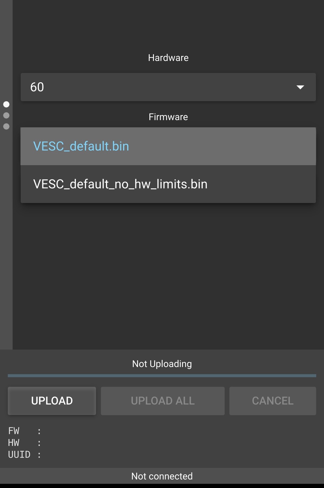

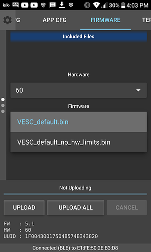

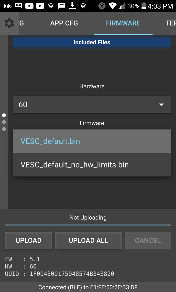

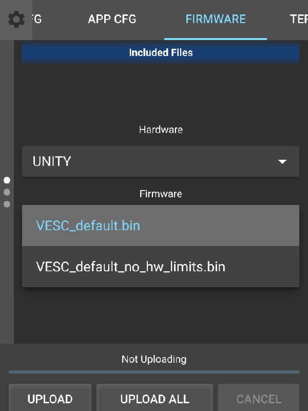

When flashing there’s a selection in one of the listboxes. Same FW, but a different BIN.
I know I’ve seen it before, but I just flashed FW5.01 yesterday and didn’t see the No Limits bin for HW6
so there is that…
Edit:
I just looked again… nope… not there
Weird… It’s there in the HW4 profile…
well I’ll be gawd damned… I just checked my mobile app and it’s there…
just rechecked the desktop and it’s not there…
fukkme

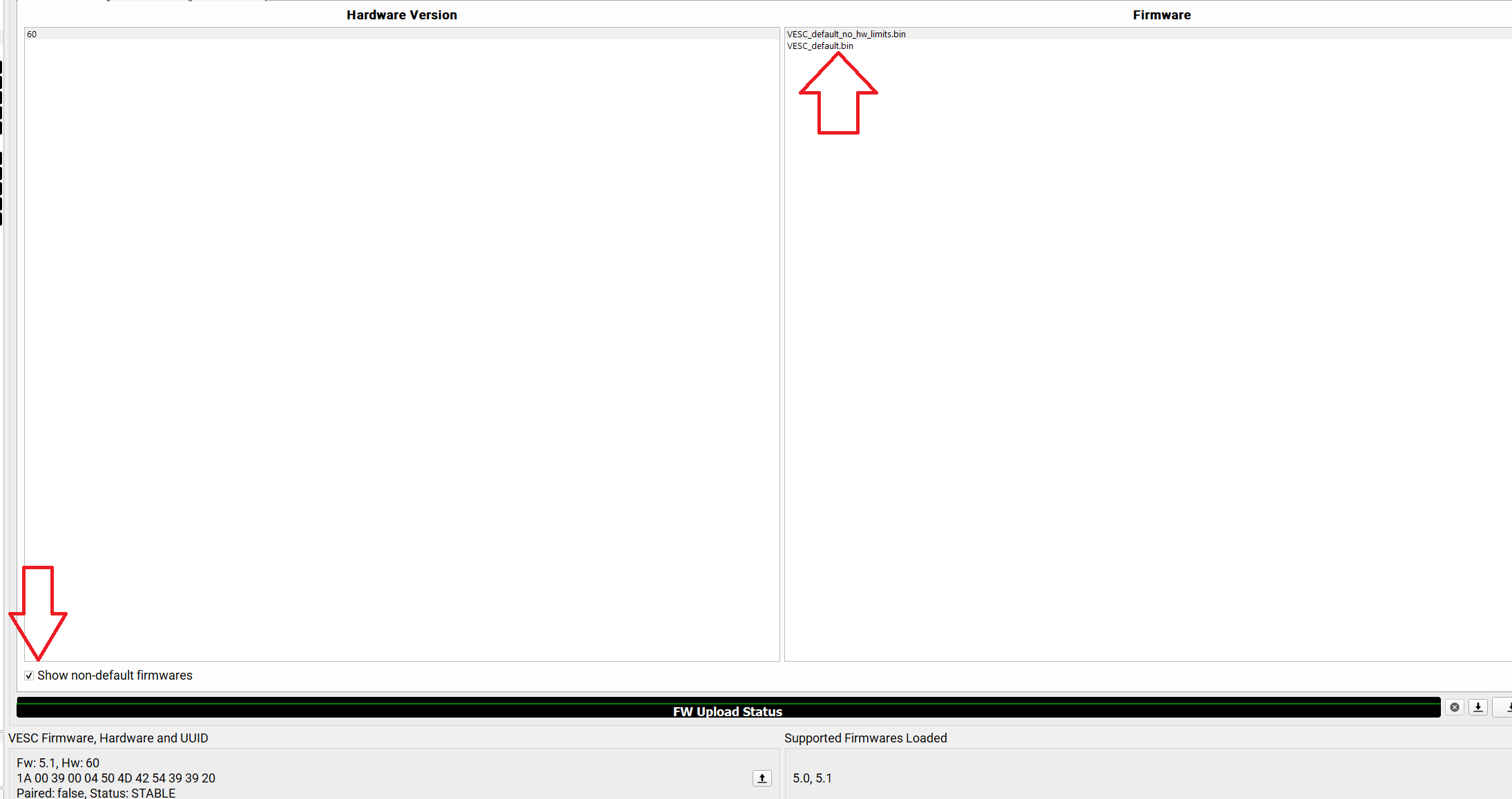

my dear, did you tick “show non-default firmwares”?
No honey I did not!
:heart_eyes: :heart_eyes: :heart_eyes:
:point_right:t4: :eggplant: :point_left:t4:
I so dislike the VESC user interface
:exploding_head: :dizzy_face: :exploding_head:
:cowboy_hat_face: :sunglasses: :cowboy_hat_face:
If k00k is happy, the day can only be good! :heart:
the mobile version is the worst.
BTW… @xsynatic solved this… I just checked… follow :unicorn: his lead the no-hardware limits option is indeed in the non-default firmware tab on the desktop app…
