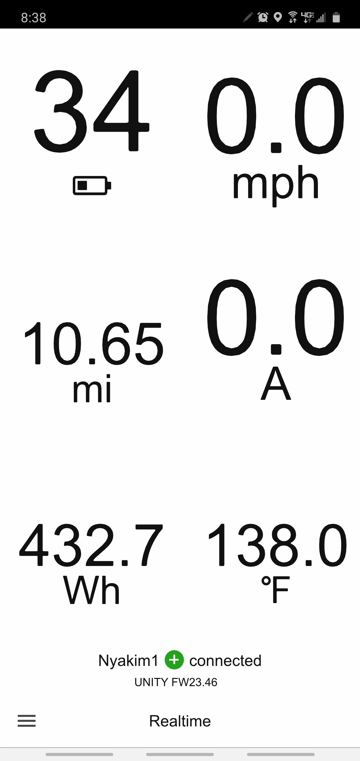

Today metr just stopped recording my trip at 4.4mi :cry: :smile: ah well here’s the start of the ride.
range and the oops.
I was trying to take a long bike trail so I could push my range without stops so I didn’t really stop to figure out why metr wasn’t connected. so just fall back to using xmatic which was also tracking. (it’s connected to hm-10 on second vesc) I decided to head 8 miles down to el porto and back.
I ran out of juice at 14.4 miles… “WTH??” I’m thinking. “I should at least get 15 or 16?”
Then I checked xmatic settings. damn. it still thought I was using a 16T pulley. instead of the 20T pulley … so 80% off. I actually got 18 miles. … and that is the extent of what I can squeeze out of that 10s5p 20700b 756wh pack. ( xmatic reports 540wh used at 30v. )
