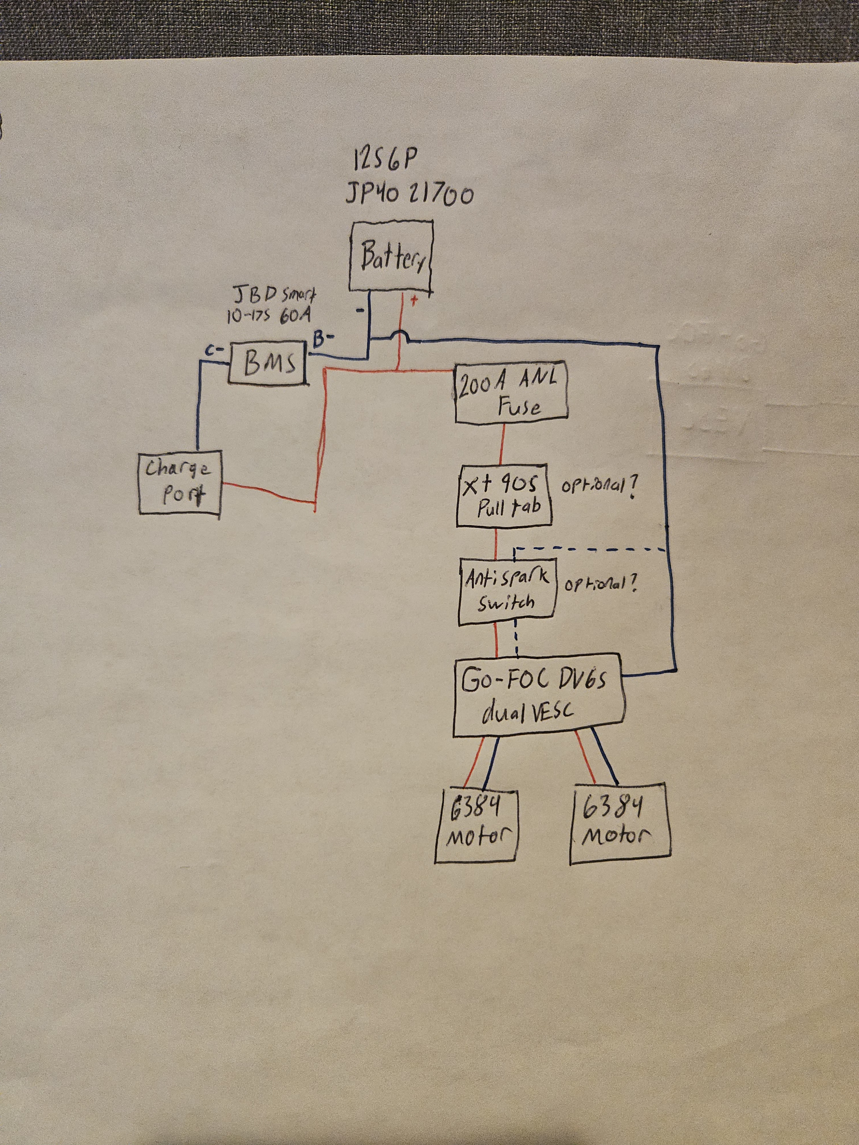

I am about to start building my first electric mountain board and want to make sure I understand what I’m doing before I spend a lot of money on battery cells and a battery welder. I have a pretty good grasp on the mechanical side of things but want to double check my electrical stuff before I start. Overall I’m running dual 6384 190kv motors, a Go-FOC DGV6s VESC, a JBD 60A 10s-17s Li-ion BMS (Wiring to be charge only), and building a 12s6p battery out of Ampace JP40 21700 cells. I plan on getting a AWithZ P20B 14.6 kW Spot Welder, and welding 0.2mm copper (both of which and cells I will get from DIY500amp). Any suggestions on things I should change before I go all in? rough wiring diagram drawn below.

Fuse the charge port.
Here is another diagram for reference

You don’t need a separate antispark switch. The DV6s has an antispark switch built in. It should have come with a power button and instructions where to plug that button in (and the proper vesc settings to enable that button).
Having the XT90 loop key is up to you. If you plan to use the DV6s power button, then the loop key would pretty much just be a safety/backup disconnect. Most people don’t bother with loop keys these days, but some people still advocate for them. Doesn’t really hurt to have it if you see a use.
If you want to use a fuse, that’s certainly a decision you can make. Use the search box on the forum if you want to read thousands of words of heated debate about the pros and cons of fusing your main battery connection. But all that aside, if you plan to use a 200A ANL fuse you might as well not bother. That’s never gonna blow, even if your ESC is violently combusting and melting itself into a puddle. Take a look at the fusing curve graph on the datasheet of the fuse you plan to use.
Personally I’d recommend getting 0.2mm pure nickel (NOT nickel plated steel) instead of copper. Welding copper properly is challenging. Particularly for your first battery build, nickel is much easier to get solid welds. And it’s going to be able to handle plenty of current for your battery and ESC specs.

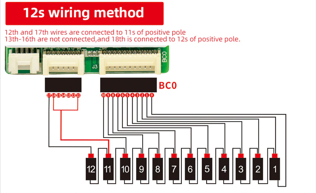

Assuming you are using the SP17S005 bms model, here is the exact wiring diagram for 12s:
Link for reference: Jiabaida SP17S005 Smart BMS 10S-17S Wiring Diagram – Jiabaida BMS
