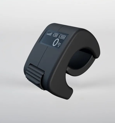

That “made in Germany” JayKay Ring Remote is pretty dope imho. Very stealthy also. But I think it only works with the JayKay trucks.
Aren’t most direct drives a bit wide for pushing? Seems like I’d constantly hit my foot on the back wheel
It doesn’t work period.
What battery would you fit in it?
Mini remotes have the smallest battery I know of in a remote, and it would easily exceed the size restraints once you factor in the screen and actual mechanical bits of the thumb wheel.
Jaykay is vaporware. I’m so much more convinced of it the more I look into it.
I’m not directing this part at you in particular, Benjo, but how are people so easily convinced by a shit tier render of a product with a obviously ‘compromised’ form factor, with specs that are supposed to be comparable to meepos or other shit tier china boards, when in reality are completely blown out of proportion?
I really can’t understand how people believe this.
