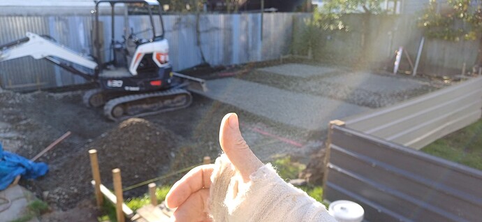

Being injured is having its perks. I’m starting to get better with freecad. I’ve drawn the same incomplete mount multiple times but am using more efficient methods each time so finally feel optimistic about learning this stuff, now there’s no physical jobs to be distracted by.
Had a mate show me kiCAD this week too. He develops new components for Amiga computers as a side hustle, in between being sent overseas to fix radio networks. I can see potential to design battery header boards reasonably effectively and affordably when time and interests allow, kiCAD is reasonablly straight forward.
Garage foundations start tomorrow, I’ll try get a photo of my hole being filled in soon.
Make sure your zipper is up before pressing play :astonished:
Too high a risk, if I crack a fat one this very minute it’s gonna blast a hole through my laptop touchpad.
Hole filling!!!

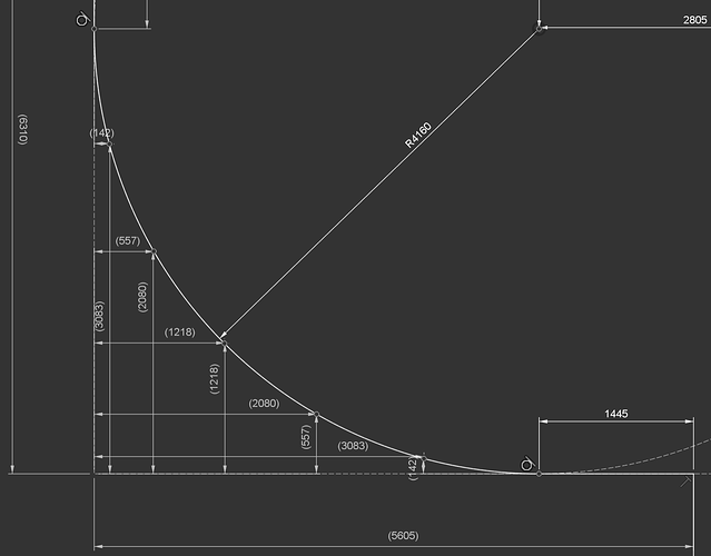

I’m excited to get in on the hole action! Mine isn’t a hole yet but it will be tomorrow! Kinda proud of this one cos i got to use some of my nerd skillz at werk…
We need to dig a footing for this curved retaining wall. Curves can be a little tricky in construction, but with good set-out and good tradesmen, its usually not a big deal…
For this job we had no set-out except for the boundaries and the builder and architect expected us to work out the location of this wall using the center of a tree as a radius point :woozy_face: just to add insult to injury, the base of said tree is over 1.5m higher than the cut level we are working from :face_with_symbols_over_mouth:
I used the dimensions given on the plans and gave myself a reference point outside of the radius (down on my cut level) so that I could measure back from it and mark several points along the radius and mark out my footing.
Very happy with what i’ve marked out, fingers crossed the machine operator doesn’t fuck it up!! :crossed_fingers:
Nice work, doing some maths. Wonder how many other builders would figure out the numbers…
Barely any in my experience. Most will either get the land surveyor to mark it out for them or just wing it and hope for the best :joy:
I’d say you’re right there. Before I started working solely with machinery, I worked as a sparky. I met very few other tradies who could even do trig to work out a triangle.
Years back when we had our sparky regs tests, which is open book, I worked with people who failed it five times consequatively. I was still half cut from the night before and got the highest equal mark in NZ that year, and being only an average student, still find this a little concerning.
Yeah they don’t make em like they used to!!
Back when i was doing carpentry there would rarely be a day that I didn’t pull a 3,4,5 for one reason or another.
My crews will do it for all of their setups to make sure the slabs are square and I’ll often check frames if they don’t seem to be sitting properly.
I found a frame that was considerably out of square on one job and it took me the best part of an hour trying to explain to the builder and the carpenter that the frame was out of square and the rectification works required were not our responsibility as a result. They literally argued against Pythagoras :joy:
I’m a geometry nerd, I don’t particularly like the maths side of it, but I really enjoy the way that different shapes interact. So today’s little CAD/on site flex was a fun one.
