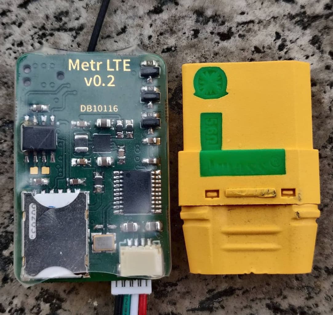

I know there Is some GPS tracker out there with GSM/LTE connection but it’s too BG a PCB for my use,
What I’? Looking for Is a GSM/LTE to a standard GPS module that would do the sale things for roughly the sale vole but It would be in two differenti pcbs and thatakes a big differenze for my use I can connect
Something like a metrLTE but smaller and without all the metre specific functions
this is not small enough?

So I’m trying to make something I can put on a cat collar without bothering her.
This is about 40x30 which is on the bigger size for a cat collar and I need to had a battery and some sort of protective casing somehow.
My thought was that If I can split it in say three different part (gps, gsm, battery) each one like a small pendant, it will be less bothersome for her than one big thing hanging from the collar
(I admit I thought it was bigger than what it looks on your picture)

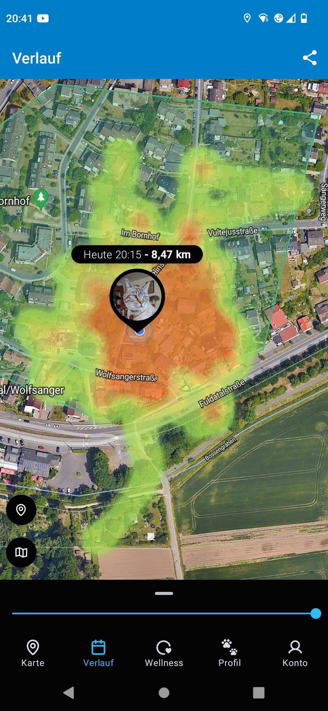

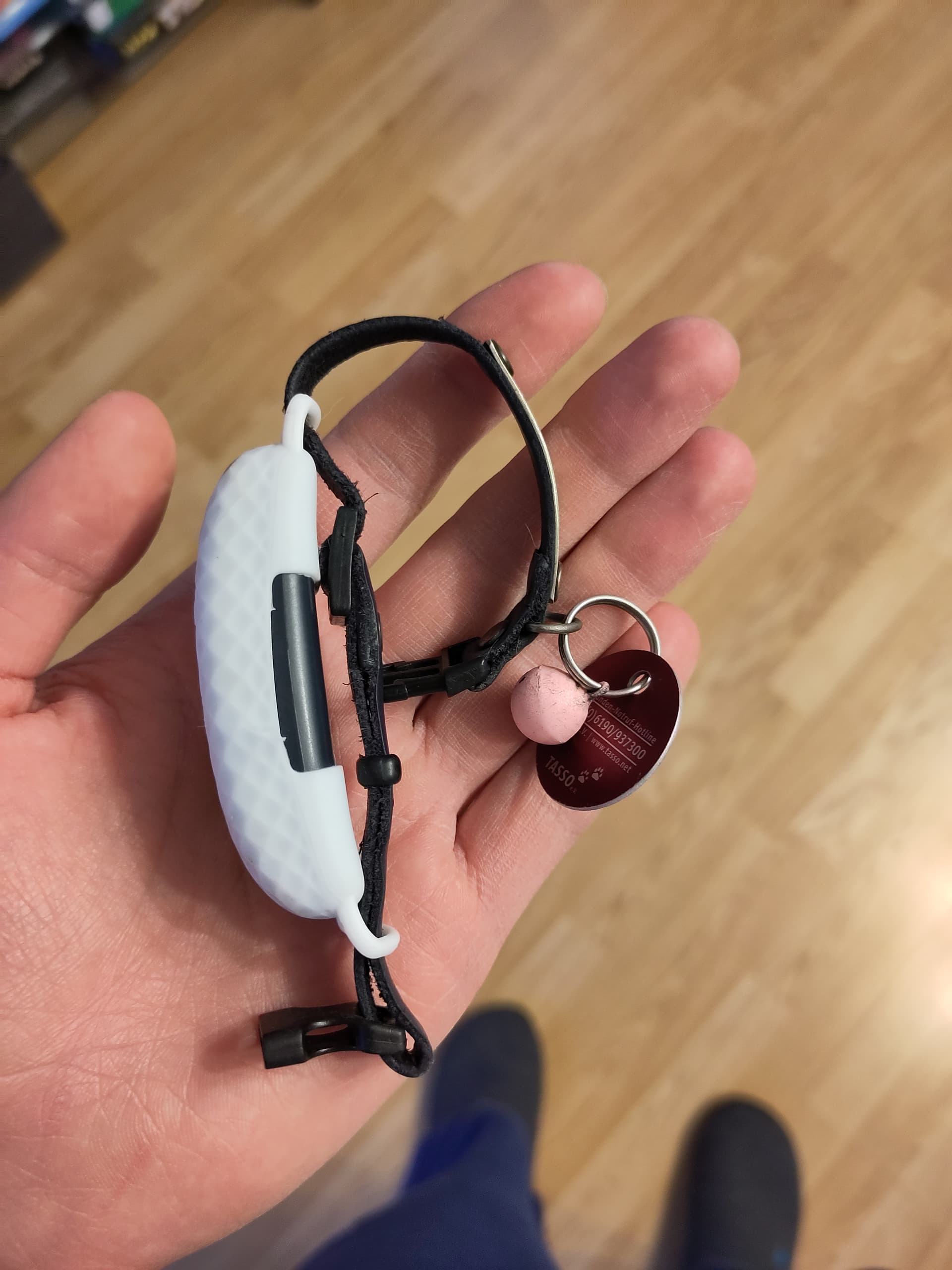

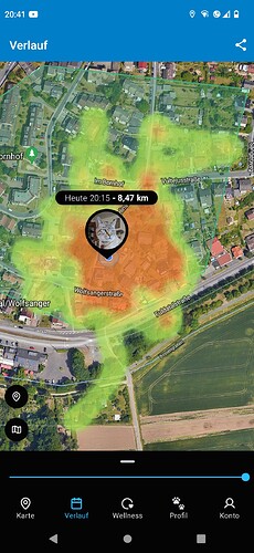

We got our cat a Tractive GPS tracker, works really well as long as there is service, so unlike a bluetooth tracker where someone with a compatible device has to be near it. Costs 12€/mo if you get the yearly plan. Bi-yearly is even cheaper I think. Its a bit bigger that an metr LTE , but the shape is really nice to fit on a collar / neck. Battery lasts for about a week for us. The app works on android and iphone, and there is also browser version.
Some pictures:
(She is wearing the tracker in all the pictures. Doesn’t bother her at all.)
You also get a heat map of where your cat likes to hang out:
The collar:
It’s a silicone holder, so the tabs at the end can stretch.
If your cat likes to crawl under things the connection can be a bit spotty, but otherwise it’s spot on. It also can produce sound and a flashing light, though the light is mostly a gimmick. The rest works fine.

Your idea with splitting the parts up is cool in theory, but making the stuff water tight is going to be a challenge. Also runtime will probably be shit, as this prebuilt tracker has a lot of energy saving features embedded, that are not existant on modules you can buy afaik.

This is a pretty densly packed unit, I doubt there are any of-the-shelf components in there. You also get a bluetooth ā€œradarā€ for example, that alone in ready-made components would be half the size of this tracker. I haven’t opened it so far though, I don’t want to compromised the water seals.
