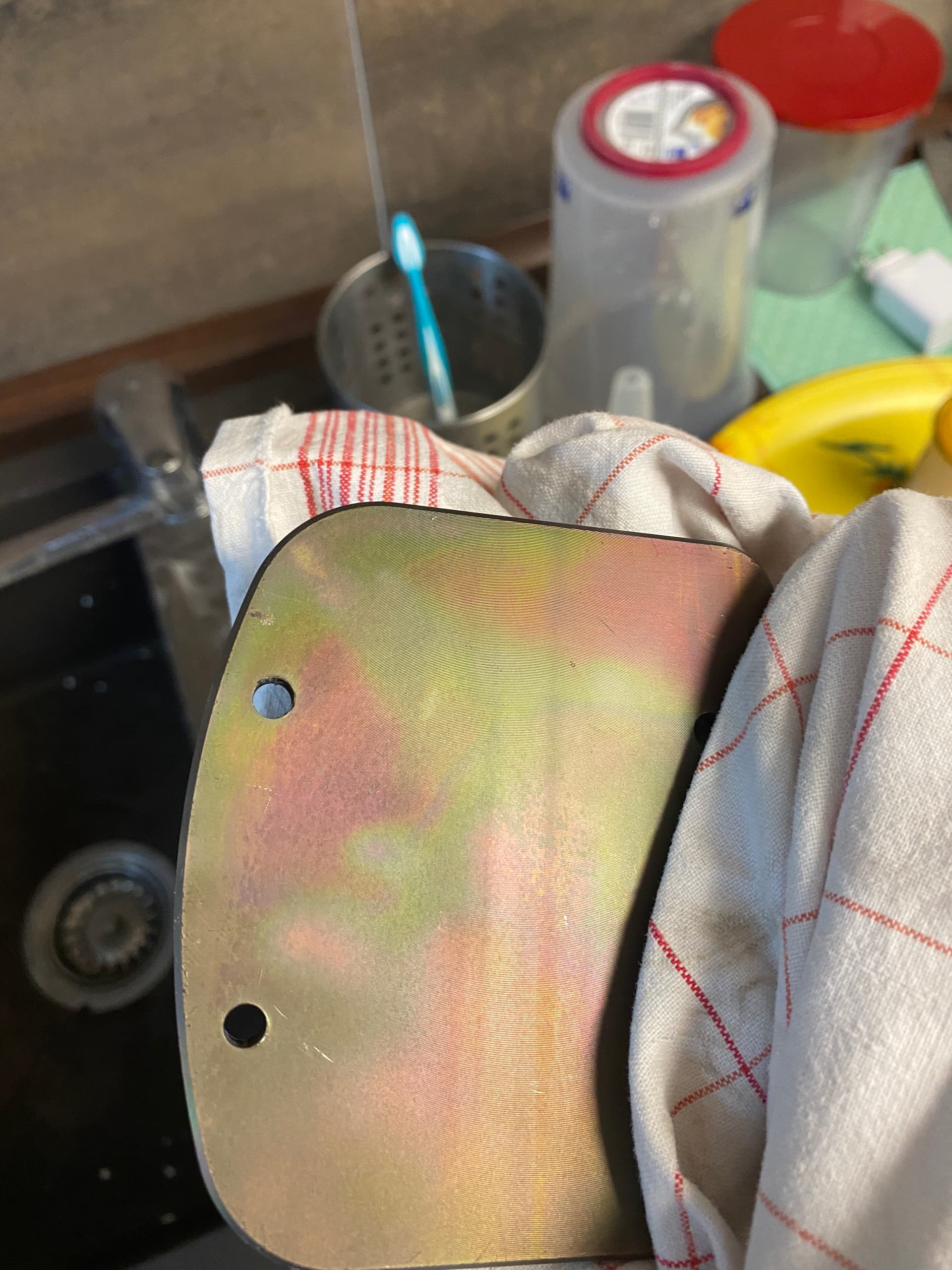

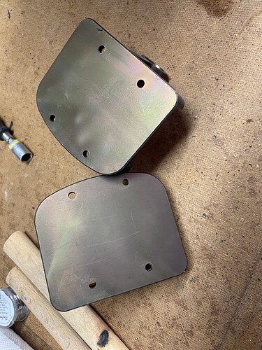

They looked so nice while in the elox bath!
I think that looks pretty tidy tbh! I expect it’ll look great when it’s all assembled.

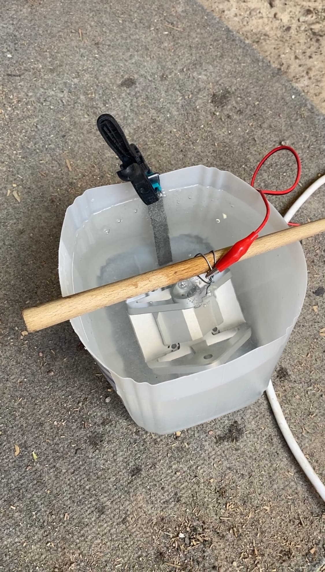

I’ve got no idea how you anodise (a specific colour). Can you elaborate a bit on the process?
Yeah, I’m mounting them as they are, they work quite well with my new color scheme.
Well, anodizing is creating a hard(ish) layer of Aluminium alloys which can also be colored.
When you have an already anodized piece you can remove the color by throwing it in pipe cleaner, dissolved in water.
Then a very thin and quite soft layer of Al-oxide gets created when the part is exposed to air.
You can anodize Aluminium pieces by putting them in sulfuric acid at around 15% concentration and then leading a current through the bath, I used 5A.
This creates the thicker layer.
Wash everything properly after anodizing but careful, the surface is very soft.
After this you can add the color by putting the piece in 60C hot water and the adding color, even water color if you like but that does not hold up well under uv light coming from the sun.
After coloring you have to seal the layer by cooking the pieces in water for an hour.
Tl&dr;: Pipe cleaner, demineralized water, (color bath at 60C), cooking.
This was my first attempt ever so I have no comparison, maybe the color comes from the alloy, maybe my cleaning bath wasn’t clean enough, who knows.
