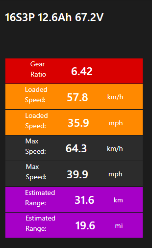

Yes I agree with you, higher KV higher gearing, but things like size and of drive train and erpm limit become a concern then
I’m not even hitting 90k erpm here. I don’t think it’ll be a problem for anything that’s 75/100. I do imagine this drivetrain will wear faster. In terms of size, I’m just using moon drives and flipsky 6384s, so not super large. This crazy setup I’m running is more of an experiment to see what’s possible more than anything.
I am curious to see how it goes. But yeah you not super pushing things here, what you got like 190kv and 1:5?
190kv and 6.42:1
