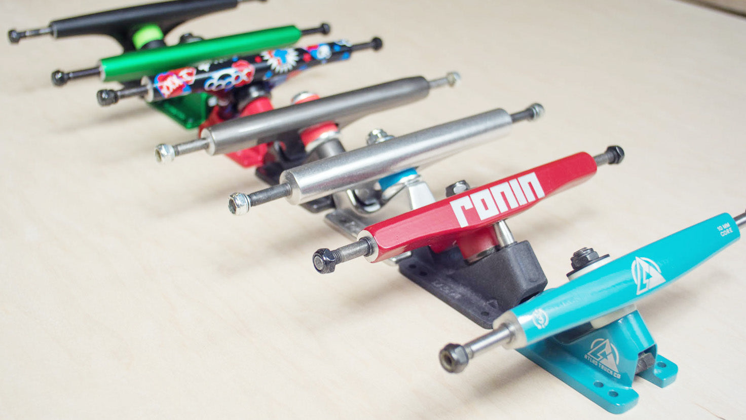

Why does is matter how far the axle is from the mounting holes if the force strain is the same?
you’re using ā€œwheelbaseā€ wrong
Closer to the center of the board = more wheelbite.
I’m talking about wheelbase. Tkp’s give you a longer effective wheelbase than rkp’s.
What are you talking about?
yeah looks like mounting is useless ._.
Longboarders have a different definition for wheelbase. It’s based on the deck mount holes, and not the axles like most vehicles.

No. Wheelbite comes from loose bushings and big wheels. Everything else that plays into it is way to variable. There are alot of boards that don’t care about rkp or tkp in space terms.
Lots of decks have serious wheelbite issues with RKP but not with DKP — the Rayne Demonseed is just one of many having this issue with >100mm wheels.
There’s plenty of boards out there with wheelbite issues for eskate.
If you want to run stiff trucks and small wheels, have fun with that.
ā€œWheelbase offsetā€ is a very real thing and can make or break a build plan. Not just wheelbite is affected by it, but motor to enclosure clearance for forward mounted and motor to tail clearance for rear mounted. Basically, rkp’s make either a bit harder to pull off without having your motors too close to the ground.
Item 2 in this article has some good information on it.
